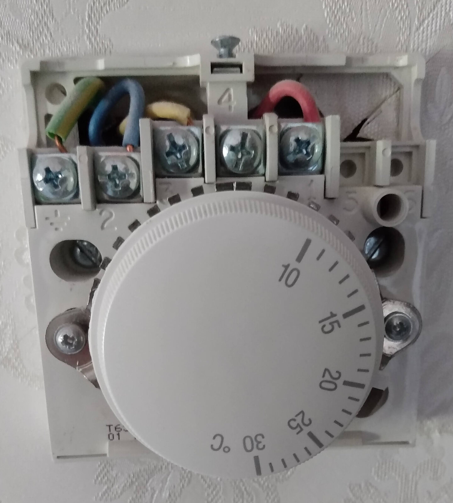

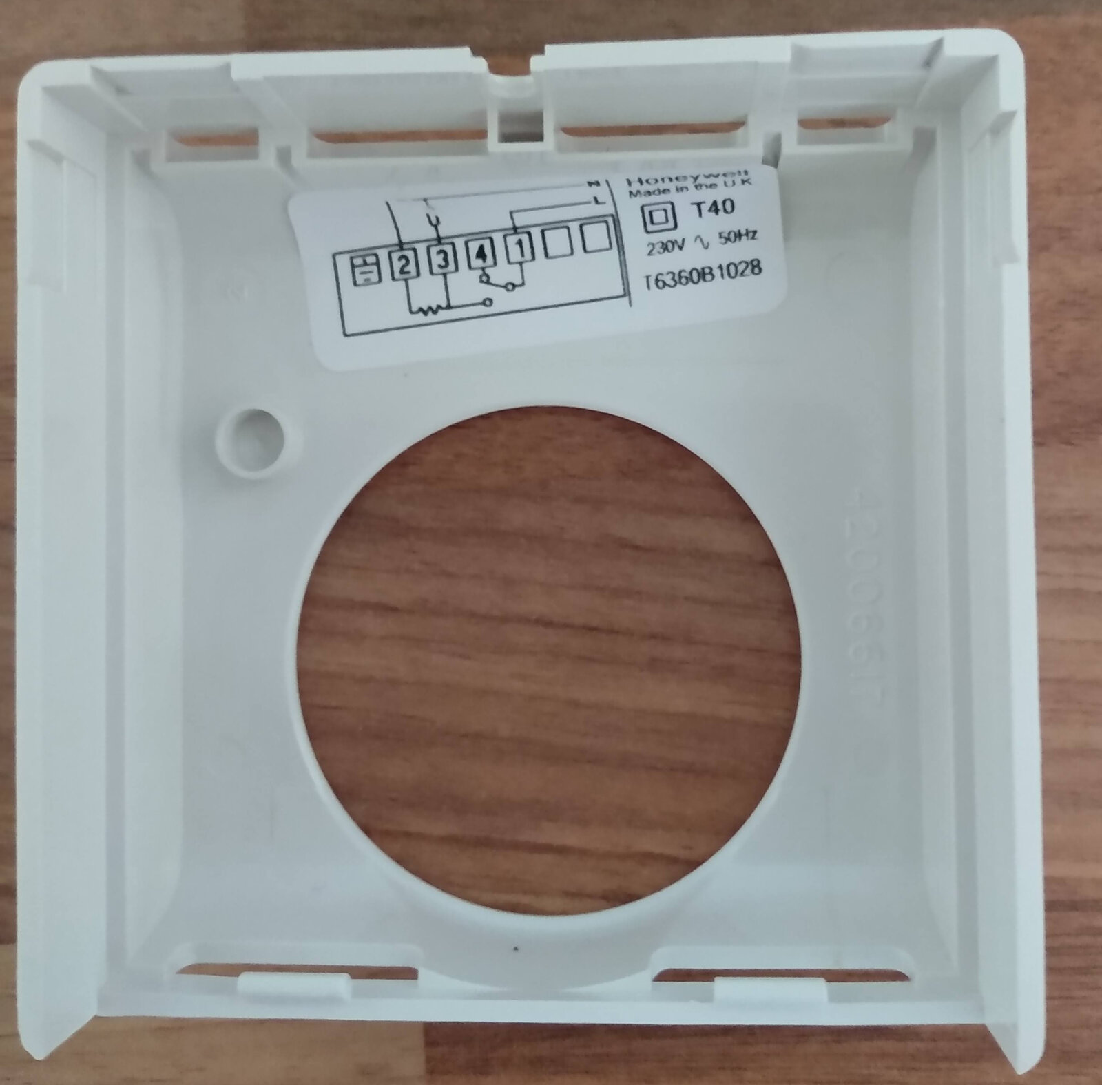

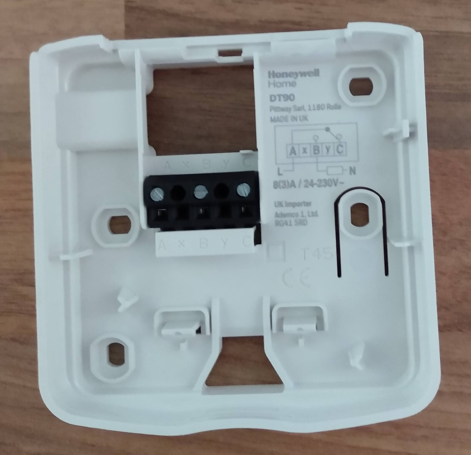

i would like some help with upgrading my old honeywell t40 room stat to the digital dt90e as there are 4 wires on the old stat and only 3 on the new one any help would be great,John
As the new stat is battery operated you don’t need the blue neutral wire so put it in a separate connector out the way. Same for the green earth. Then connect the red live to the A terminal and yellow switch wire to B. Job done.
