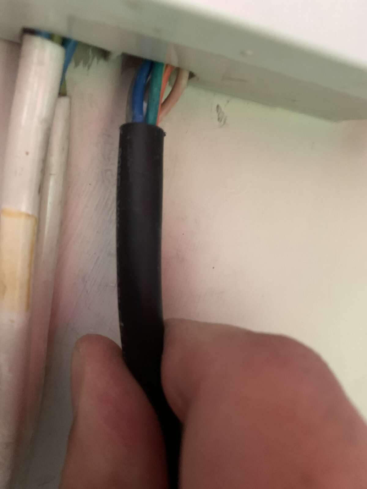

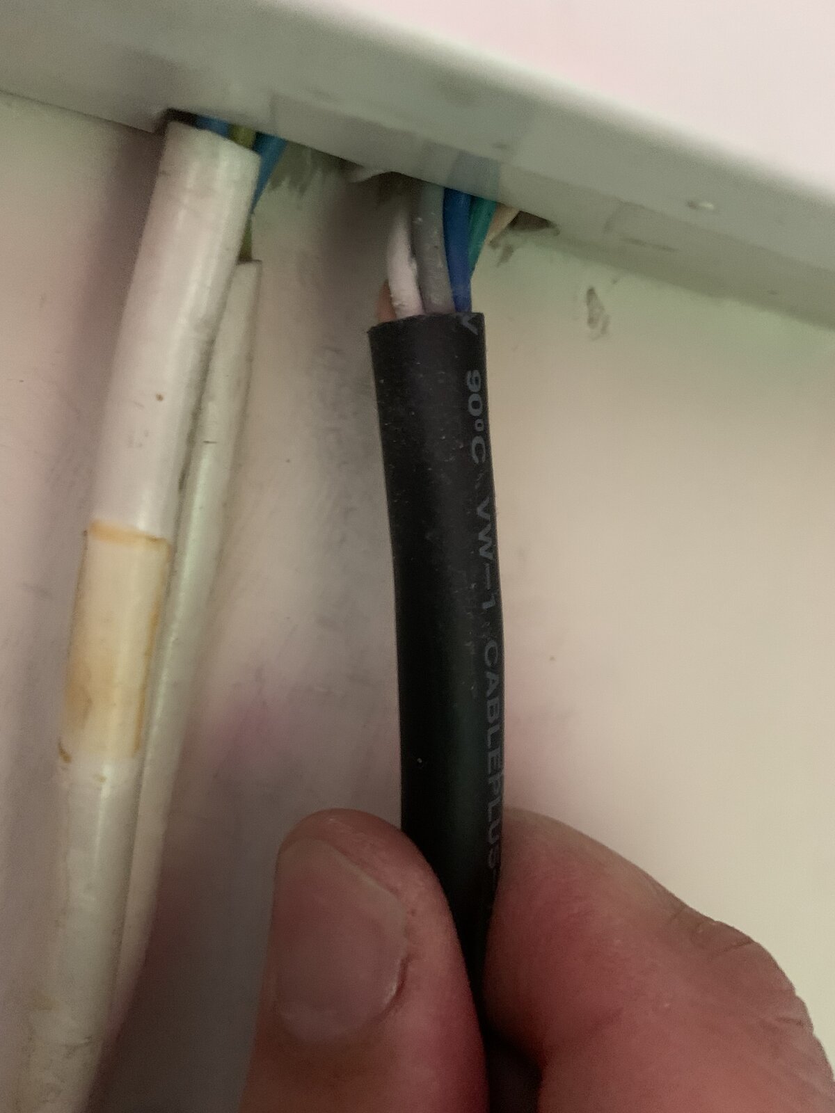

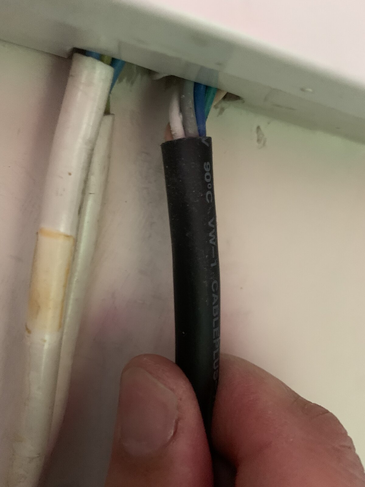

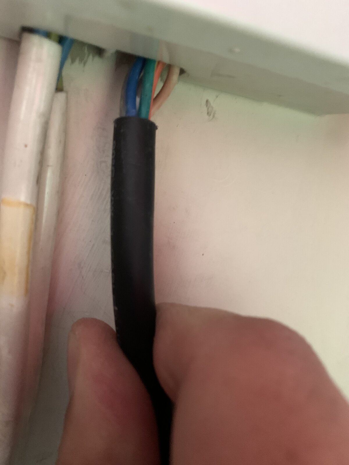

At the motorised valve I have attached some pictures of the wires going in

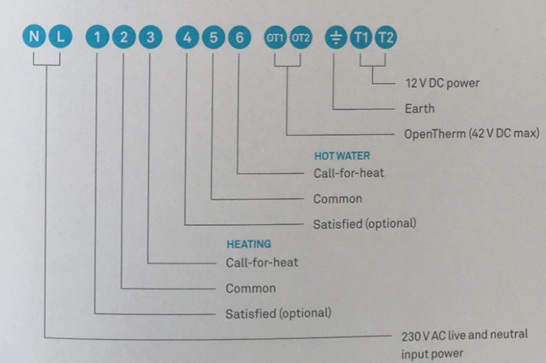

The wires go to the terminals that have the same function.
N=N
L = L
1 HW Off =4 Hot Water Satisfied
3 HW On =6 Hot Water Call for Heat
4 CH On = 3 Heating Call for Heat
As you have figured, Nest terminals L, 2 and 5 should be connected together.
The Nest Thermostat is connected to T1 and T2
I don't see an earth connection at the existing programmer, although if it's mounted above a metal box it may be connected to that.
The existing room thermostat should either be set to its maximum setting to prevent it interfering with the Nest, or decommissioned by removing it and making a wiring modification to close the circuit that its removal will have left open.

I can’t use the T1 / t2 as the cable we thought we could use isn’t what it was
There’s two yellows into a terminal block and a red wire and a switch grey cable going the the boiler
The red becomes live when the CH is ON my guess is there is a need for alteration to the wiring in the wiring box before I can use them?
