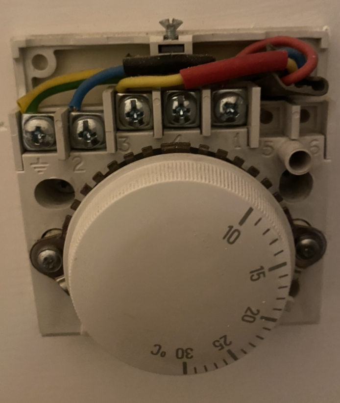

The blue cable on the connector block as got a red sleeve (same as the yellow cable).
My question is how the T40 thermostat is working:
The link is between the the live and the switch live and every time the wheel is turned it opens and close the contact. So I’m this instance what the blue cable is doing? Will the T40 work without the blue cable? If it still work can I use the blue cable as neutral?

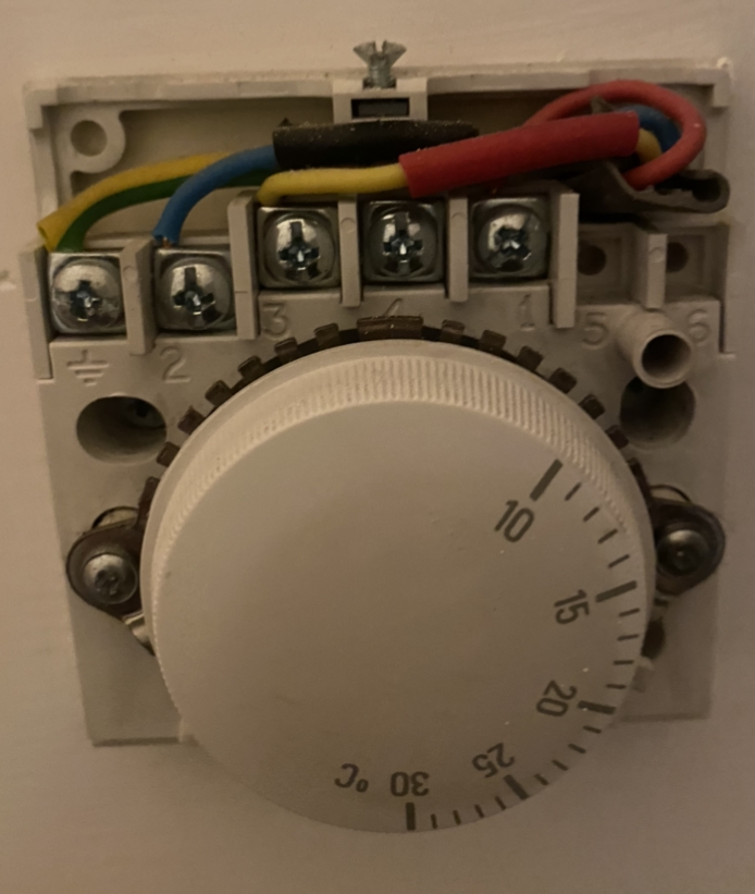

Looking at that you appear to have an s plan system (x2 2-port valves) do you have a hot water cylinder? Please post a photo of thermostat end as well, that’s the junction box/wiring centre.
Yes, I have a hot water cylinder as well.
Ok, not sure that’s a T40, but looks like a T6360 (might have had number changes). If wired correctly 1 is live in, 2 is neutral and yellow (sleeved red) is switched live. On your Moes Go (if that’s what it is) will need to be wired up where the wires are in 1st photo provided. You need to trace which wire is live (assuming red if correct) to go to Live on Live on WiFi stat, pick up a neutral or use the assumed neutral, take a link between the live on wifi and normally closed, use switched live on normally open.

I have tried but it is not working, when I test voltage between live and neutral (at the thermostat) I have only 20v, this is why I believe I don’t have neutral.
Do you know what is the purpose of the neutral cable at the Honeywell thermostat?
Will the thermostat work with just live and Switchlive?

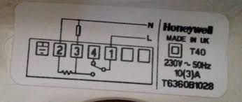

The neutral is there to heat up an anticipator, to stop wide temperature swings. It will work without a neutral, but bigger temp swings. It could be wired up wrong, as in back to front.

I always call this thermostat a T6360, but sometimes it does get referred to as a T40. The diagram inside the lid might give a clue as to why both terms are used.
