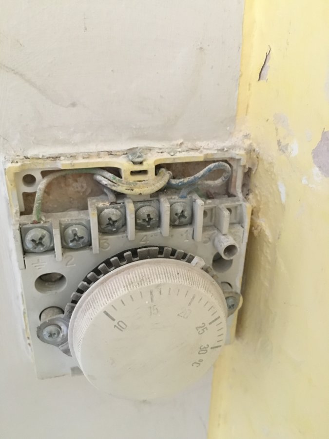

Hello guys,
I'm currently in the middle of refurbishment work and would like to replace my old Honeywell T6360B with something more decent if possible (ideal Nest but not too sure if compatible with my boiler)
It seems to be only 3 wires are connected (see attached photo):
blue wire - connected to terminal #1
brown wire - connected to terminal #3
green/yellow wire - connected to earth terminal
What is the best thermostat I could go for which will provide me with more functionality than the old one?

Ok, I did some more research and it looks like I have been looking at US website which was saying Nest isn't compatible with my system.
Here in UK I need to use Heat Link which is provided with thermostat.
I need to run new 3-core cable from Heat Link to junction box (if I have one) or directly to the boiler. Brown (N) and Blue (L) wires have to be connected to the same terminal where power is delivered to the boiler form mains, then call-for-heat (where the old brown cable is connected - look at the photo terminal #1) from the boiler has to be connected to terminal #3 on Heat Link.
I can disconnect all the wires from the boiler which are currently connected to my old Honeywell T6360B and use them (2 wires) to deliver 12V power to the Thermostat (brown T1 and blue T2) and that should work...

I'm still bit confused with my current thermostat as it looks like brown wire connected to terminal #3 is always live and blue wire connected to terminal #1 is live only when "call-for-heat"?
Is that correct?
Yes.

I haven't got a programmer, it is just a combi boiler (I think it's Vaillant or something similar) which is responsible for my hot water and heating (no big tank like in old houses).
