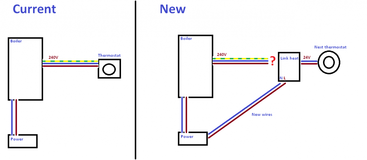

Ok so I have created very simple diagram and was wondering is I could re-use the existing cables which are currently connected to my old thermostat and get them connected to the Heat Link or perhaps I would need a plumber to open my boiler and connect wires to a new boiler terminals?

You've just destroyed your stat with both of those examples. Nest HU is 12V.
The boiler needs to be opened up and the whole thing can be fitted, wired up and set up in 45 minutes to an hour tops. As said before we can't and won't give advice regarding removing an integral part of the boilers safety.

Jon what do you mean I have destroyed my stat with both examples....?
The "Current" diagram is showing how it is connected right now and it's working fine.
The "New" diagram is showing how I was thinking to get this connected (Ok the US version is 24V english is 12 V but this is supplied by Heat Link so it not down to me) but I was't sure if I could reuse the current wires which are going to the boiler. I know one is live and I wouldn't be connecting this one anywhere in my new stat but what about switched-live, could I re-use this one by connecting to the Heat-Link terminal #3?
What voltages are you getting to the current stat?
Where do the current stat wires terminate?
Do you have an existing programmer?
Do you want rid of this?
Where do you want the Heatlink?
What cables are you hoping to conceal so that it is aesthetically pleasing?
You have provided no information regarding your install to be of any use until 32 posts in and we know your boiler. This is a DIY site and it is more a hand holding site to help you with your DIY projects. We aren't here to guide you through all the intricacies of an install. As it's DIY there needs to be some input from your side. You tried with the previous diagrams but they are wrong. Existing stat wires can be used depending on some of the above answers but they will al pretty much end up with the case needing to be off.
Put up some other diagrams up and see where you get. HINT: Don't try and over think things it's not that hard even for us cowboys.

Don't talk daft. Perhaps if you're a clueless plumber you'll need to take the boiler in bits to spin the job out and make it look much harder than it really is, but I assure you it's not necessary. You've already got a switching pair coming from the boiler. That's all you need.
