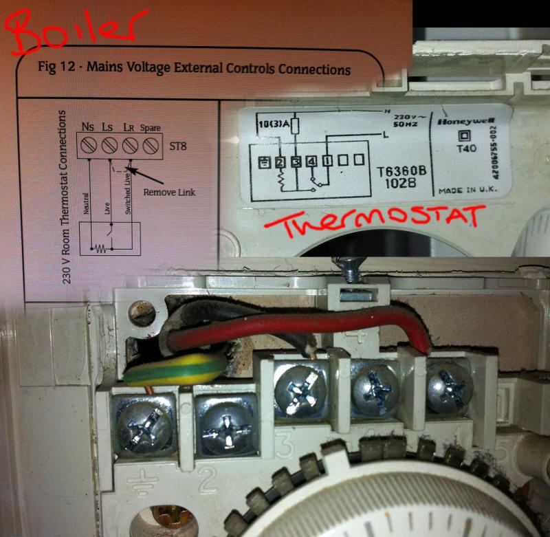

I'm looking to upgrade a Honeywell thermostat with a fancy wifi one... I must say that I'm a little baffled by the wiring on the Honeywell as there only appears to be 2 wires as well as earth... the Heatmiser PRT wifi's state that they need 3 wires as well as earth...
I've included pictures here of what my current wiring looks like... How is this thermostat talking to the combi-boiler? Is there a hidden wire connected to pin 4 that I can't see?
Thanks in advance for any help and advice!

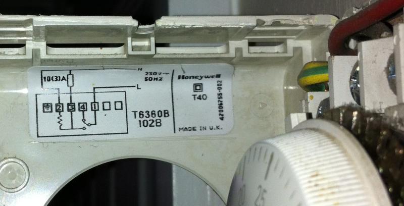

Had a look at the manual and see that it has a 'heat anticipator' and 'RFI supressor'.
I presume that it is just a mechanical thermostat and without the neutral (terminal 2) these features do not work.

Anyhoo, im still baffield by the wiring in my current setup... It looks like I have mains cable? Earth+L+N?
I dont understand how it talks to the boiler...
Another point to consider is that the wiring may not be 240V.
It could be Extra Low Voltage (24V) and just connecting two terminals on the boiler circuitry.
No. It's just live (240 or 24V) and switched live.
Just because it's black doesn't mean it's neutral, it's not.
It's just a switch which connects two terminals.

Oh right, I see all these wires come from the boiler... switching off the boiler also cuts the power to the thermostat.

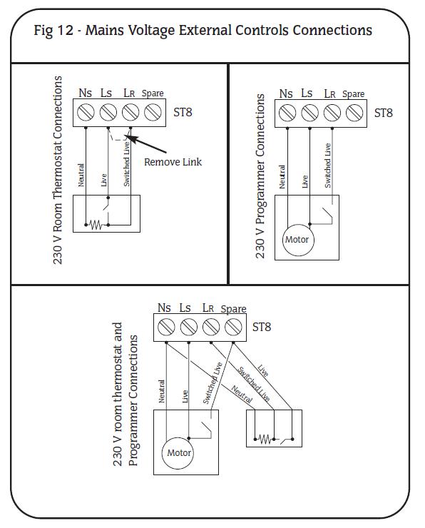

According to the boiler wiring diagram, I have Live, Neutral and Switched live... The neutral is wired into the earth socket on the Honeywell.

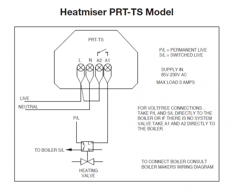

Chaps, finally managed to find the manual for the Heatmiser PRT... As far as I can tell the 3 wires I have are enough?
The heatmiser has "volt free contacts", which is just a fancy way of saying that it has a relay in it... Running a wire link from L to A2 like in the diagram and then connecting the Switched Live to A1 achieves what I need, does it not? From the heatmiser website :
"Our digital thermostats have volt free contacts and this means that we can switch anything from 12-240v. If you have three wires (not including earth) then you are switching 240v and the connection will therefore be live and neutral to power our thermostat and a third being the switch wire to the appliance. We call this "mains switching""
Heatmiser PRT-TS diagram
My boiler diagram (Worcester Bosch 35CDi)
No.
Your earth conductor in your twin and earth cable must be used for earth and earth only. You have the earth in the stats earth terminal, the red in the stats live terminal and the black in the stats 'call' terminal. You don't have any neutral connection. Your terminal 2 in the old stat should have a neutral connected (it wont be particularly accurate with out it).
Your current stat should really have a three core and earth cable to it, and your PRT stat would require this too. The relay output would be linked to the live supply to provide a sw live out, requiring just three cores PLUS earth.
As I said before too, the PRT stat needs a 35mm box to be flushed into the wall.
