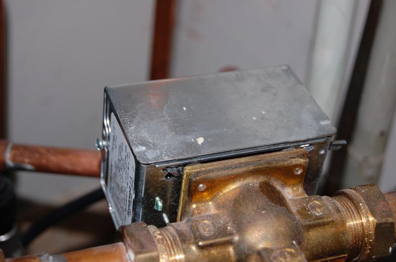

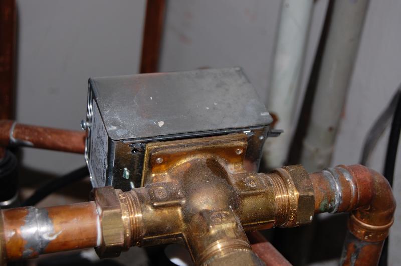

Good Morning, I have a ticking V4073 3-port motorised valve.
When the HW is on, with CH off, the Valve will tick and the rads warm up, with the CH on there seems to be no appartent problem, either with CH on it's own or at the same time as the HW. I would welcome any ideas as to the problem.
Mark
Micro switch is stuck, buy a new actuator, provided the old one has a dimple on the case.
Perhaps a photo of the valve.
