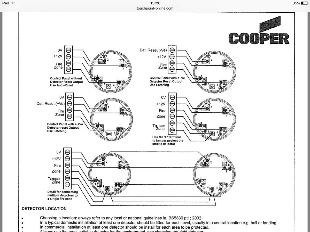

I have a problem with a Honywell GD 48, and I m not sure if the connections for a 4 wire smoke detector are the right ones.
I read on the internet that 2 wire smoke detectors are not compatibile with this panel.
So I whant to wire 4 smoke detectors like this: The + and - from detectors to an output on the panel that will be declared as SWITCH DC output, and the other 2 wires on a zone that will be declared as FIRE zone. This zone will be a EOL 1K zone (opotion 2). I must wire the detectors in parallel and NO.
Please tell me if I m wrong?
Thank you
Normally closed

So I was not very far from the correct connecrtions.:D
Wouldn't wiring in parallel be a bad idea. i.e. 4 detectors wired in parallel on a single zone and you wont know which detector has activated and therefore where the fire is. Not to mention and faults on a single detector etc... If you have the room wire each detector on its own dedicated zone and if not then think about adding a RIO for this.
FYI I have the M12 smoke detectors wired up to my GD96
You are right, it is more helpful if you have each detector on a single zone.
For me its very simple to connect the 4 det. on a single zone because the 4 det. are going to be mounted in one room divided in two by a courtain.

So my zone will be a fire zone, and the output to power the smoke detector will be......? knowing that after a fire alarm the detector needs to be reset (power down for a few seconds).
I tryed with SWITC DC and FIRE outputs, it works both. The switch dc was linked (software not physicaly) to the fire zone.
It is ok?
I thought the M12 do not need to be powered down if you don't set them to latch. Use AUX power to power them like any other sensor/detector.
I use appolo smoke detectors with orbis-rb-10004 apo base. The base contains a relay NO/NC. After a fire alarm the detector must be powered down to become functional again.
I dont think I realy understood ”if you don't set them to latch”. If I set an output to latch, it means that it remains active until I enter a valid cod.
I set the zone to fire, so is most like a 24 hours zone, it will trigger an alarm even the system is unset. Once in alarm the zone become opened. To close the zone the detector needs to be powered down. I tested the smoke detector with a 12V battery a multimeter and a cigarette :D to run the detector in alarm.
Ah ok, I was basing my info on the second post image that shows the Cooper Menvier M12, I'm not versed in the appolo 12v range. So ignore my comment about the latching :D
