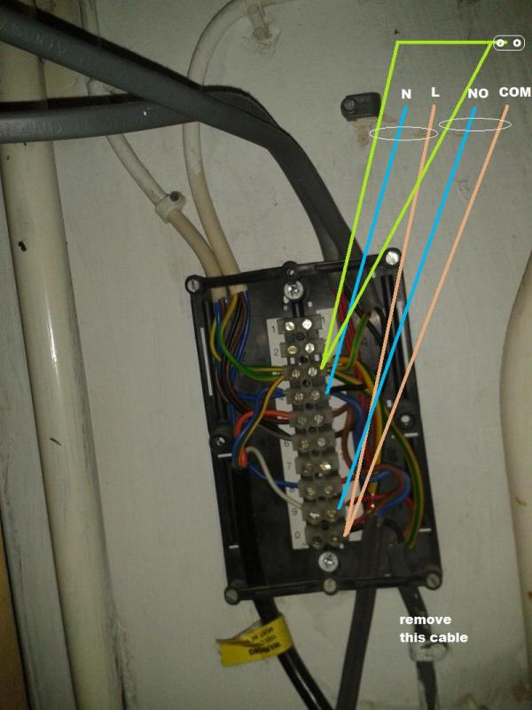

Horstmann RFT1 Thermostat.(as i can tell you guys love them)
Only 2 power wires are entering the loom bottom both greys.
1 is the old thermo
Yes.
and teh other the pwoer supply.
This is a 3 core Red ,Black ,Earth
No it isn't.
It's Brown, Blue & E. Where does this cable come from?
This what I originally thought was power supply but it should not be connected to the orange from the motorised valve and two other wires.
This must be a switched live.
Which meets top right grey a 2 core
Black and Earth at Number 5 on the loom.
Seeeing as that is the only Power Supply i can see coming in may i be right in saying that the wire from the old Programmer at 5 is the constant live and the other wire from old control
3 core 2x red and Black would be the calling wire
I'm not sure. It seems to be wired 'unusually.
It doesn't matter anyway if everything works as it should.
You merely have to identify a permanent live or a live calling for CH from the existing programmer to power the new receiver.

Could i just clarify these actions one last time as im missing an E and Live question below Please realy not attempting it unless clear headed on the activity and will now be done tomorrow in daylight. :)
I have a 3 core Blue Brown Earth cable , which i think needs to be in 2 pieces
Piece 1
Old Black in loom is now Blue Neutral and will connect from loom to "NO"
Green and Yellow Earth will go in the Earth loom point BUT there is no E on the new reciever?.
Old Red now Blue to Com
Piece 2
Neutral Blue is 4 on the loom to N on the reciever
Earth Green and yellow in 3 in the loom (but where on Receiver?) i only have one left its NC ....Normaly Closed
Calling Wire to the Live( 230V feed) on Reciever ...do i run the Live Brown wire from the new 3 core off the loom do i take out the calling wire and attach it to the reciever ( if i dont use the 3 core brown then it will be left unused?)
After more study of the pictures it would appear that you will also need a signal to tell the motorised valve that the central heating is not required, i.e. from NC to terminal 6.
EFL That photo is brilliant thank you so much! i have the wires all in thier places so easy with the photo! 2 ends that i have left are the top right Earths what is it those are attached to? as theres no earth in the Plastic wall box that the Thermo sits in like you may find in a wall socket.

Hi EFL
I have done as you advised in the last graph, I'm just checking back in before I test it, as its rely packed out in the Wire loom?
I've only removed the old Wall Thermo wire Black and Red at the bottom right corner.
There was no other to remove? is that right.
If so I'm now thinking pick up a better quality loom as its bursting at the seems and I'm not moving out of Back Boiler Status anytime soon.

Hi EFL
I've tried it and the wireless caller picks up the wireless control centre fine but when it kicks in it sounds like a switch clicking on and off ( I think i've heard one before may be a relay??)
Its going a kind of tick tock tick tock,.
The red light stays on so the control centre is fired up ok, but interestingly when this is going on the green light that would show its active and calling doesn't come on. It stays in the standby red status.
I have the old control unit on NO for hotwater and No for CH
(Please ignore the Hotwater on the CH system, I never use it and don't mind if its no longer available if illimination helps the situation)
