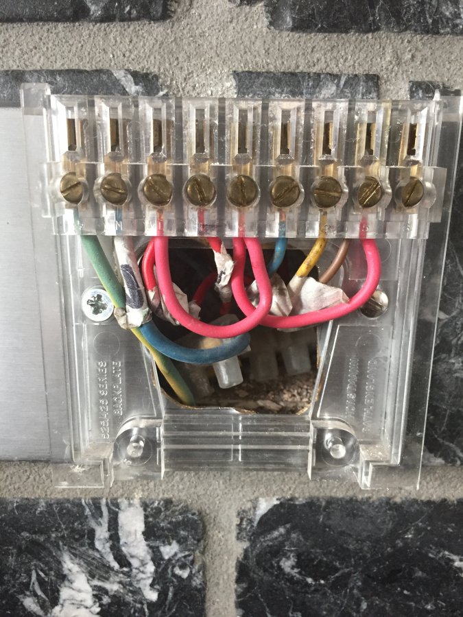

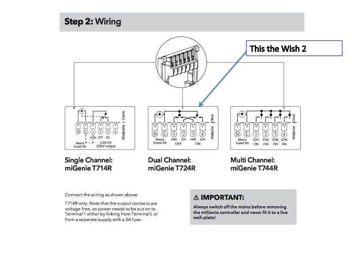

I currently have a Hortsmann Channel Plus H27XL programmer for HW & CH. I recently bought a Drayton MiGenie Wish 2 one (wireless) as i was told that it was easy to swap this over but this has baffled me?
The wiring on my current Hortsmann is different to the supposedly easy back plate on the MiGenie?
I changed the wiring as per the instructions (i.e HW OFF/ON, CH OFF/ON etc) and it all seemed ok as the HW switch turned on and off but the CH did not switch on? Instead it completed killed the boiler (no signs, etc ) until i switched off the CH on the timer and the boiler came back on? For some reason, the heating is not switching on?
Can anyone help? I have attached pictures of the current wiring on the Hortsmann and what should be on the MiGenie Wish 2.

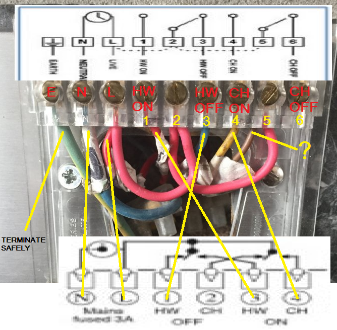

Neutral to N
Live to L
Blue 1
Red 3
Yellow 4

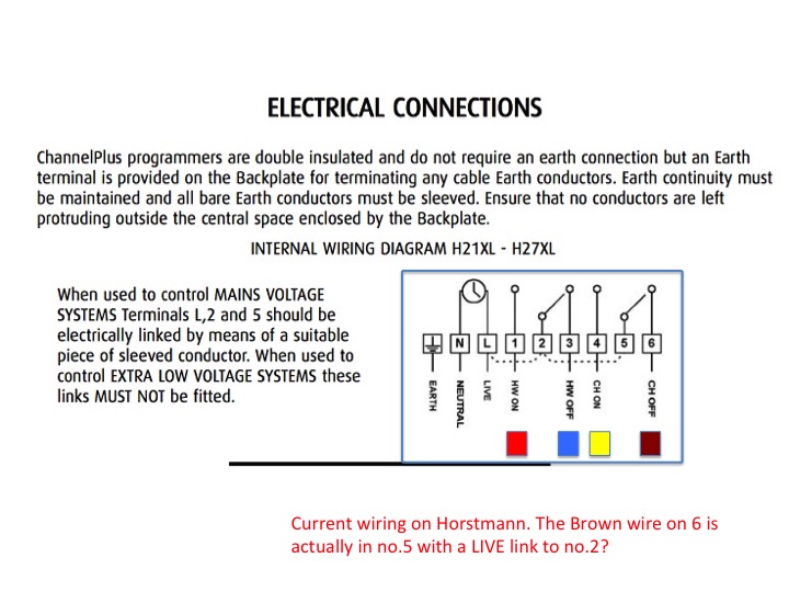

The links from L-2-5 are not needed on the new programmer as they are already fitted internally.

Any brown wires currently going in to the existing L terminal will go in the new L terminal, the 2 little link wires will not be needed.

The Brown wire to which Echo is referring is the supply cable which should be connected:
Brown to L
Blue to N
Earth to E
The Brown wire which was in terminal 6 (not sure where this brown comes from) is not needed.

I am still confused with the wiring for the programmer though? In the picture attached showing the current set up with the Hortsmann, there is a RED wire going into the L which I presume is the Live, then 2 link wires go from L-2 and 2-5 and the brown wire is connected to 5?
Is the brown a LIVE? if so, what is the red one going into L?
That is a bit of a mess.
It is not possible to tell what the Brown in 5 is.
You will have to see where the other end is and what it does.

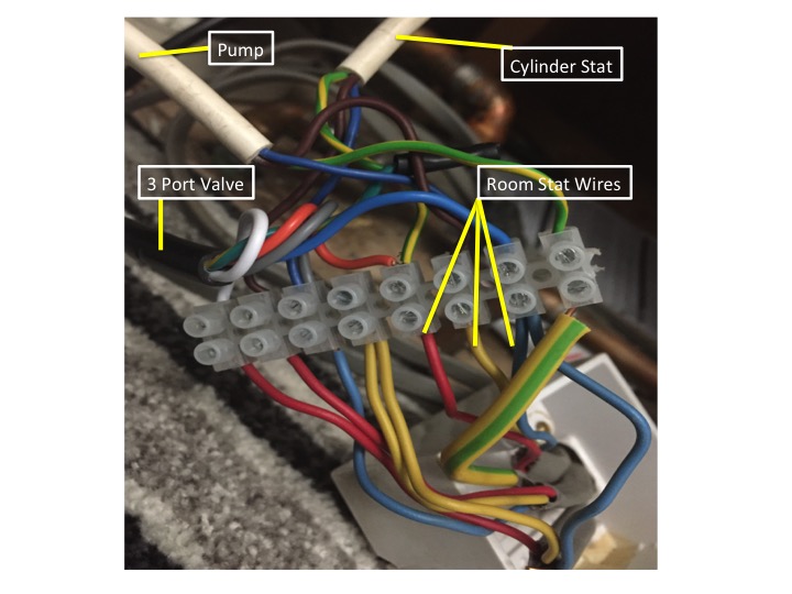

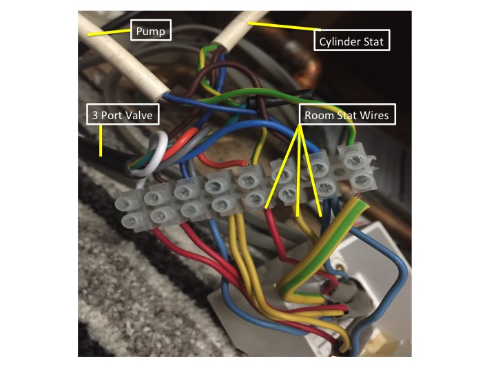

Hi, I been up to the junction box to disconnect the room stat wires to find the wiring as in the picture. I have managed to locate the room stat wires by disconnecting the red wire then trying to switch on the heating via the stat, so can confirm that this is the wiring is it did not go.
So, If I remove the red, yellow and blue wires from the room stat, how and where do I put the link in its place?
Sorry but this junction box is different to the one in Echo's picture and I just want to be sure.

Edited to remove wrong information.
At the correct cable
Remove the three thermostat wires
Put in a link wire from where the red was to where the yellow was.
Someone has been very naughty and used the earth wire as a live conductor in the tank stat cable.
It looks like the same person has cut off all the other earth wires except two. You need to make sure the pump is actually earthed. That is - that earth wire with the big sleeve on it is actually connected to earth.
