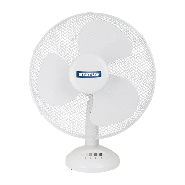

For some reason I'm bothered by it a lot more at night.
Air con feels like a last resort.
I already have a few different fans.
What I am trying to discuss are solutions which actually reduce the temperature, rather than just blow hot air.
