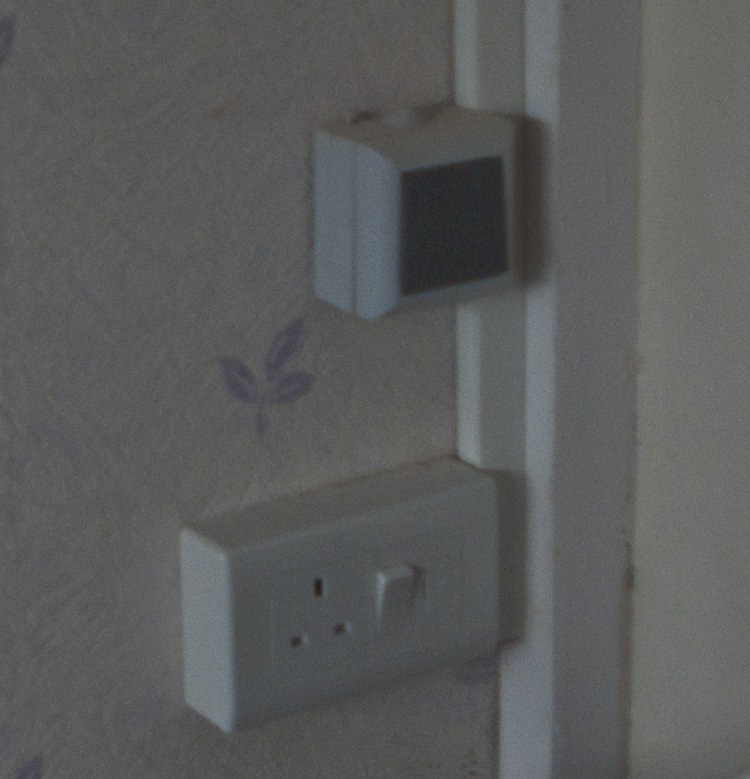

I had a problem in that I wanted to run more from a spur, I used this IMGP7387.jpg the double socket was replaced with a single socket, switch and fuse, I used LAP grid system, you can fit fuses to prevent over load and switches to select between loads, but cable sizes, and MCB sizes are important, I use two one cup water boilers but was careful to ensure not from same socket, so enough time in the adverts to make two cups of coffee, but for that 3 minutes I am using 6 kW so I question how a hot tap can work at 1.6 kW it does seem rather small.

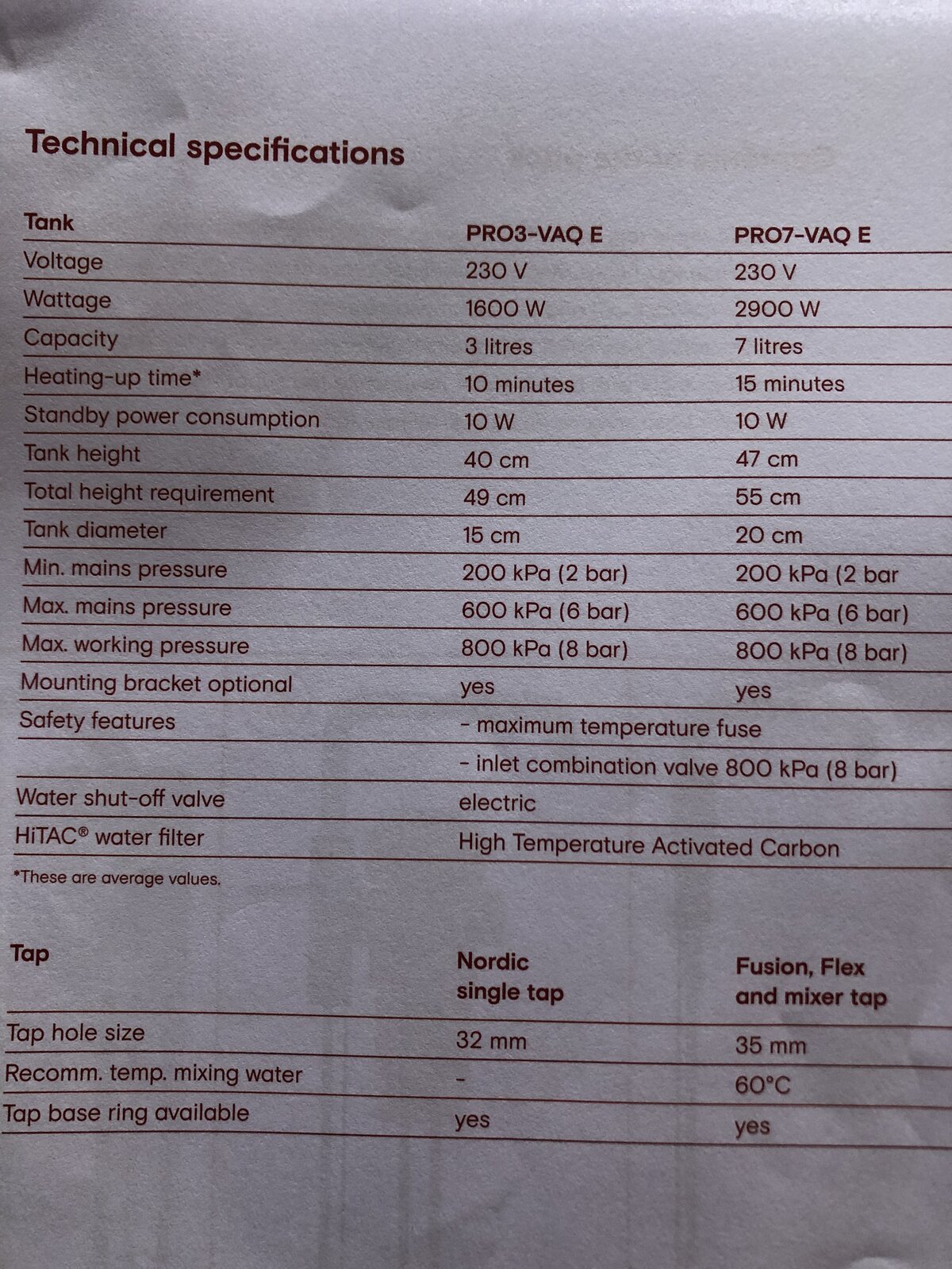

Thanks for your replies. It is a Quooker hot tap apparently the best on the market. It has a 3ltr storage tank and claims to have daily running cost of 3p per day on standby.

The manual says that it stores water at 110°C (which presumably implies that it must be stored 'under pressure'). If one assumes incoming cold water temp is about 18°C then, by my calculations, to raise 3 litres of water from 18°C to 110°C would require about 0.32 kWh of electricity - which at, say, 16p per kWh would cost about 5.2p. How much electricity (hence cost) it would take to keep the water at that temperature for 24hours obviously depends entirely on how well lagged the tank is, but I obviously don't have a clue about that. The manual claims a 'standby' power requirement of 10W (presumably an 'average') which, if true, would cost around 3.8p per day (at 16p/kWh).
The 'heat up time' of 10 minutes they quote also sounds about right - the 0.32 kWh I have estimated above should, with a 1,600W heater, take about 12 minutes.
