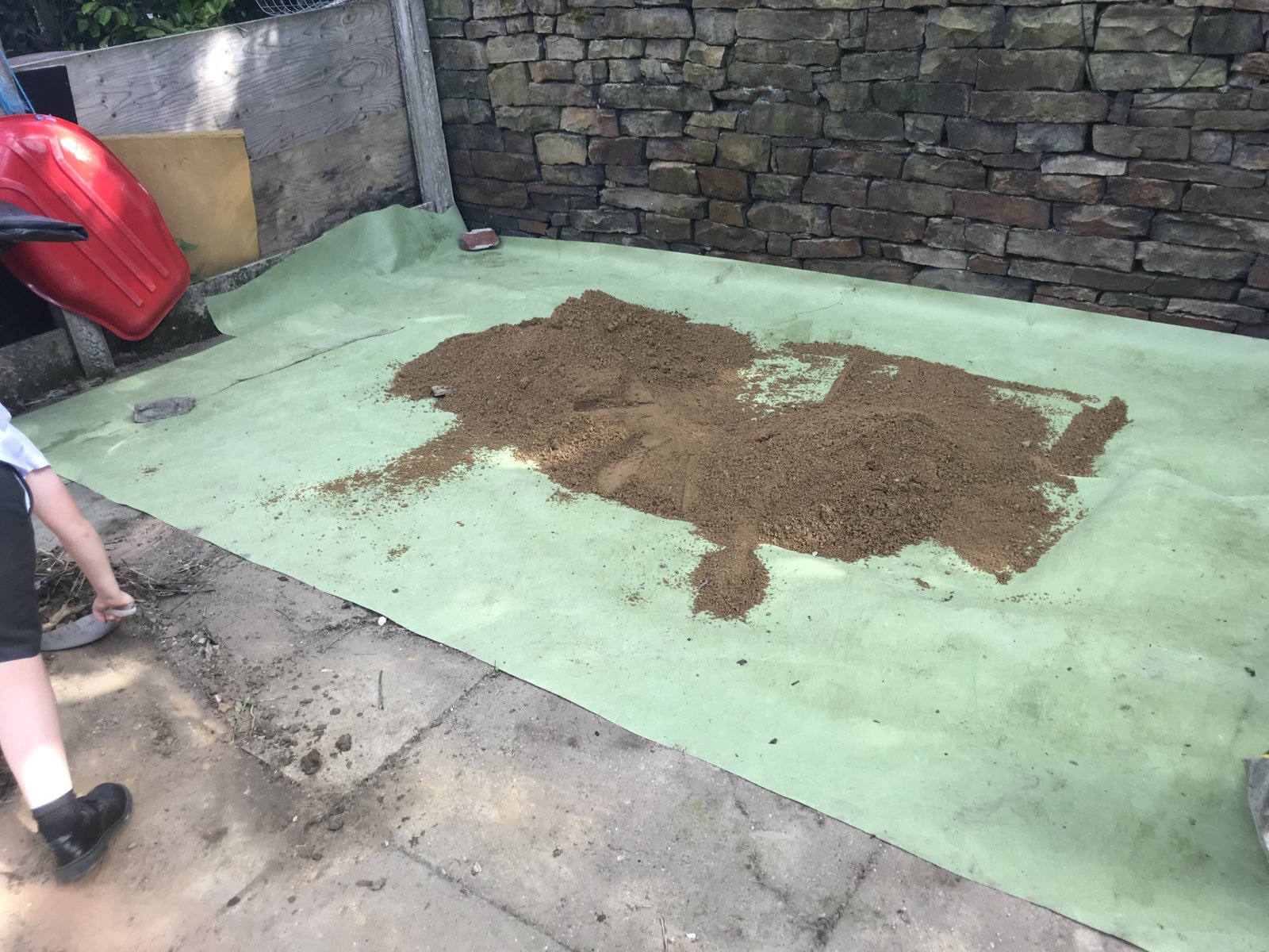

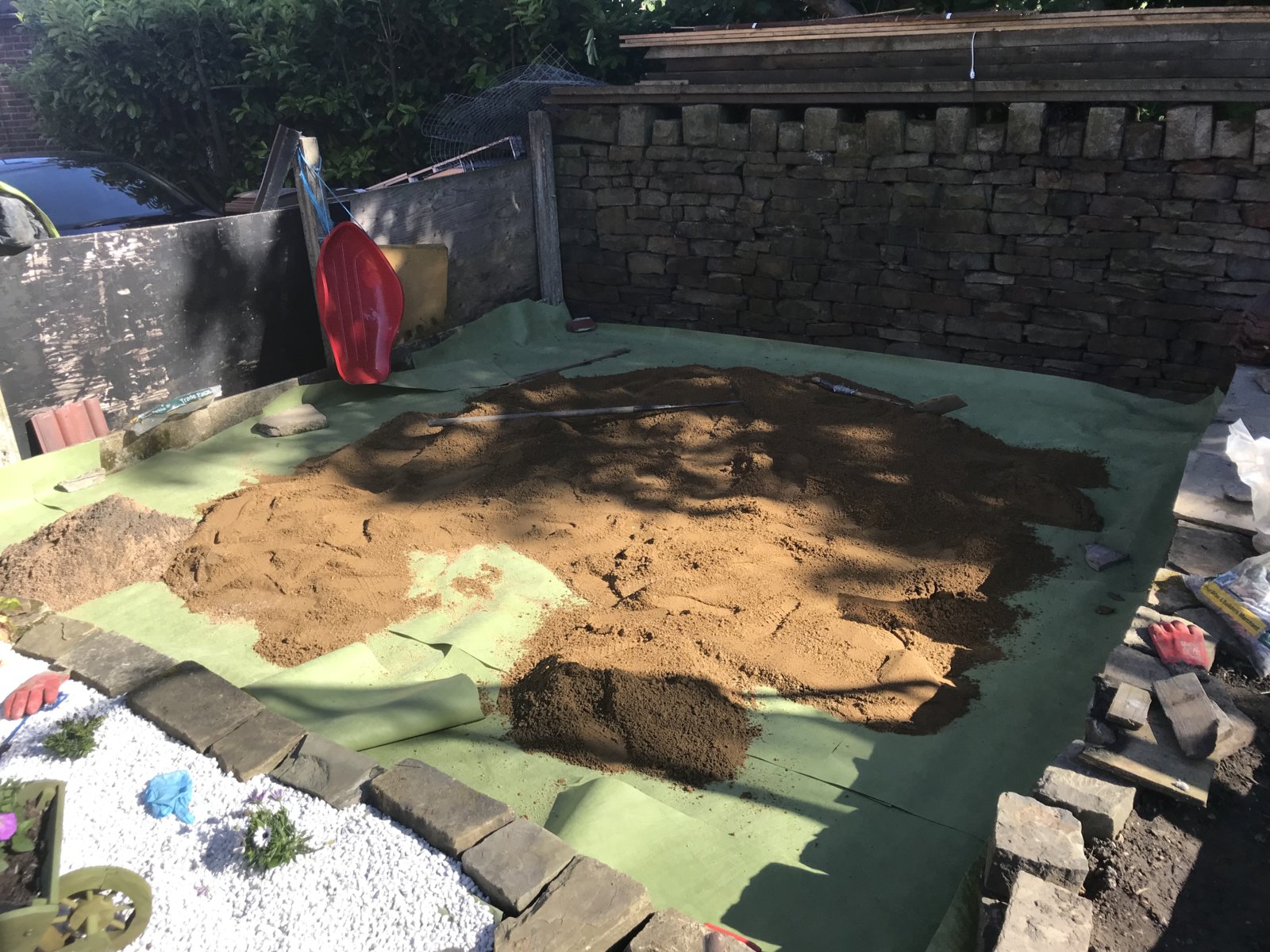

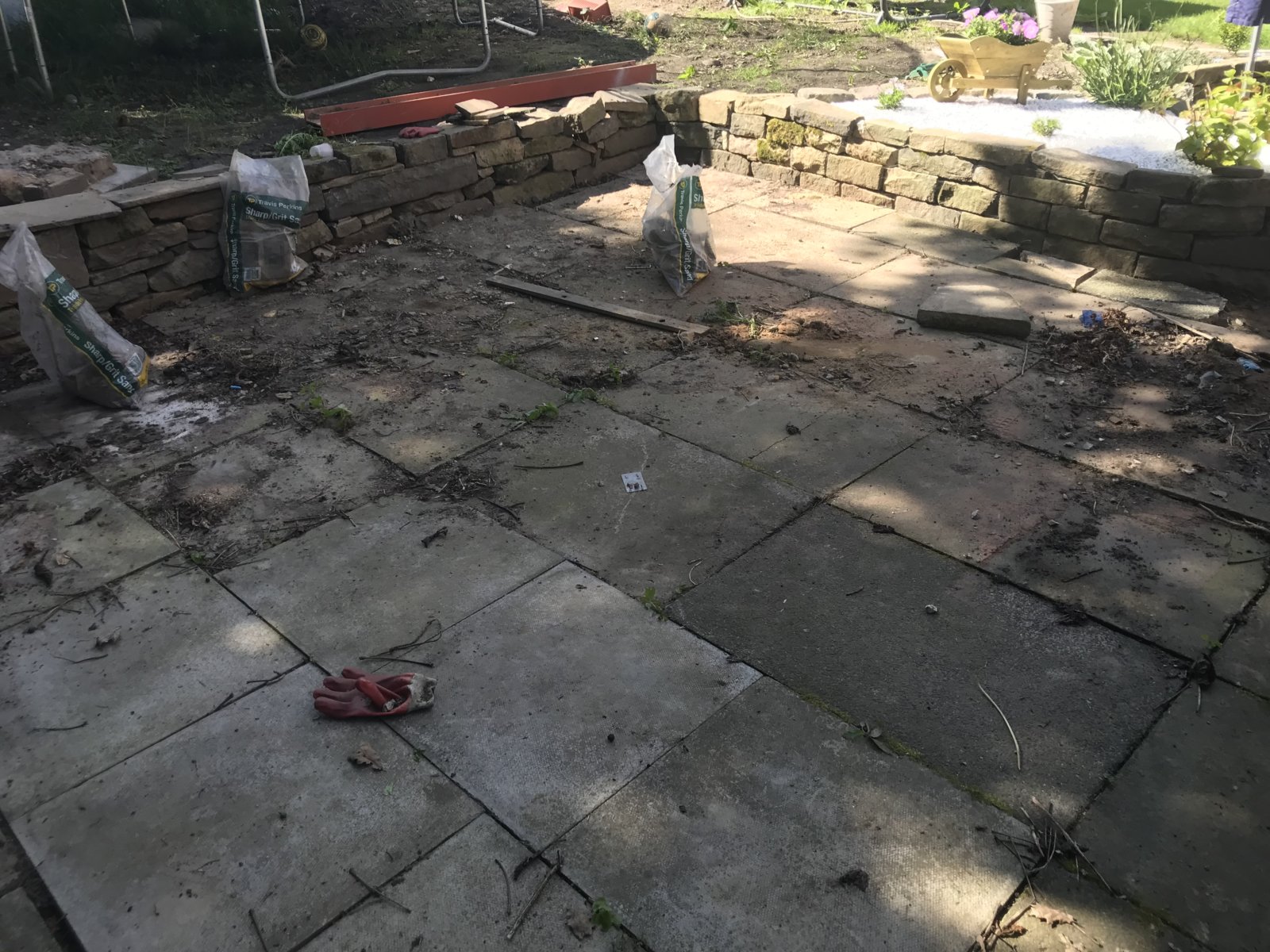

I have a hot tub coming mid March and plan to put it where we previously had a pool.
This is the area being prepped for the pool:

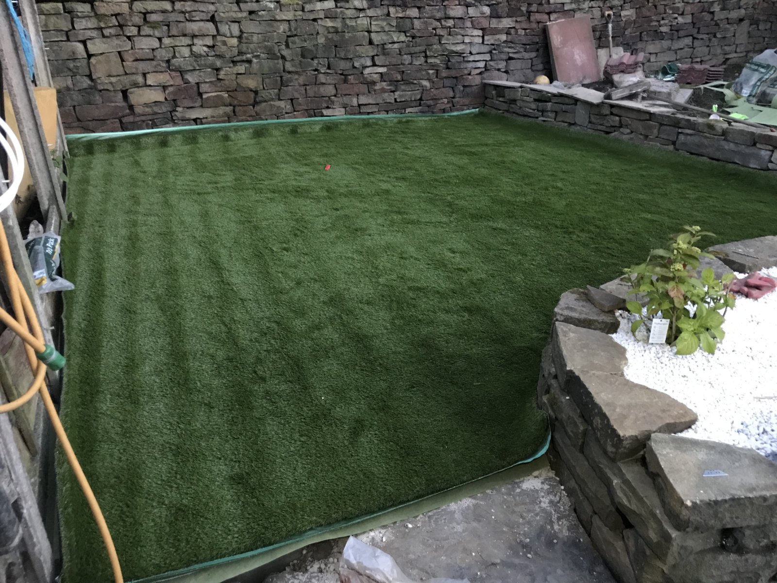

Basically grit sand over old slabs with plastic grass on the top. It’s flat but not level, you could tell this when the pool was full.
So i’m thinking to either:
1. Dig out an area about 3mtrs square and put a level/flat concrete base there and cover it with the grass
2. To cut the grass, lift the slabs, make a level/flat frame from decking so there’s a step and then pour concrete behind that. I could then stick the grass back on the top.
3. As per 2 but leave the slabs in place.
4. Lift the grass, level the sand, replace the grass. With that i’d be thinking the sand might wash away during heavy rain.

The hot tub will be a fair weight. I'd want a concrete pad for it myself. So I'd go for number 1. Anyhow, what are you doing lording it up in a hot tub? You started swinging or something?

Option 1 it is (y) We had a weekend away and had one so thought we would try one at home. I saw a good deal on a 2018 model going cheap, bartered the price down then ended up getting the latest model for the cheap price because they had non of the older ones left :)

Hi Jon i'd be inclined to put a layer of sharp sand under the grass. Put raised decking round it so you can either get in or sit on the side and dip your toes.

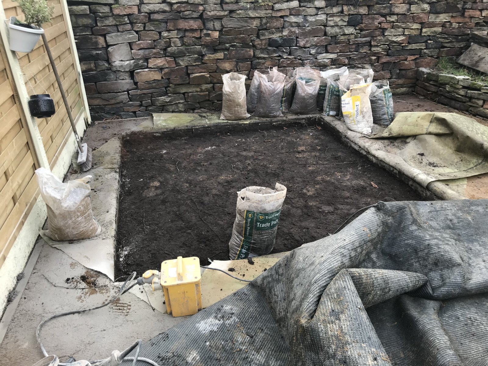

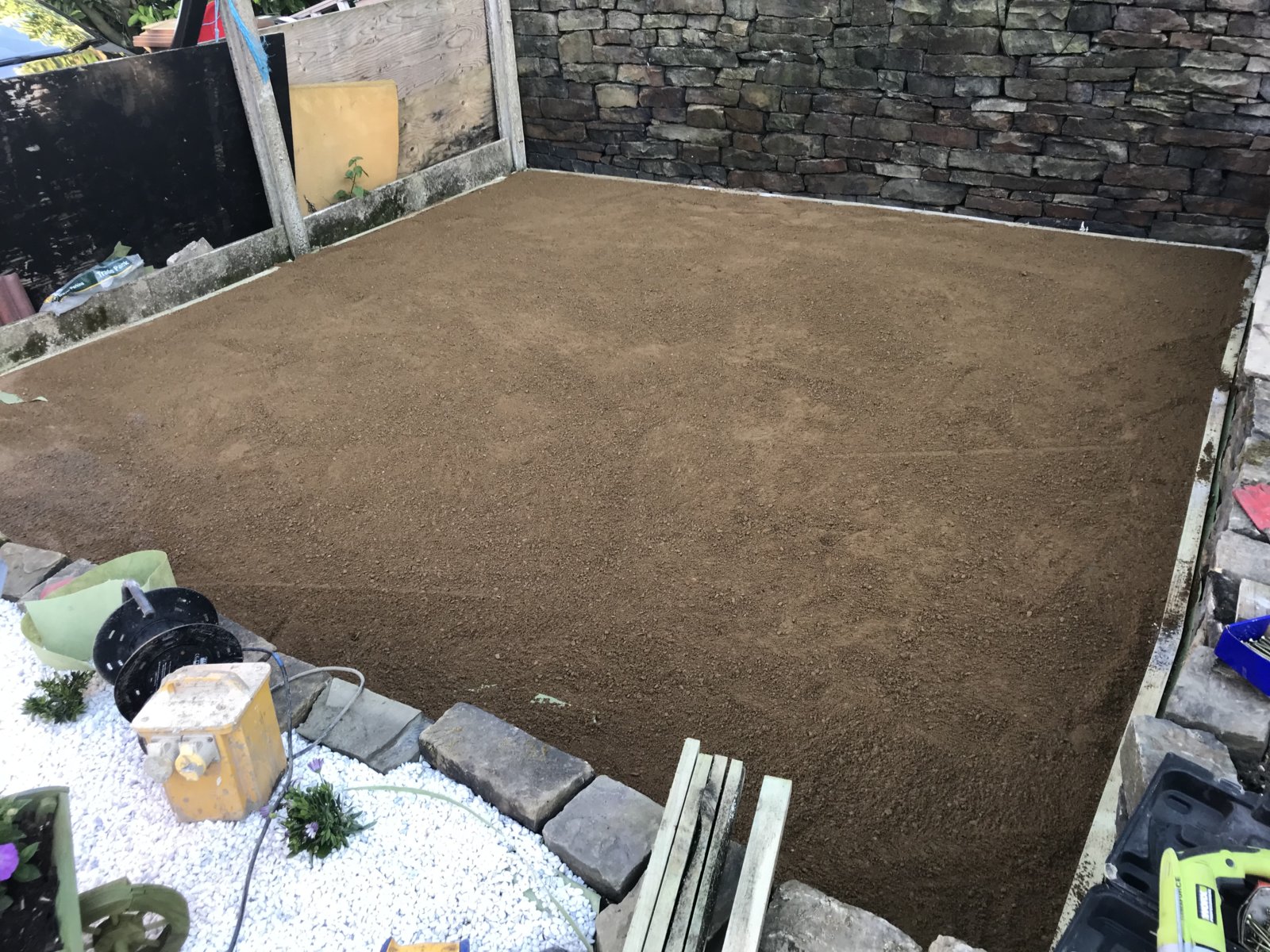

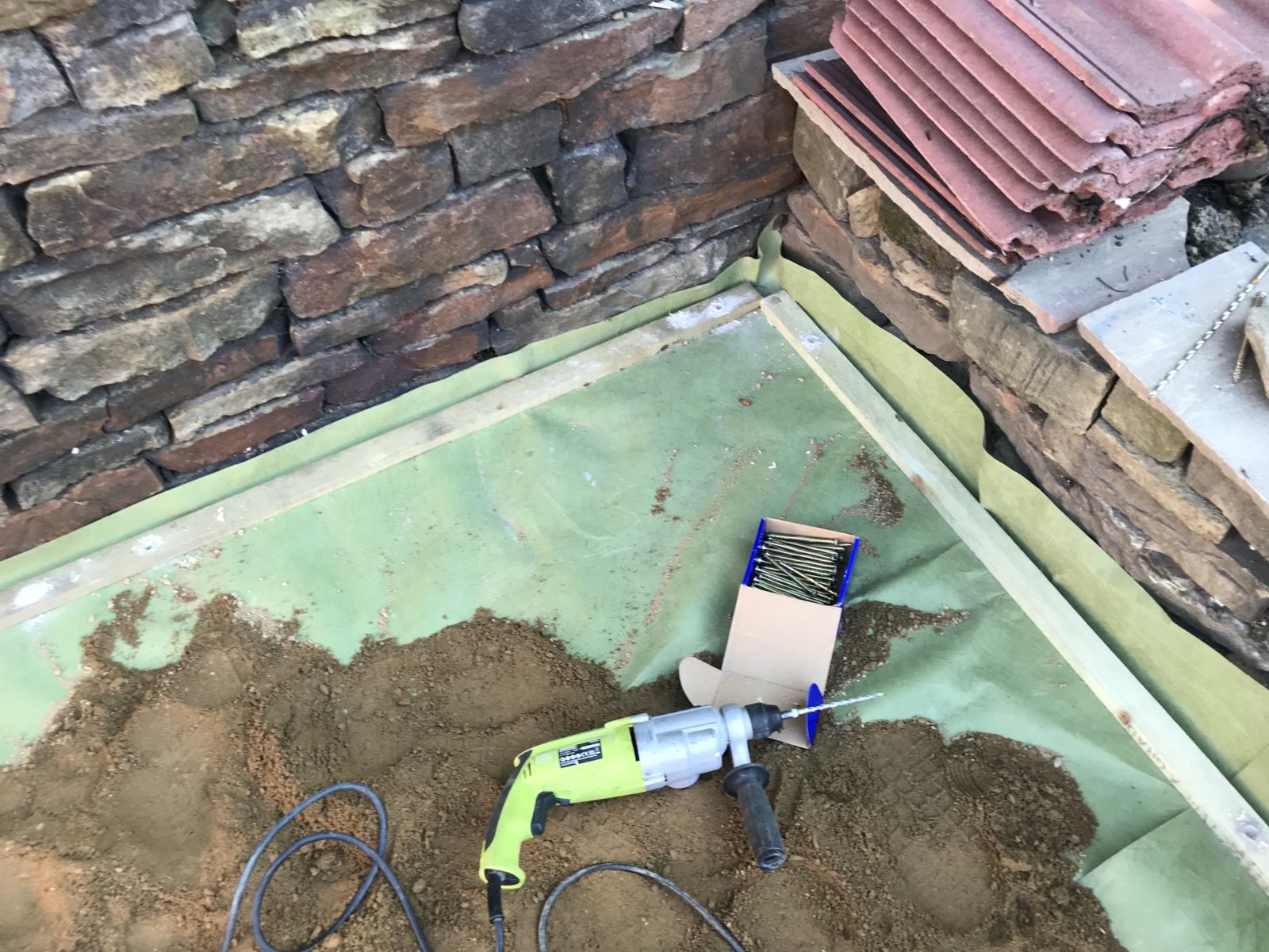

I’m on with the base today.
I’ve peeled the grass and sand back, lifted the slabs and dug it out to 4 or 5”.
I’m going to build a frame from 4x1, get that perfectly level then infill that with concrete.
Couple of things I’m thinking:
1. Should I dig a bit deeper and put 25mm of Celotex under it or would that be a waste of time and money?
2. Does it need a DPM or could I just lay the concrete onto the membrane if I fold that back over?
Thanks :)
Hi Ian. Late reply but hows the drainage in this spot. Be careful the base area can't get waterlogged. I'd say 25mm would be a waste of time dont they use that
General Purpose Polystyrene under concrete floors and that's usually 75mm at least.
