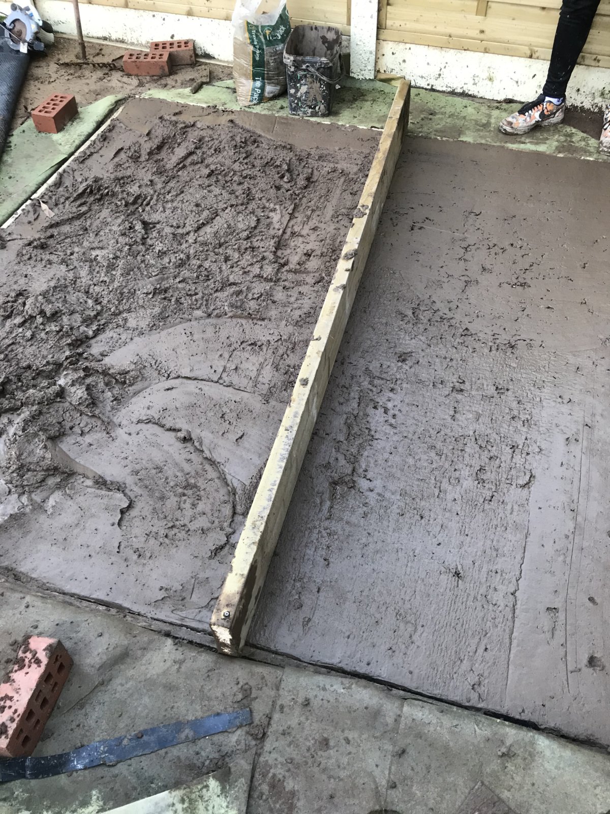

I’ve just done the base :)

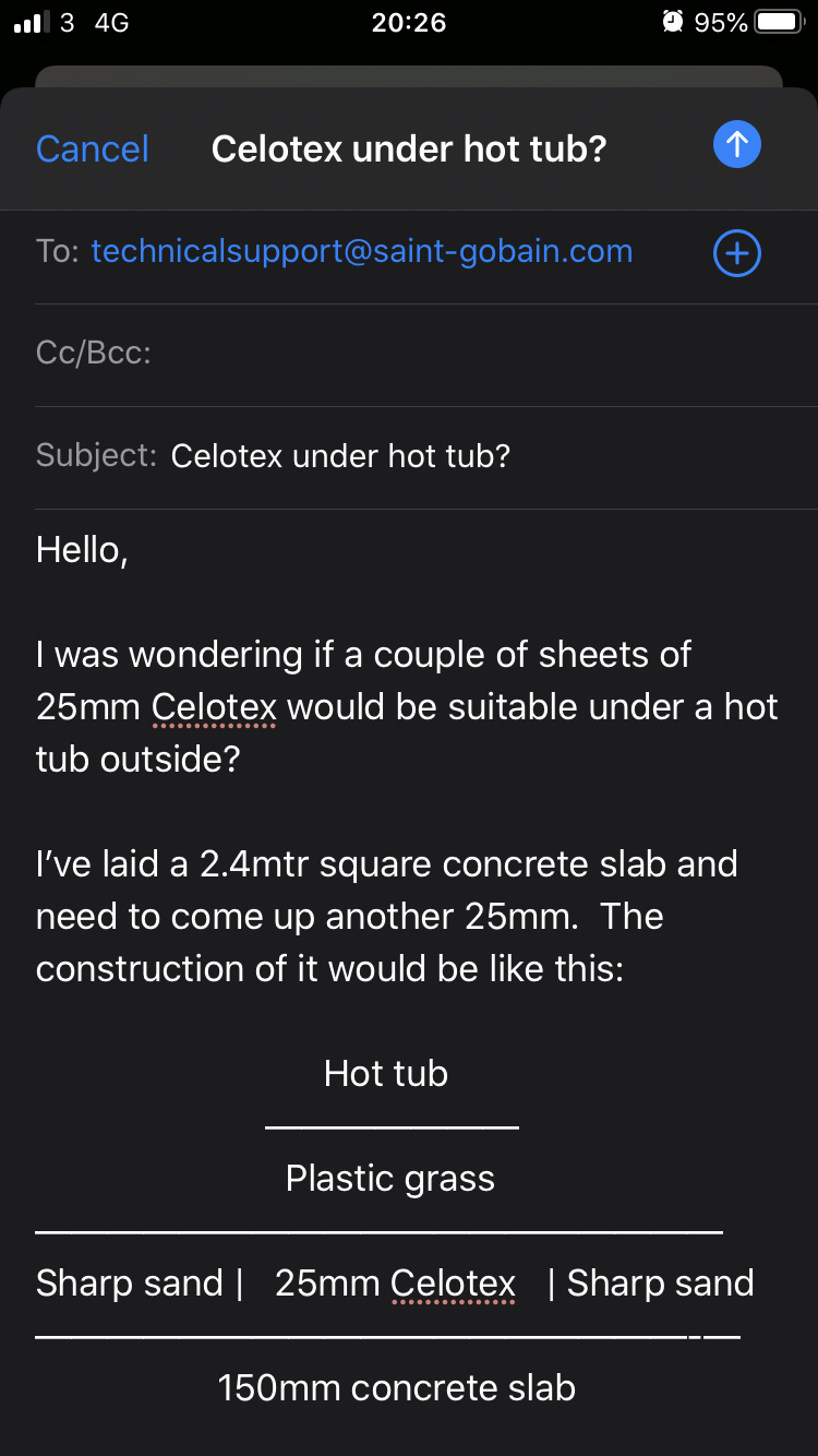

I’m still thinking of putting 25mm of Celotex over the top. My only concern would be that the edges of it would only have a bit of membrane between them and the sand.
Is Celotex suitable for outside? Can someone talk me in/out of the idea scientifically please?
https://www.celotex.co.uk/applications/floor-insulation/concrete-slab-floor I'd check out the website. Wish i'd of known you were doing it this weekend as the missus been doing my head in lol.
I didn’t really want to do it, I was rough yesterday and today I thought I’d best get on with it while the weather was good. I got my son to shovel the ballast and bring the cement and I chucked it in the mixer then in the hole.
I just e-mailed Celotex about using it outside but I think I’ve made my mind up to use it anyway.

We had some bad frost in the night :(. I just touched the surface of it and it’s still wet. Hopefully the gazebo top and wall/fence protected it enough.
Celotex got back to me quickly:
Fair enough, it’s not suitable and it was good if them to let me know so quickly.
