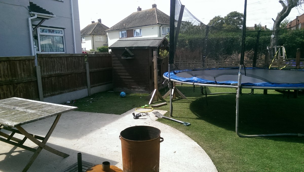

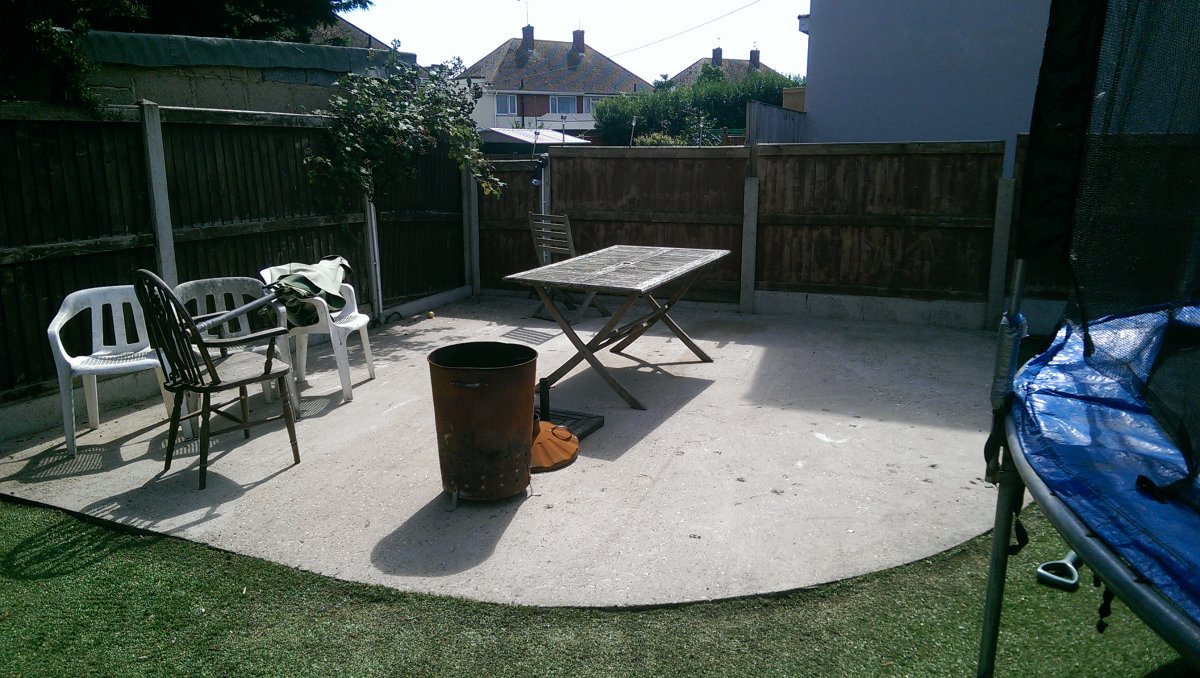

I already have a concrete base around 5 X 5 Meters currently used for trampoline to be used in corner of garden. Fenced on two sides.
I am looking for designs suitable for this, the concrete drains well in the rain, would tub be ok freestanding on it? Also as concrete already down, (5 years) would structure be fine freestanding?

This is the base and view I have, as you can see privacy is the main goal here, and with the size of base already down why it will probably be freestanding. I like the idea of a vent in roof. Do you think moisture would be a problem with apex without gap?
I do like the simple rustic look of third picture, how do you go about getting main beam in place?

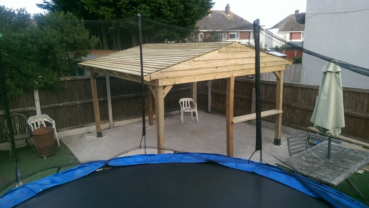

Im going to use 6x6 posts for looks and strengh. Thinking of bolting 6x2's round top and for rafters, May bolt posts down with metal post supports. And featheredge two sides and top. May see if I can salvage some kind of chimey to make it quirky.
And yes, much cheaper, as can do it bit by bit as funds allow.
As for hoist, not sure what we can get yet, track would be best but would worry about weight. Although I'd prob go overboard so would take car of that.

This is what I have ended up with, first time I have attempted something like this, but am very pleased with result.
I welcome any constructive criticism.
Am not to sure how to approach the sides yet but can work on that now it's up.
