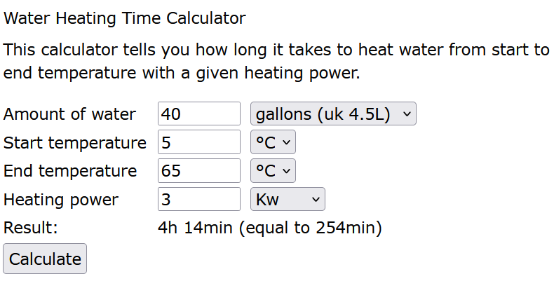

Working out how long a 300 watt item has been running for is hard, the orange line is how much I am using and I can just about see when the heat pump tumble drier kicked in. 1700049169594.png But with 3000 watt it is reasonably easy to see when it has been running, 1700049276453.pngsee when I boiled the kettle to fill the flask, so I assume the same is true with smart meters, it should be easy to see when the thermostat cuts in and out when heating the water. So one should be able to see how long it takes, and if the immersion is working. Before have solar panels and with no smart meter it was harder, I had to use a clamp on meter Clamp-meter-small.jpg on the meter tails to see what was going on, but it seems unlikely one can heat 40 gallons of water in 1½ to 2 hours, calculator here 1700049942858.png it seems it will take over 4 hours even at 65ºC if you went to 80ºC then over 5 hours.

Looks like a 200 litre cylinder: TSMD 200: https://www.tdlonline.co.uk/docs/Tempest/Tempest-Direct-Data-Sheet.pdf
That has a heat loss of 1.85 kWh every day - and a 3kW immersion need to be on for 37 minutes to make up that heat loss alone, once the cylinder is up to temperature (60 C). The spec sheet states a reheat time from 10 C to 60 C of 116 minutes (6 kWh on the bottom element). Thus your approx 2 hours daily in two 1 hour sessions is never going to quite 'cut it' if you use most of that 200 litres in the day via showers etc.,..
It is possible the immersion thermostat never cuts out as the water never reaches the required set temperature.
That bottom timer looks to have two lots of only three segments set for ON periods: from 0645 to 0730 and 1615 to 1700. If I'm correct no wonder the water is never hot enough.
