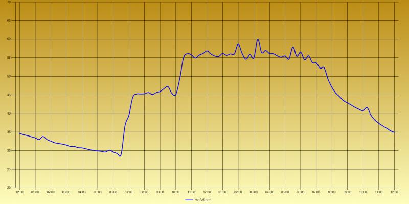

I have just recently tried to save money by turning the immersion off at 6pm and as we are two pensioner who don't use a lot of hot water I thought it would stay warm enough to have a wash/shower in the morning but it doesn't and I have to give it a boost up to 45c at 6:30 and then raise temp to 60c for rest of day (i did this because I thought that the hotter it was it would keep hot longer)
this is a graph of tank temp from last night can any one advise as to what might be wrong please?

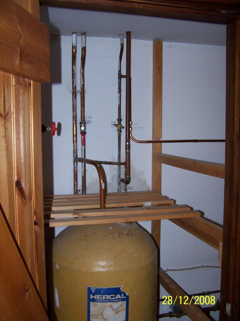

As for updating the rest of the system yes it's a nightmare. the immersion cupboard is a mess I've never seen anything like it although I bet you have seen a few as bad lol

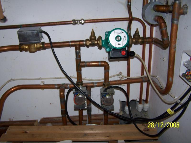

This is how it was when I moved in. The pipe work is still the same
Could be a convection current finding a path from cylinder and back again. It looks like you have a shower plumbed from cylinder outlet is the cold for this shower fed from cylinder feed?
The shower mixer would feel warm when not in use.
The pumps not ideal either really,if it has to be mounted horizontally then the electrics should at least be on the top.

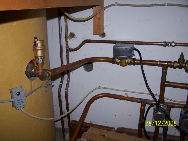

It also looks like your cylinder stat is too high on the cylinder.

Ah thats interesting ! Mogget also mentioned about where I was measuring the temperature.
Now I don't use that thermostat any more since I added my computer control and it was difficult for me to put my temp sensor chip anywhere else but on the top outlet just 20mm above the tank.
But if you think that is too high then I guess you will think my new one is miles too high!
So I can see the logic that my tank is not getting hot all the way down.
so there is not enough hot water. mmmh
but I have tried increasing the temperature that my sensor will cut off the power and when I go above 65c the black reset button pops up and turns the immersion off until I reset it.
so I'm thinking it doesn't matter where the sensor is ......
Is my logic right here?
I'm no plumber so have almost zero experience
Aha! if your sensor is the same one controlling the heating your cylinder may not ever get properly hot.
The heat is introduced somewhere in the cylinder, and the hot water nearly immediately rises to the top (hot water is lighter than cold water). This forms layers of water at decreasing temperature down the cylinder, which is known as stratification.
You need to make sure that the sensor controlling the heating is placed somewhere lower on the cylinder. Then you will heat all of the cylinder above this point.
If you're switching on the immersion, the sensor at the top will very quickly register 60 degrees but just a couple of inches lower down the water may be near room temperature. So there will be very little hot water in the cylinder at the point you turn it off.
Attach another sensor 9 inches lower and you'll see the effect.
To add, I would place the cylinder thermistor for your way-above-my-head computer control system 1/3 of the way up the cylinder.
I'd love to be able to program computers, just never seemed to master coding.
...and it was difficult for me to put my temp sensor chip anywhere else but on the top outlet just 20mm above the tank
You can cut through the foam on the cylinder to gain access to the hot bit inside ;)
