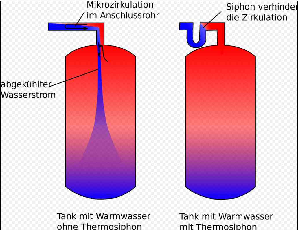

The Coronavirus lockdown got me looking at the problem again. I found some talk about a heat trap which stops the cold water from
the pipe system displacing the hot water in the tank which is what I suspected was happening.
The simplest heat trap is a U section of pipe in the pipe that leaves the top of the cylinder it can also be done with simple commercially available valves.

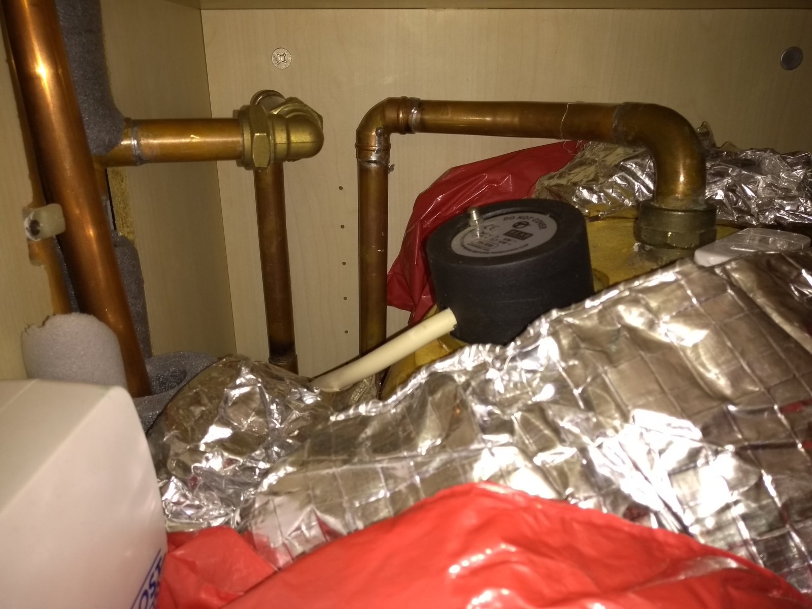

As I had some pipe and fittings I made a 200mm deep U section to add to the outlet at the top of the tank.
We now have warm/hot water overnight which I'm hoping will be hotter when I get some new pipe insulation fitted.
The 50-40 degree temperature drop now takes 9 hours.
If this is part of the open vent it should rise continually from the top of the cylinder. A "U section" should not be there if so. A pic would help.
The information I found shows the heat trap between the top of the cylinder and the rising part of the open vent.
As I had no room directly above the tank I have put the U section rather lower than ideal as can be seen in the picture. The bottom part of the U is out of sight.

That really should not be there. The pipe from the top of the cylinder is the open vent and must rise continuously.
this is what I found
There an no UK links on that Wikipedia page.
From the relevant British Standard "An open vent pipe rises from the top of the hot water storage vessel to a point above the water storage cistern, into which it is arranged to vent. Explosion protection involving no mechanical devices is provided by the open vent and the cistern."
Any air build up has no way of escaping in your set up.
The Wikipedia article (poorly edited) has been created from a document by ESBE (a heating and plumbing manufacturer) and does not refer to traditional vented cylinders.
The outlet from the top of the cylinder should rise slightly from the horizontal and then join the vertical vent/feed pipework...it must allow the cylinder to boil in case of a fault.
In addition I suspect your taps splutter from trapped air in the cylinder.
insulate the cylinder, and the pipes rising upwards from it.
In your case, if you take out your "U" and restore the near-horizontal piece (it should slope very slightly so that air bubbles will escape upwards) most of the heat will be in the horizontal pipe, and the vertical pipe beyond it will be slightly warm. There is not much convection in a pipe unless it is larger than found in a house.
