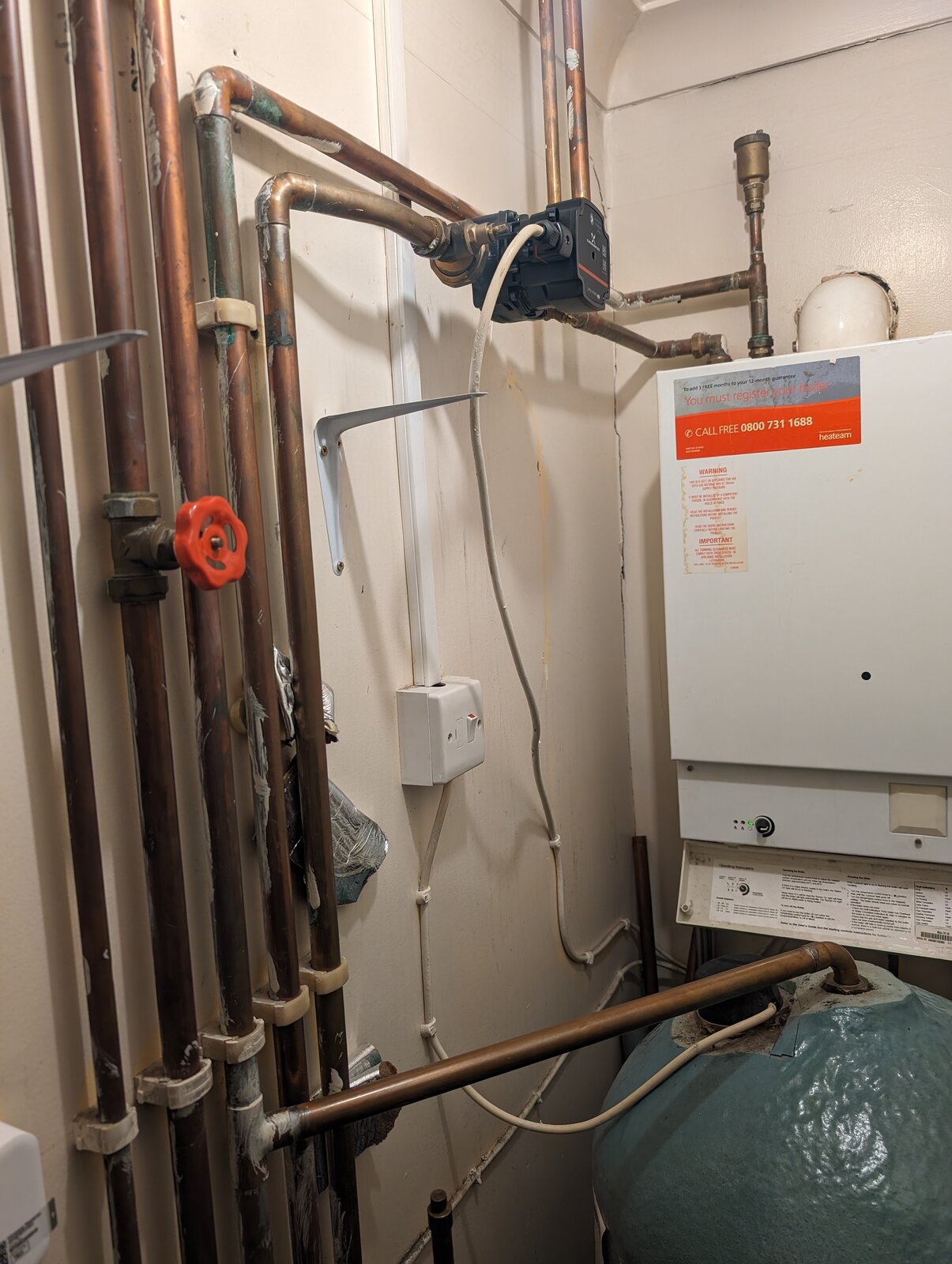

Hi all, just moved into our first property with a water tank and conventional boiler.

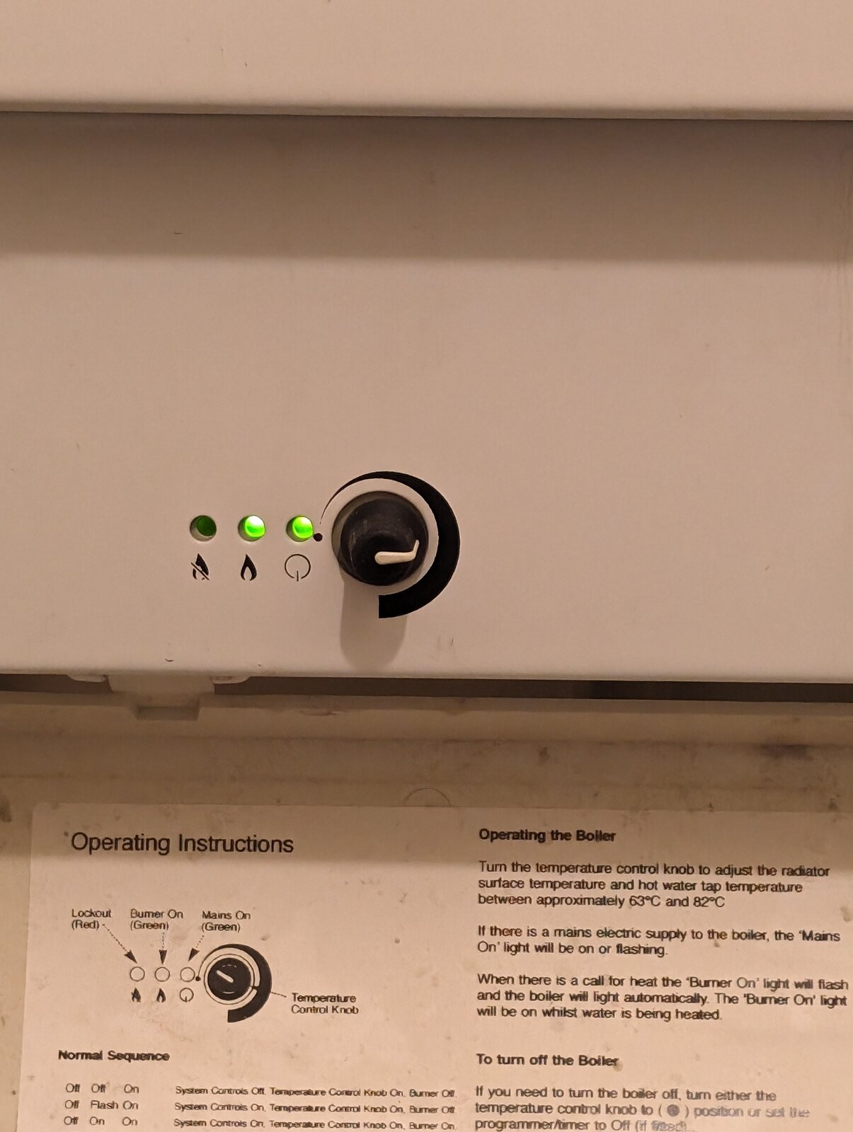

Boiler has a temp dial (Main 24) annoyingly that has no indication of what the temp values actually are!

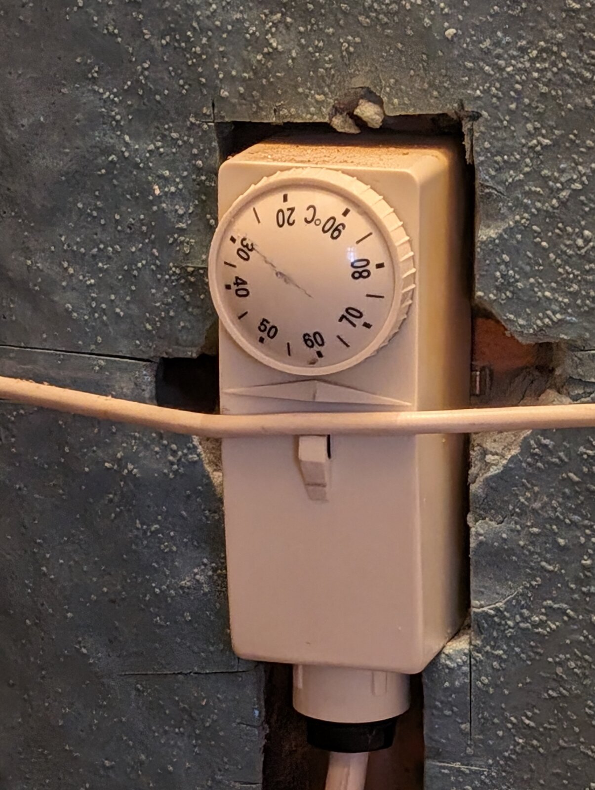

Tank has its own temp setting which I have set at just under 60.
But if tap is turned to the hot side the water comes out way too hot especially when we have children in the house.

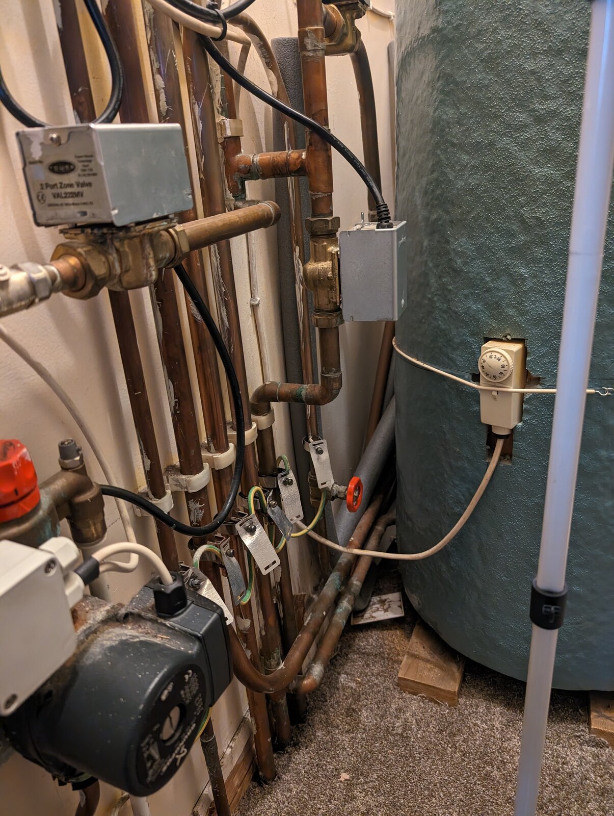

Its pumped and has all this kit in the airing cupboard.
Any suggestions?
The cylinder stat controls your hot water temperature
Turn it down a bit more if hot water higher temperature than you want.
Check hot motorised valve is working with hot water powered up turn down cylinder stat you should hear valve closing.
If boiler continues to run could be faulty motorised valve.

If the motorised valve controlling the supply from the boiler to the cylinder coil is worn out, it may allow the cylinder to be heated whenever the radiators are on, even if the cylinder is already hot. You can detect this by feeling the pipe coming out of the valve. The valves commonly last 10 to 20 years. The water part of the valve can be worn out even if the electric motor part is working or renewed.

The hot water cylinder will have stratification, ie there will be a temperature gradient, if you feel the underside of the tank it will be cold or lukewarm, whereas the pipe at the top will be scolding.
Your cylinder stat is about 1/3 of the way up, so if it’s 60 deg there the water at the pipe at the top will be higher.
My cylinder stat is set to 50 and the water at the tap comes out at about 60
The temperature of the flow temp from the boiler doesn’t influence hot water cylinder temp as such, if you have a high boiler flow temp it will heat the hot water up faster until the cylinder stat stops calling for heat.
Just put a meat thermometer under the kitchen tap and was recording 63 degrees c.
Ive knocked the cylinder down to 50 now so will see if that brings the temp down any
