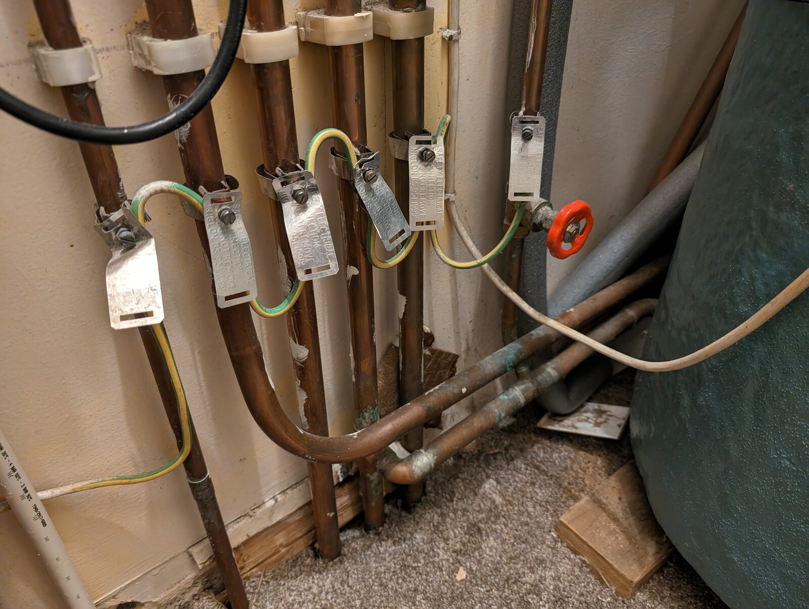

If the motorised valve controlling the supply from the boiler to the cylinder coil is worn out, it may allow the cylinder to be heated whenever the radiators are on, even if the cylinder is already hot. You can detect this by feeling the pipe coming out of the valve. The valves commonly last 10 to 20 years. The water part of the valve can be worn out even if the electric motor part is working or renewed.
Sorry which valve will this be?
So hot water off, but heating on, check pipe temp?

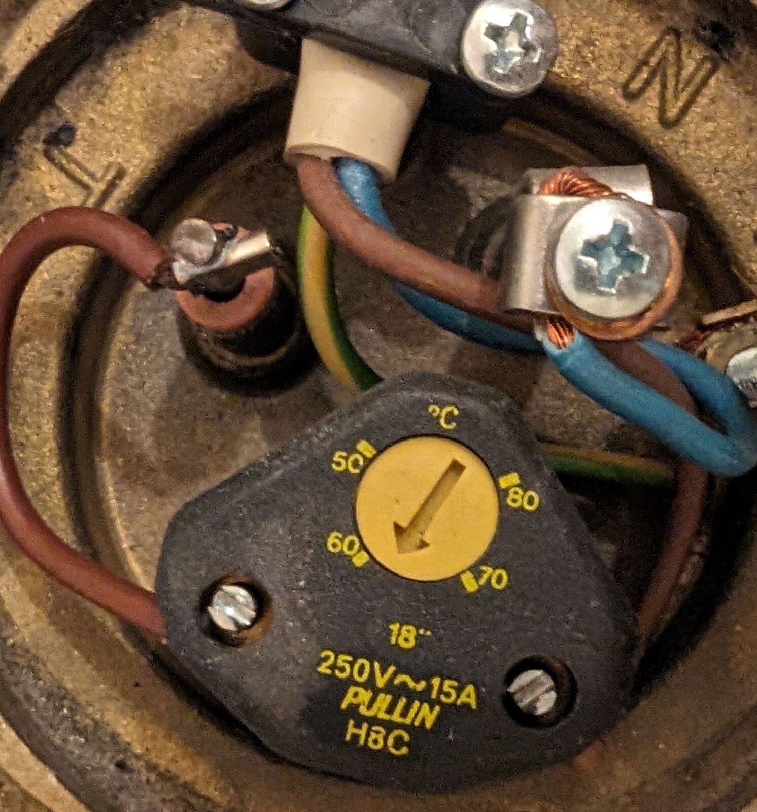

If you take a few more photos of the cylinder the immersion(s) can be identified and the control thermostat which may be in a separate "box" attached to the cylinder, the setting can then be checked and, if, required, reduced, you may well need this immersion if your boiler breaks down and its better to have the correcte temperature setting (now) rather than trying to set it in then.

Its in the second photo from the top, with a black cap. Switch off the immersion and remove the nut then the cover and take a photo.
Could be the answer... Just knocked it down to 50ish but turned off anyway
