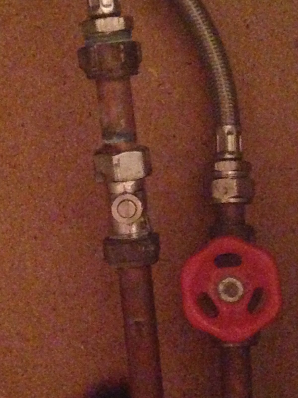

Hello
We got a plumber in to change the gate valve and tap.
There was a bit of water in the flexi hose yes but that seems like it.
I have noticed since the valve was changed (about 24 hours ago) the valve has been dropping a bit. Maybe 5-20ml of water in 24 hours.
Is this normal? Will it sure it's self up in a little while?
Many thanks
He's used a cheap isolation valve if they are leaking at all, time to get him back and replace it with a decent one.
Is the arrow pointing in the right direction for the flow of water, and where exactly is it leaking; from the valve, or one of the joints.
This is what it looks like
And it's leaking from the top nut

Shame he didn't put a full bore lever valve on like the one I listed earlier for you.
There's always a chance that the nut just needs tightening slightly.
I thought the same but it's what he had so I thought as long as it gets fixed so be it.
Hopefully it does just need tightening and he can do it because I'm a bit dubious to touch Anything now in case they refuse to fix it as I've tampered with it
