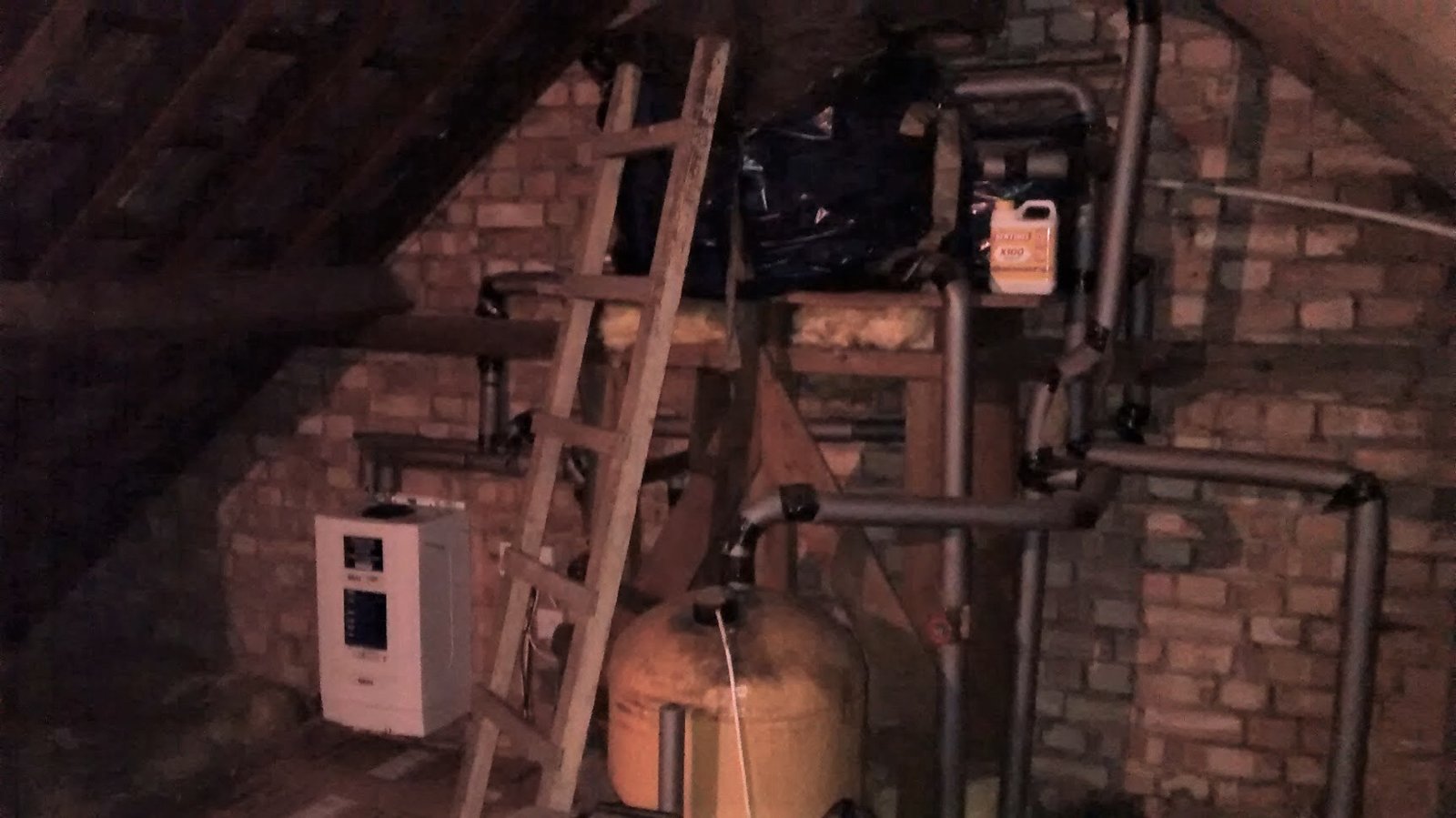

I have a Baxi boiler, hot water tank in the loft of my bungalow, fed by a cold water tank in the loft. Plumber once mentioned that the pressure would be low as cold tank only slightly higher than hot water tank.
Hot water always takes ages to come through, about a minute I guess. Most pipes are in the loft, and lagged, and under loft insulation.
Even if the shower or another tap has just been used, a tap in the other bathroom is really cold to start with - not just cool, but seems as cold as the cold tap. After about a minute it warms up, but is never really hot.
Might it be that I need a new hot water tank? Or position it downstairs for better pressure? Or feed mains into it instead?
Wondering if it is just because of the low pressure that it seems worse.
Also, what would be the best way to improve the pressure?

Do you ever get HOT water , it maybe a setting on the tank thermostat, the white box lower left on picture
How hot are the pipes , cant see from the diagram
Hot water out the TOP pipe, the two sides should be from the boiler, are they hot when boiler on for hot water ?
see diagram here

Your plumber is correct in stating the cold water tank in relation to the cylinder, it’s called the head of pressure. 1m head = 0.1 Bar (roughly), which judging by your photo is approx what you have. The best way to increase the pressure would be to have a pump, convert to a combi or have an unvented cylinder fitted. If you’re talking about flow rate, then that’s something a little different. How long does it take to fill the kitchen sink? Get it checked if you’re finding it difficult, it could be a blocked cold feed to the cylinder, a partial blocked hot outlet, the gate valve could be restricting the flow.
Isn't the static head ( pressure at tap ) determined by the difference between the height of the surface of water in cold water tank and the height of the tap to which the water will be flowing.
Dynamic pressure at the tap ( when water is flowing ) will be reduced due to the resistance to flow along the pipe work
The hot water tank has the same effect on the pressure at the tap as a length of very large bore pipe
I think it's probably the safest thing up there!
Your shower could back feeding cold water into the hot water if the NRV's don't shut properly also check that it doesn't run through any section of iron pipework which will gradually reduce the bore of the pipe.
