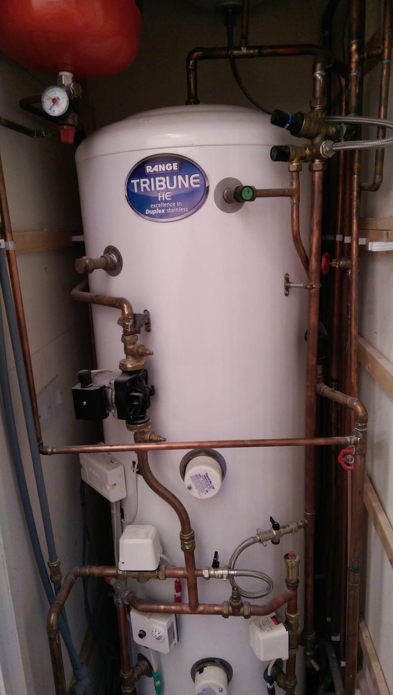

Hi,
We have just moved to our new house and we have a slight issue with showers.
The hot water runs very low on both showers, one at same floor of the hot water cylinder and one floor above it.

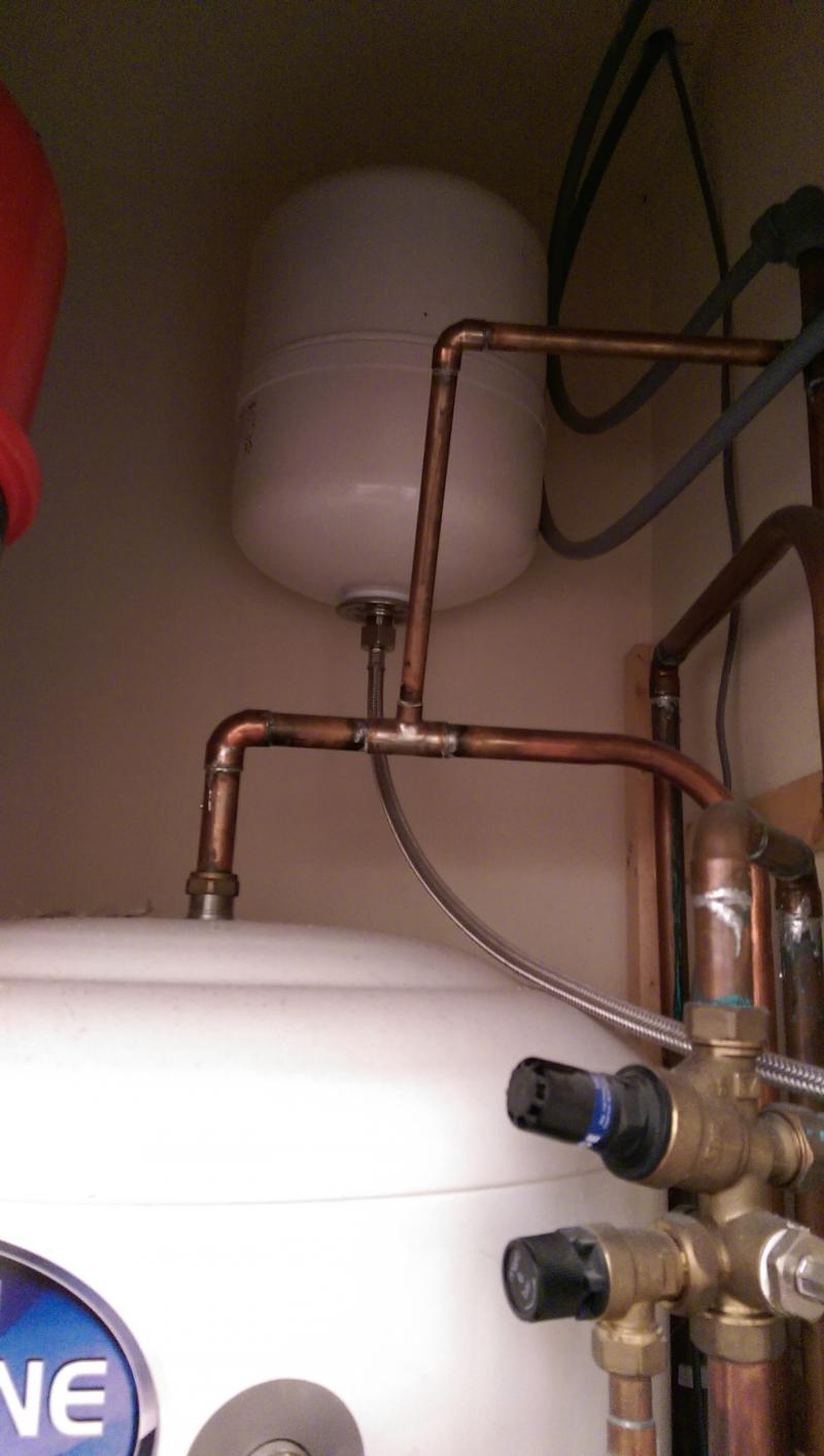

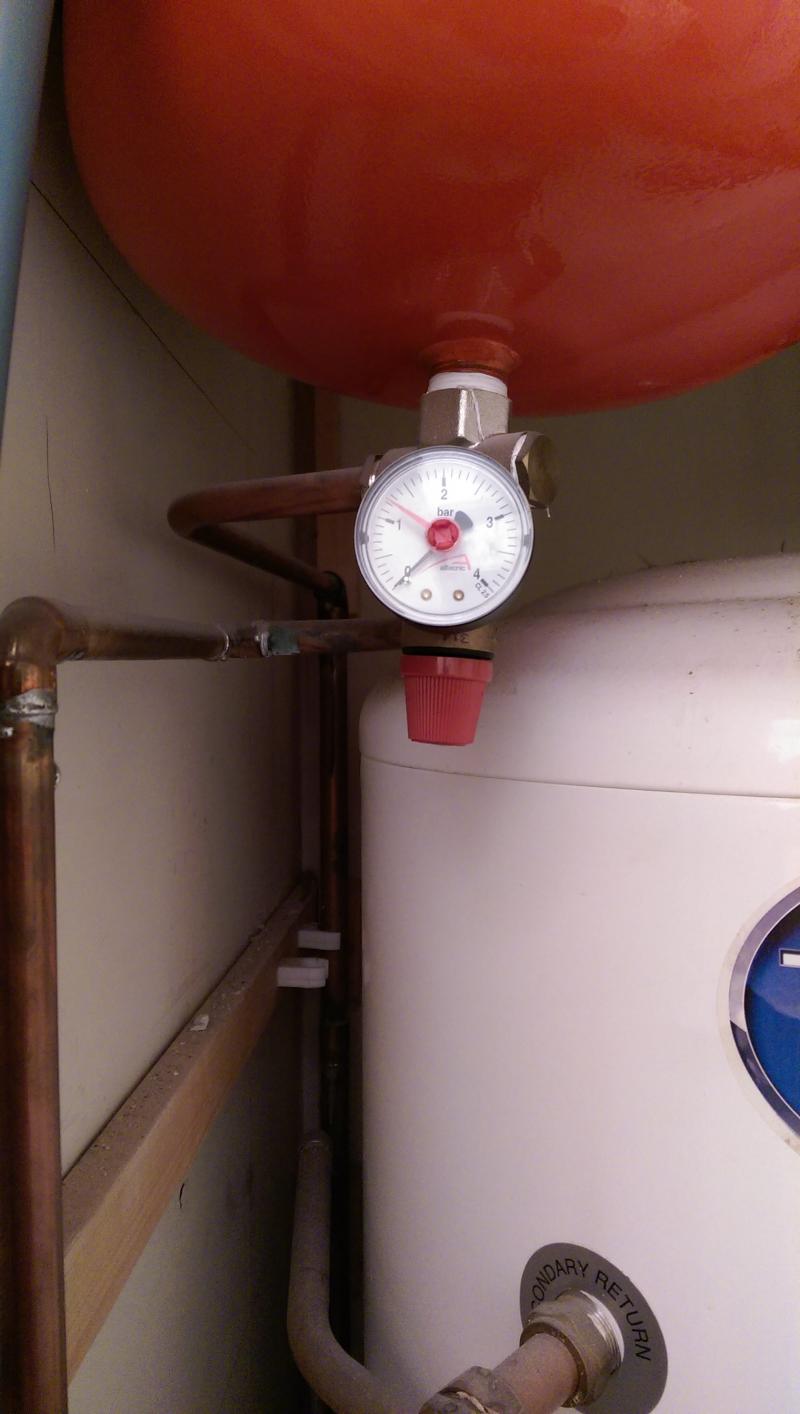

This is a Tribune HE Unvented Cylinder, connected to the boiler on first floor. As you can see in the pictures the heating pressure was zero (gauge under rend tank), which I brought to 1 bar by opening the valve on the re-fill loop.
What is the little white tank do. I read the manual online and seems like that the pressure should come from this unit.
I was wondering if someone could give me some help here, on what to do.
The white cylinder is an expansion vessel. Is the hot water coming out of the taps at good pressure ? Whats the make/model of showers ? Is your stop tap open fully ? (Open full then turn back a quarter turn). Cold water pressure ok ?

So would you confirm that the small white expansion vessel is for creating pressure in the tank?
No the white tank isint to create pressure, if your cold water pressure is ok (and you reckon it is ) then the pressure reducing valve/strainer needs to be checked, thats the valve in your second pic.

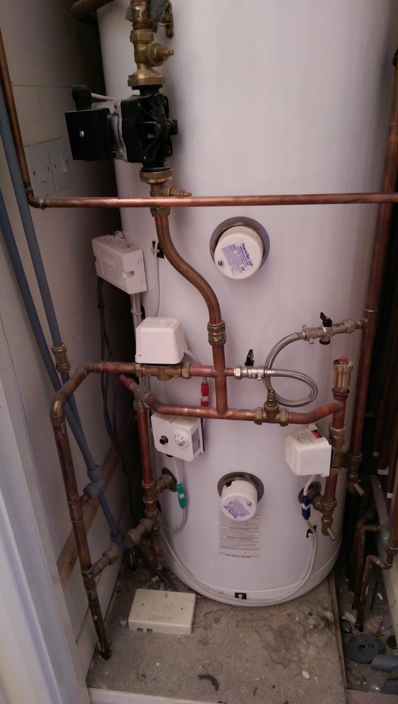

It relies on mains pressure. It will have a pressure reducing valve set to 3 bar ish. Also has a filter. Some of the valve sets have a lever on them, check the valve/filter. There's only so much you can check, you may need a plumber with an unvented ticket.
Looks like the second cylinder this property's had, from what I can see.

The expansion vessel (white) is where the expansion of the stored water in the cylinder when heated through circa 60C is absorbed; it doesn't augment flow, apart from for an instant when a tap is opened.
