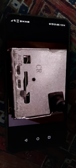

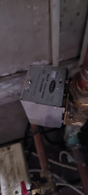

Photos of zone valve attached. I presume it's a three way valve.
Not sure what you mean by 'is the valve indicator showing the valve shut?' When we turn on the hot water we can hear the MPV innards moving and clicking off when we turn off the hot water. It's only a couple of years old. So presume this is working OK.

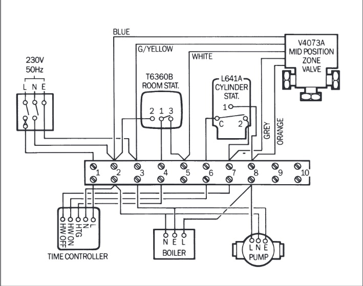

I just cannot see if it's a 2-port or 3 in the photo, 2 port has two pipes (straight through) 3-port has three pipes like a T, but you might have a system using two 2-port valves.
Try this, turn water on as you did above, then try sweeping the thermostat setting on the cylinder from end to end. You should hear a click from the thermostat as you turn it each way and the HW valve should also run open then closed, with each alternate click.
In the main the tank thermostat controls a motorised valve which in turn controls DHW temperature, but not always, with some C Plans the thermostat only does anything in the summer.
So if you turn off hot water at the programmer does the water go cold? If not likely the thermostat is only used in summer, if it does go cold then likely a fault.

If the cylinder stat is knackered, so calling for heat all the time (unlikely) the boiler will be on continuously while the programmer is calling for HW (burner on/off on the control-stat). If that's not happening, good chance the 3-port valve is the problem.
I think either your cylinder thermostat is not working hence not telling your 3 way valve to stop sending hot water to your cylinder or your 3 way valve is not functioning correctly. Plumber or more googling to understand what is what and what you are capable of doing is required
Again many thanks, to everyone helping. We are just about competent enough to replace the MPV or the thermostat, will try and work out which is failing.
I would try from cold, heating demand only, and then when it’s heating up, feel the pipes going to the cylinder, if they’re hot your 3 port mid position valve is stuck in the middle. It wouldn’t surprise me with the cheap valve that’s in.
That will not prove much, as the line will be from the programmer to make the valve travel all the way, so fault could be in the wiring.
Two contacts the made when cold turns boiler on, the made when hot turns the water flow from valve off, so faulty made when hot can cause DHW not to turn off, but has no effect on causing boiler to turn on.
