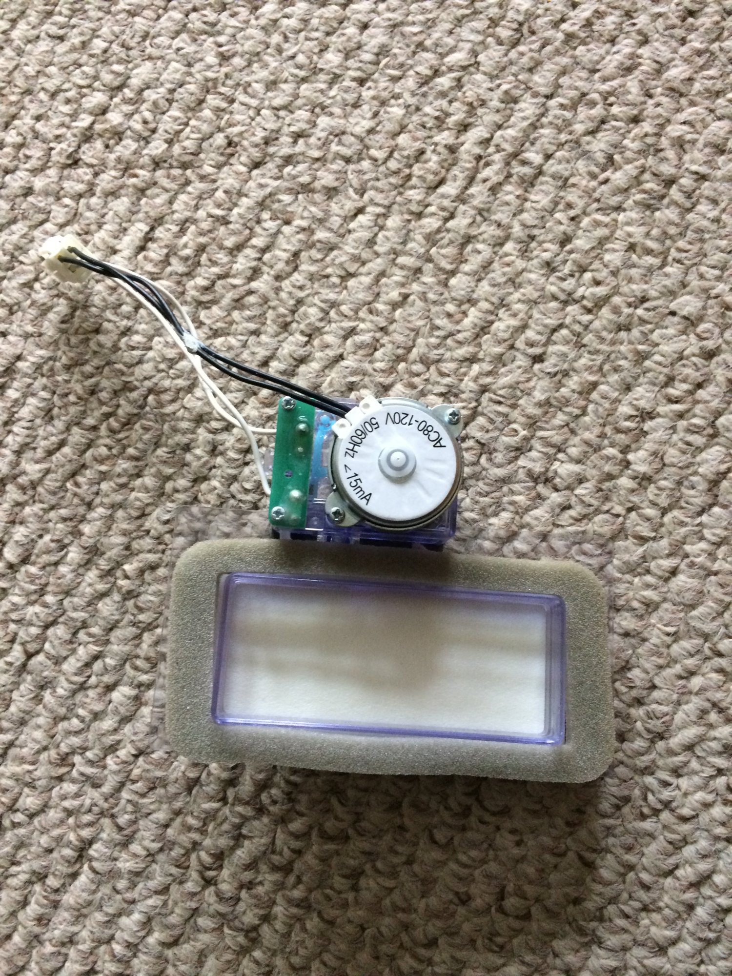

I have a Hotpoint FF200L but the fridge is not going cold.
I notice that the damper in the fridge is not opening by itself even on the self-test. I replaced it but it still is not opening.
However, if I lift the damper flap, the piston comes out and holds the flap open. It seems as though there isnt enough grunt to open the flap on the damper.
Any thoughts what might be causing this?
If I leave the damper off, then the fridge gets too cold and some of the items freeze!

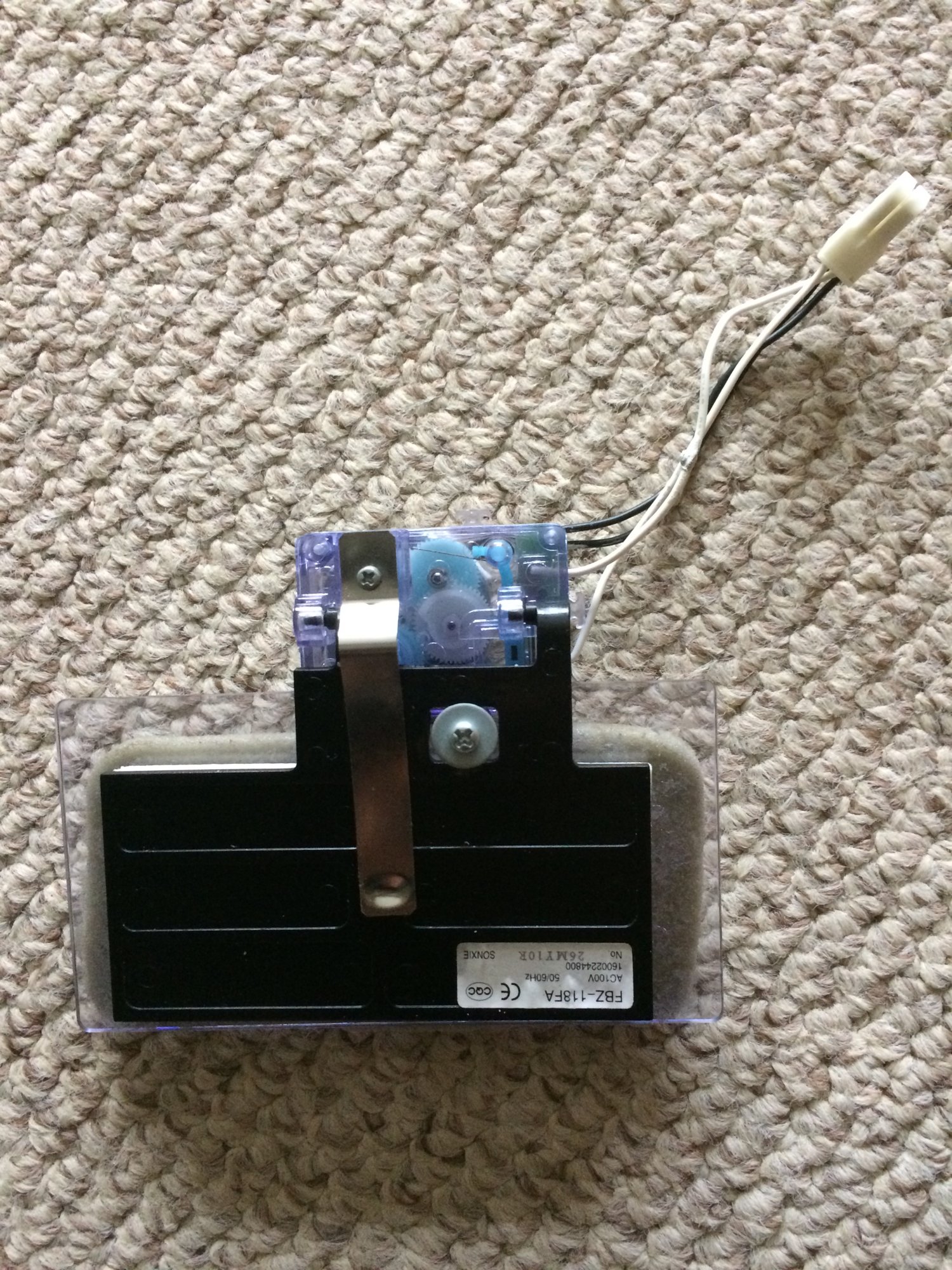

The part number is FBZ-118FA

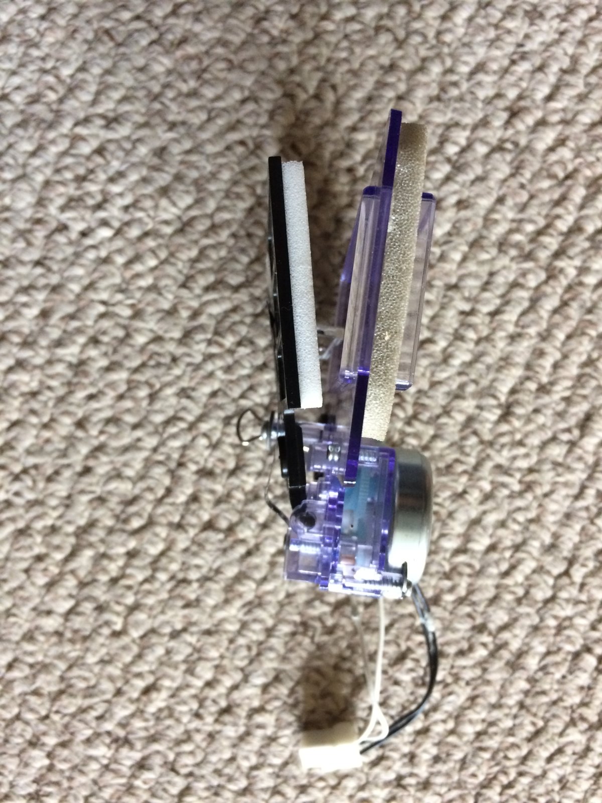

It has 4 wires coming to it from the back of the fridge. Two wires drive a motor, which pushes out a piston. Two wires go to a circuit board.
The piston comes out but only if I manually hold the flap open, otherwise it seems to struggle to push the flap, and thats why cold air isn't coming into the fridge. I suspect that the power comes from the control board, but as I don't have a wiring diagram I cannot be sure. I am handy with a soldering iron, so happy to replace any components if anyone can help with the diagnosis.
The offending part is as follows:

ok so its a combined thermostat and damper switch.
test the switch by applying voltage across the 2 black leads, where are you? in the UK???. the piston should activate and open the flap.
the thermostat needs testing with a dmm for resistance, if its open cct you know its dud.
The thermostat wires are low resistance - almost no resistance.
Not sure where I can find a 110 V PSU to test the motor. But I have the original part and the new part and they both fail to push out the piston to open the flap. The replacement part does push the piston out but only if I help by lifting the flap first. I guess that means that the motor is not being provided with enough power to drive it. Is there anything that I can do to fix that?
Sounds like there's excess friction in the mechanism. Lubrication dried out?
but doesnt explain why neither are working, is the 'new part' brand new?
Yes. The new part is brand new.
I have measured the voltage on the connector where the damper thermostat connects. The connectors to the motor read 90V ac normally, and this goes up to 240V when I put the unit into self-test mode (ie. when the damper opens).
Under load, the voltage across the motor is 1.6V ac.
This doesn't seem right, as the motor on the damper says 90V ac on it, so is the 240V damaging the motor?
Does anyone have a service manual to see what I should be getting?
your 1st photo shows a metal 'plate' screwed to the damper, presumably this acts as a spring to close the flap. is there def one on the old damper?
it isnt a transit plate is it, to prevent damage whilst being installed?
There is a metal plate on the part that was originally in the fridge and there is one on the new part. The part in the fridge was working originally and only failed recently.
I am not sure that the voltage should go up to 240V. I fear that cooked the old motorised flap and will cook my new motorised flap.
