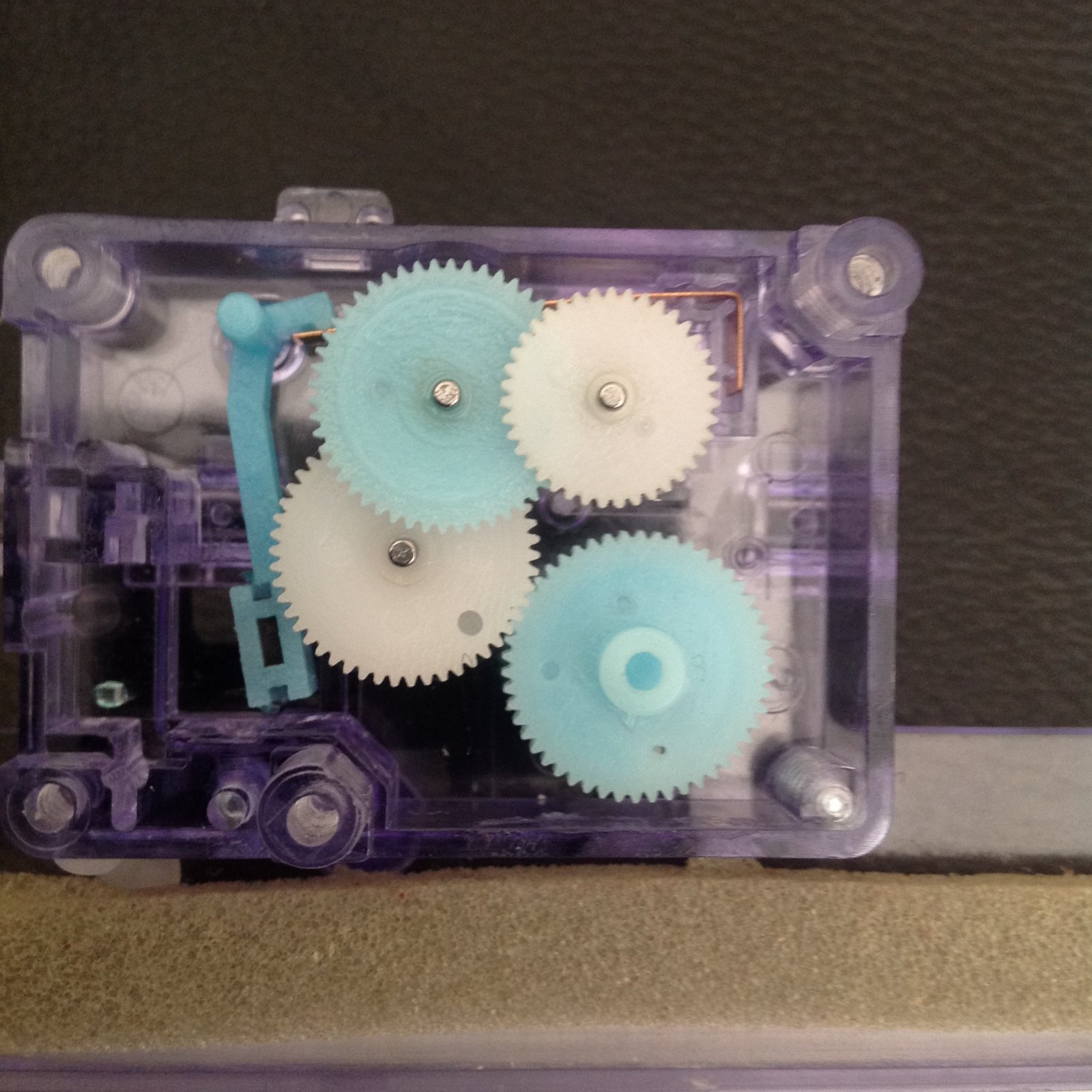

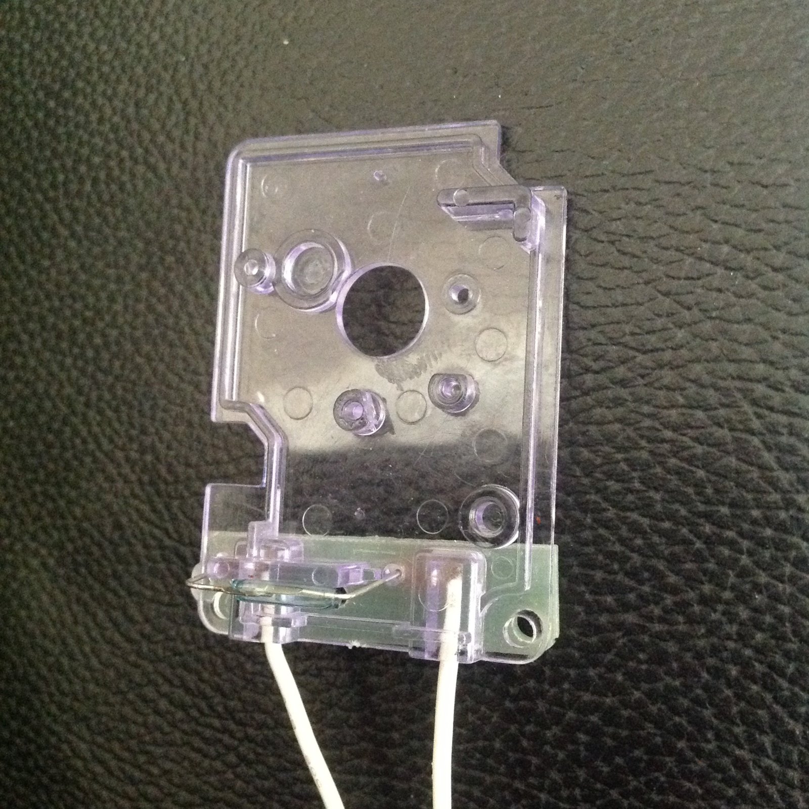

earlier I mentioned its a combined damper and thermostat, looking up the part is confusing as it would appear that its not actually a thermostat but a reed switch.
could you confirm this by connecting your dmm to the 2 white wires and on the lowest resistance setting (disconnected from the ff) and move a magnet towards the pcb on the damper i.e close to where the white wires connect to the damper
if this is indeed a reed switch then it acts as an on/off switch rather than a temp sensor
you are correct - it is indeed a reed switch. it appears that the mechanism inside the damper moves a magnet to the reed switch depending on where the flap is. manually moving the flap does not change the status of the reed switch, it depends on the positions of the cogs inside.
the reed switch works on both the new and old damper units.

so, now we know both dampers are working (assuming you have had the damper connected long enough to see it open/close the flap) we need to establish the voltage on the reed switch, should only be about 12v dc
then unfortunately we need to trace those wires, there is no getting away from it with the absence of a wiring diagram.
once you have found where the wires go post photos so I can see and identify the component(s).
i guess the timer is permanently on/running, at certain intervals i.e when the magnet on the cogs is in close proximity to the reed switch it closes the reed switch (is the reed switch normally open? how often and for how long does the reed switch remain in its active/inactive state?, presumably whilst the flap is closed the reed switch is inactive) completing the 12v cct and operating another device poss/most likely via a relay. the reed switch 12v energises the relay which either turns on/or off a 240v cct, if on - heater perhaps to defrost, if off - perhaps just turns off the compressor so no more cold, as this is a frost free ff it would override the thermostat whose job is to turn on/off the compressor
