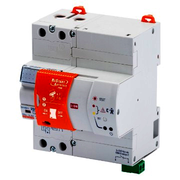

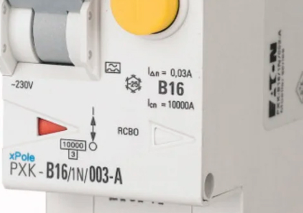

If the RCD has an indicator to say this item is close to tripping X-pole.jpg as with the Eaton X-Pole, then you know when you are sailing close to the wind, and can take action.
We are told 9 mA is the limit to back ground leakage with a 30 mA trip, and the trip can activate anywhere between 15 and 30 mA i.e. 50% to 100% the Eaton X-Pole claims 90% to 100%, but over the years RCD's have moved on, I had considered one of these temprcd.jpg auto resetting units, but latter editions of BS 7671 it seems stopped there use with domestic, and the introduction of type AC, A, F, B and S adds more confusion. Since single module width RCBO's are as far as I know only available as type AC and A, there are likely cases where EV charging or solar panels are used when RCBO's can't be used. The type testing of the consumer unit is only valid if using recommended items in the unit, so we are not permitted to mix and match with domestic.
Also from experience I have found early RCD's could fail due to strain on the housing from the connecting wires, so the unit should be tested after being fitted, but the instructions say it should be tested when no circuits connected, add this to manufacturers instructions that the time to trip is only valid when tested as a type AC, yet we see a selection on the tester for type A, or more, the whole situation is rather unclear.
