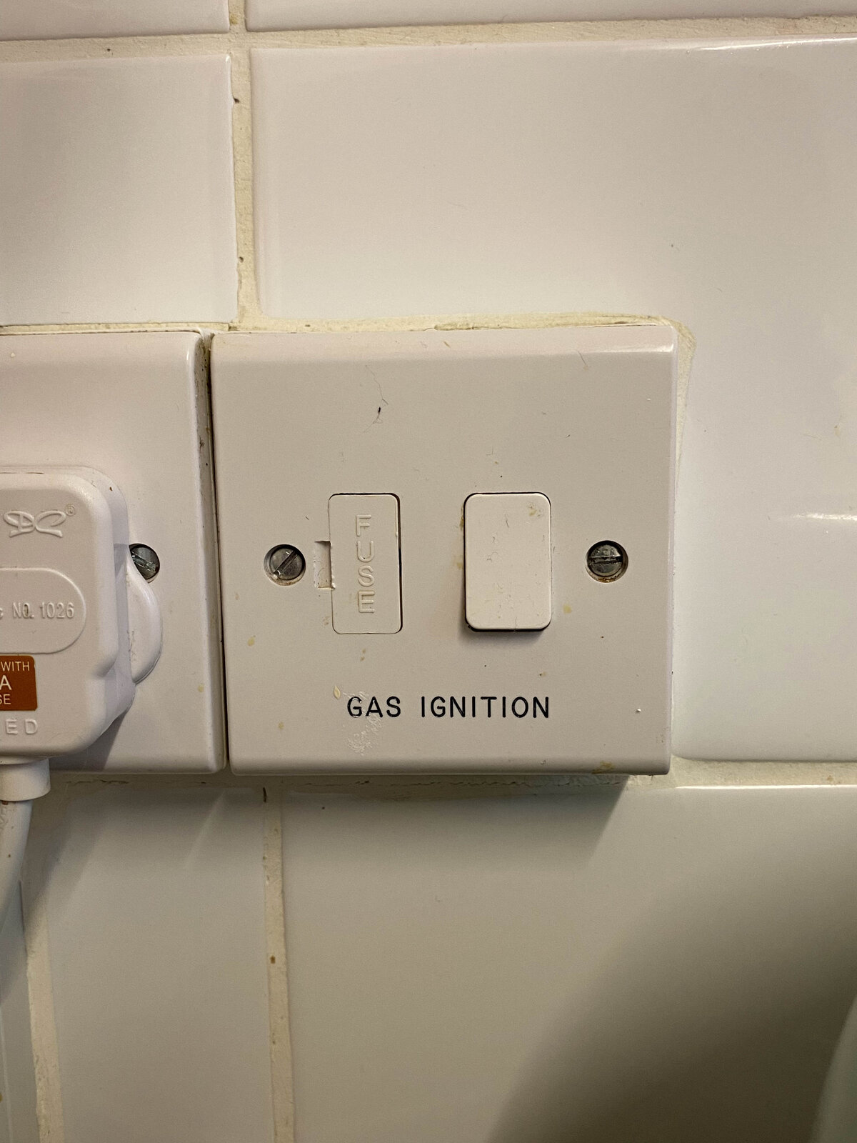

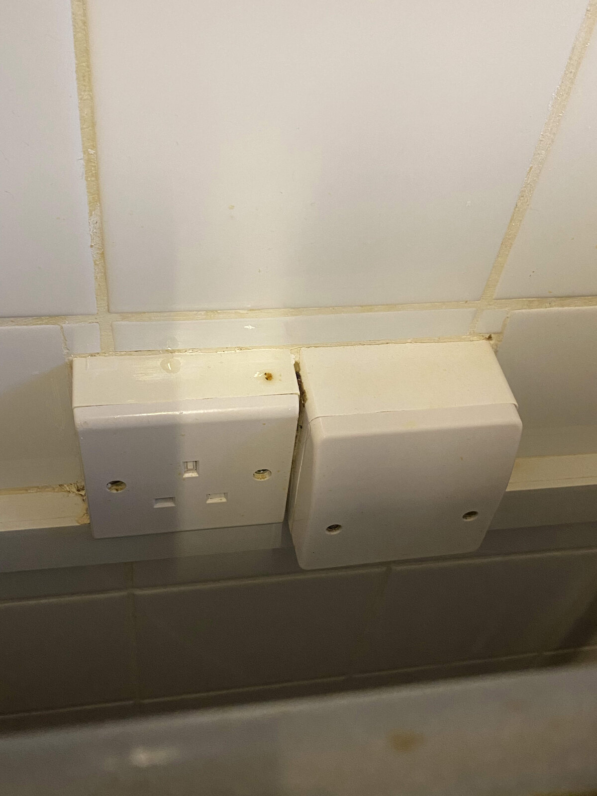

Here is a photo of all the bits and pieces involved with the cooker. Apologies for the cleanliness of these, this isn't my kitchen, I'm simply doing a favour for somebody.
I've unscrewed all three of them and had a peek but everything seems to be in order to my untrained eye. Could the fault perhaps be here?

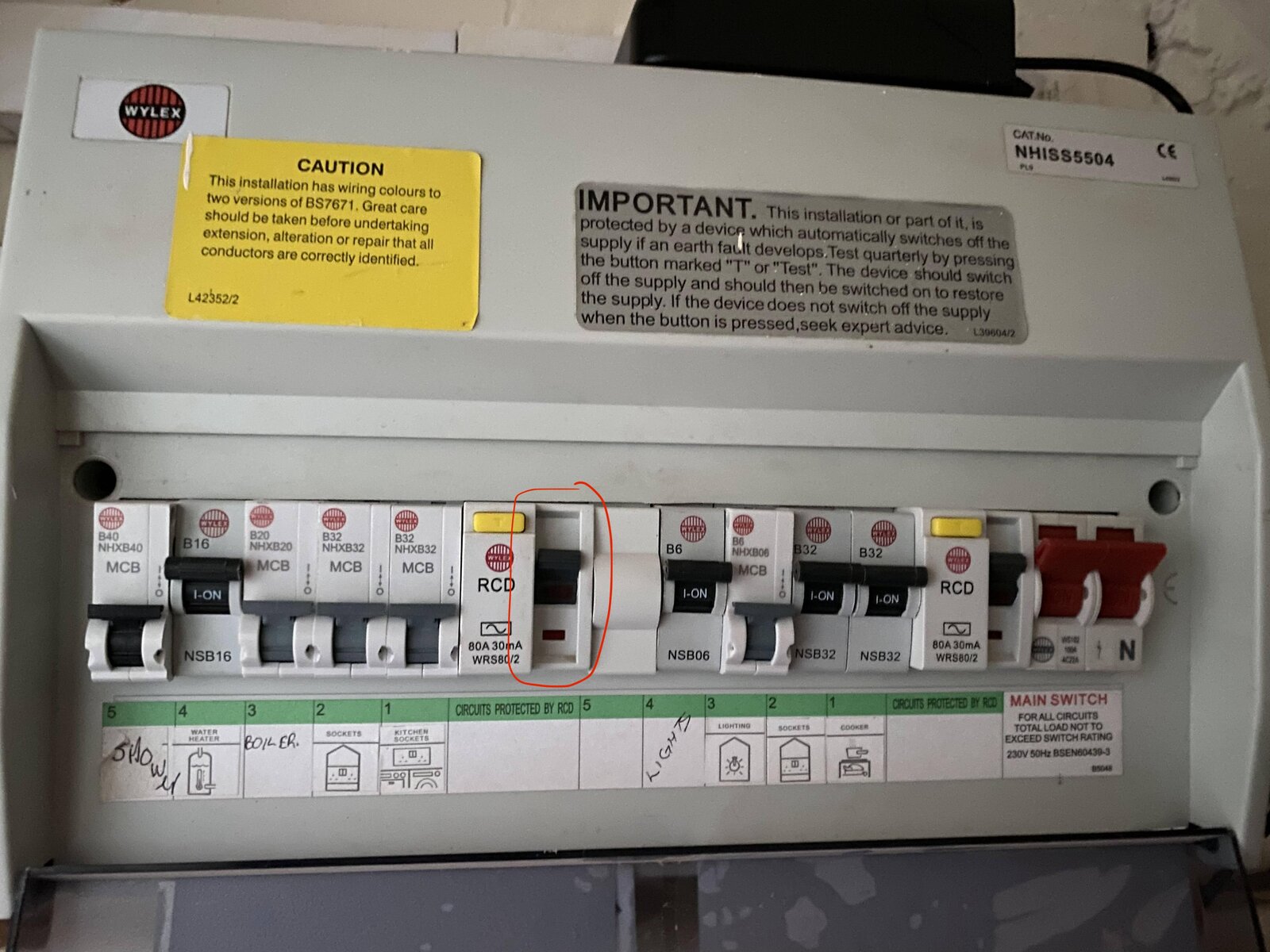

Here's a picture of my breaker panel if it helps at all. The switch outlined in red flipped to the down position once the cooker was turned on.
I read a reply to a similar issue on another forum asking them to plug it into a 'non-RCD way' as these elements "can absorb moisture if not used for a while", I'm assuming this means just plug the cooker into an ordinary socket and see what happens. Should I try this now?
No point but you can if you want. Looking at your consumer unit all your circuits are RCD protected.
Did you check that all clamping screws were tight?
That's what I meant.
If all is ok and other appliances don't trip, it's definitely something wrong with the cooker.
I would eliminate simple things like plug wiring, damaged flex wire and internal connection.

That is a wrong assumption to make. As I think I said earlier, an RCD can be caused to trip by either a live to earth leak, or a neutral to earth leakage.
Most appliance switches, switches on the actual appliance, normally turn the live off, but leave the neutral connected. I suspect that switch on the wall in the photo adjacent to the socket is a double pole switch, hence turning that off cures the trip.
