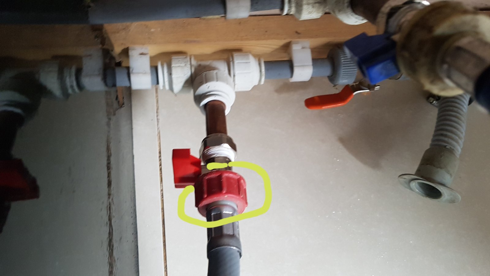

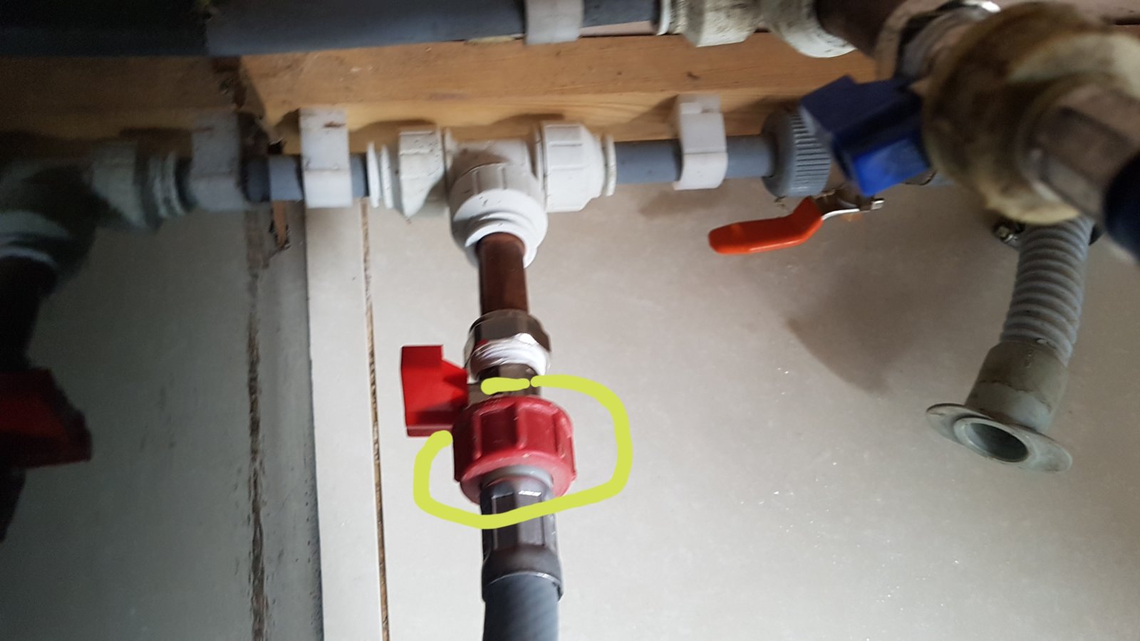

I've disconnected the drain hose from under the sink no problem. But I can't turn the red wheel to disconnect the hot water pipe.

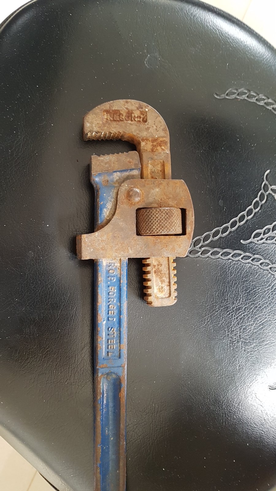

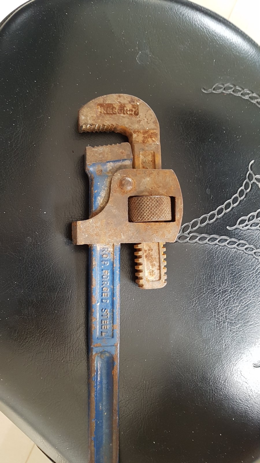

Also, I just found out that turning the longer red lever to off stops all hot water to my sink, so I just needed to turn the smaller red valve next to the wheel. Thing is, I can't undo the red wheel by hand as it's too tight, and I don't have pliers wide enough. I'll need to buy some when I get a cap, probably from toolstation. Can you recommend me a pair of pliers or a tool I'll need to undo that wheel?

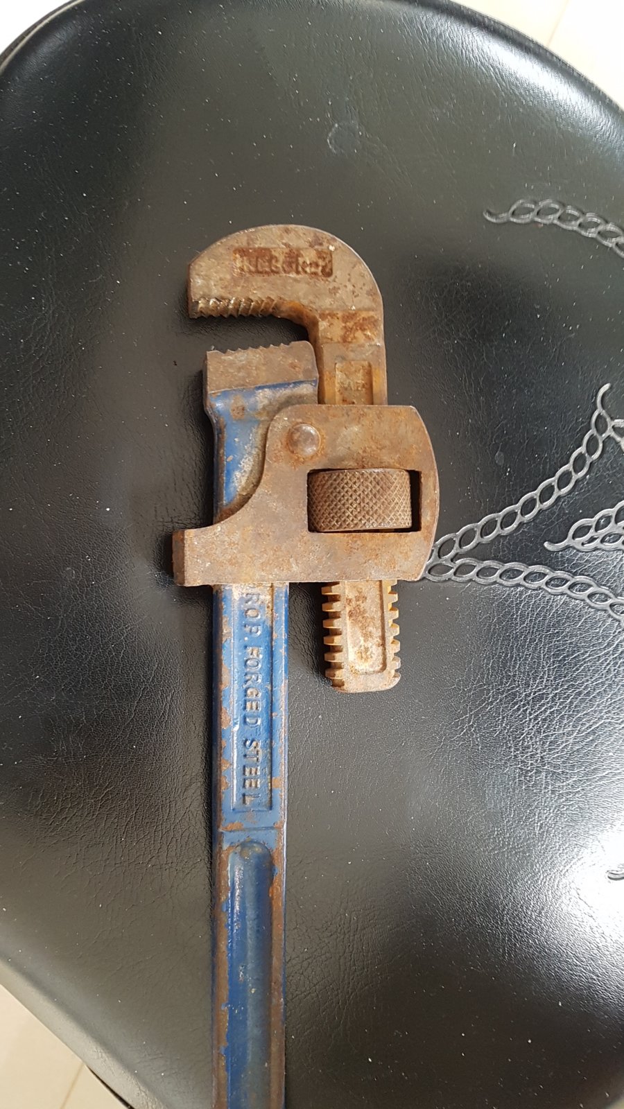

Scratch that, I just found my old pair of adjustable large pliers that I forgot I had!
Those are called 'stillsons'
Ah, thank you.

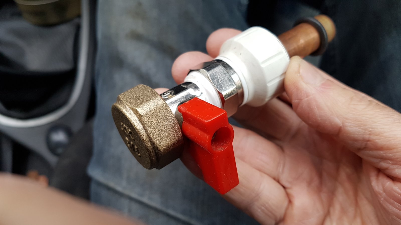

Well I managed to get the wheel off, and the one for the cold water. I took the whole valve attachment off to get a better grip and torque on it. So I'm all ready now to connect the new Samsung machine which I've just bought from Currys and it's coming Tuesday. :)
I bought a 3/4" brass cap for £1.12 from toolstation and it seems to fit the valve perfectly. That said, the red valve lever can still be moved a few millimetres and that allows water to come out, albeit not shooting out like a jet of water as it does without the cap. So it's an improvement but not totally foolproof. Not sure if that's normal or not.
