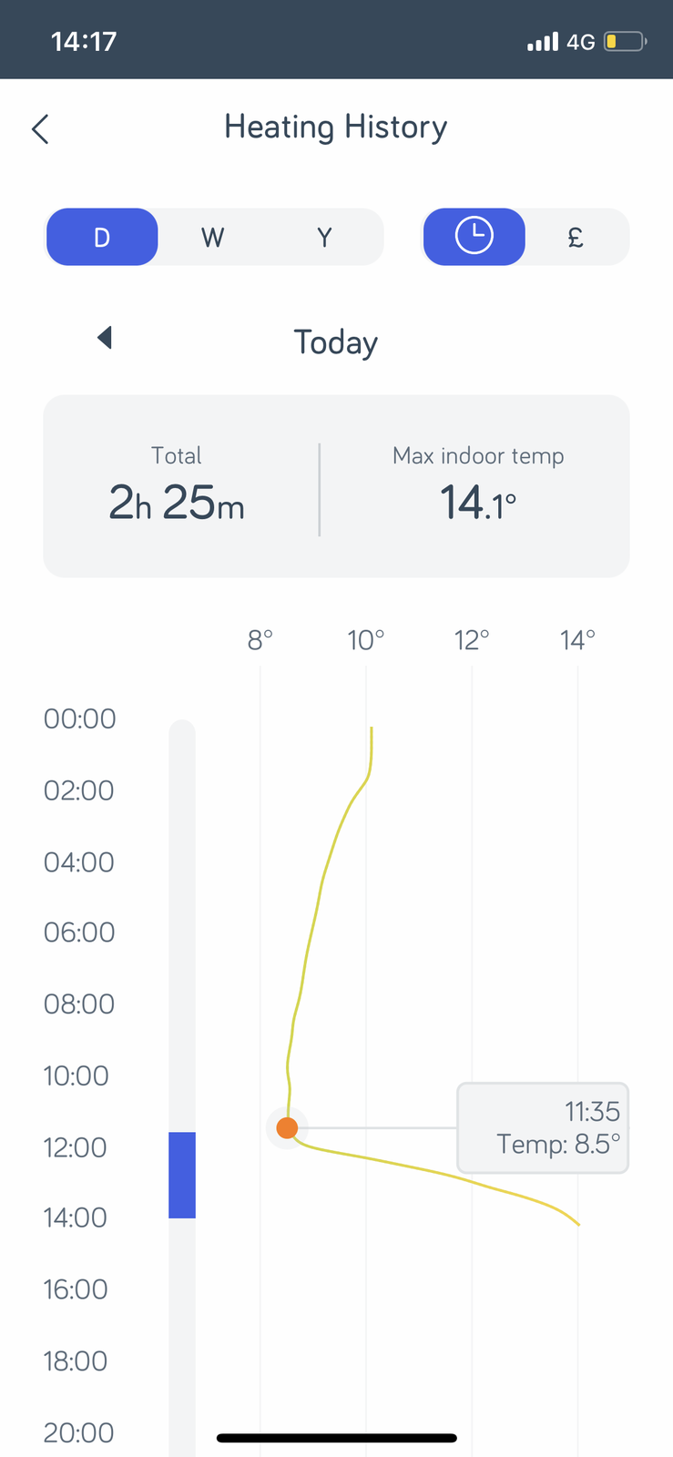

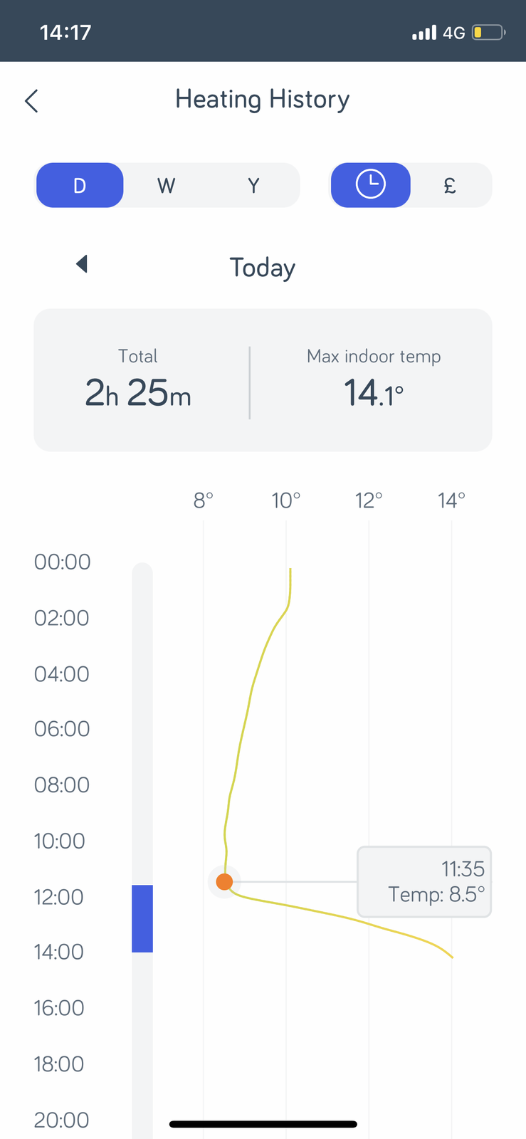

I've noticed the landing floor is always cold, so I lay down on it earlier today and I can feel a slight cold woft of air and have noticed some fabrics on the stairs moving round a bit as if being gently blown by wind, the wife think's its just convection of air but im wondering if its a draft on the landing somewhere. Pic below (thermostat in purple)
That appears to be quite a dramatic drop in temperature, however is the record from that thermometer marked in purple? The reason I ask, is that it appears to be mounted on an external wall, which is the wrong place for a thermostat, or to record the general temperature. It should be operated fitted to an internal wall.

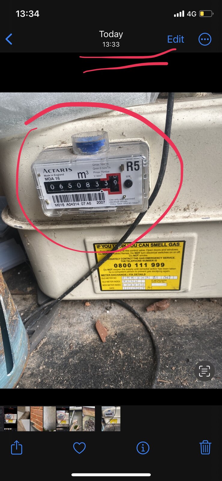

Do you mean your boiler constantly runs at maximum power? That would be rather unusual.
Have a look at the meter, and see what you really use.
I have, certainly what we were billed last month in the cold snap added up to what we thought we’d used. It’s an older meter measuring in M3. I’m measuring now and will post the photos in reply to this in an hours time or so. Last time I calculated it it was costing between £4.50 and £5 per hour when it was on. I don’t know how much of its power it decides to use. Just how many M3 it consumes when on.

Yes I’ve purchased a bunch (7) of those digital thermometers and have been looking at each to try and ascertain which rooms are getting coldest soonest post turning the heating off. To be honest they all seem to drop at a similar rate, top floor quickest, middle floor next, bottom floor slowest. But say I measured them all 5hrs after the heating being off, I’m talking a difference in maybe a degree, maybe 1.5. Between top/middle/bottom floors

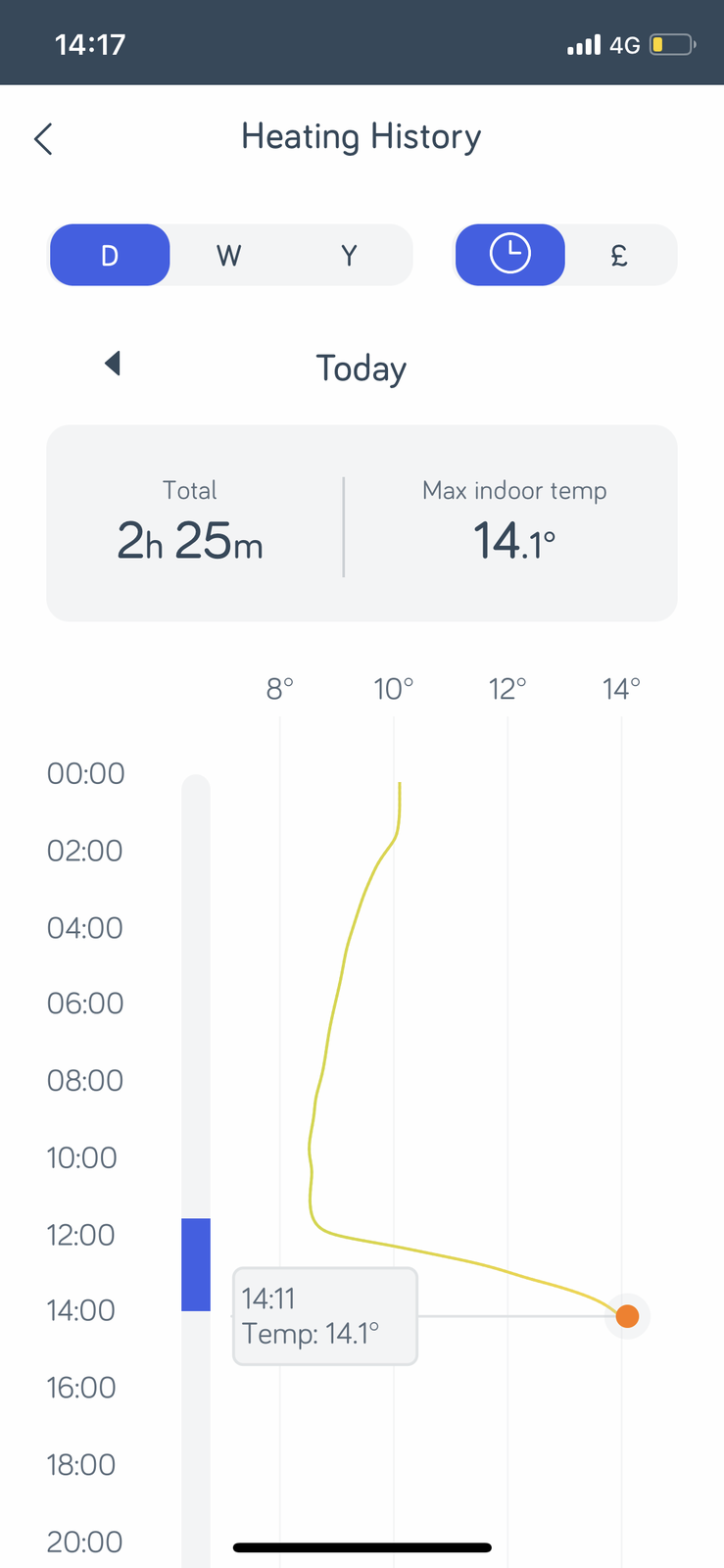

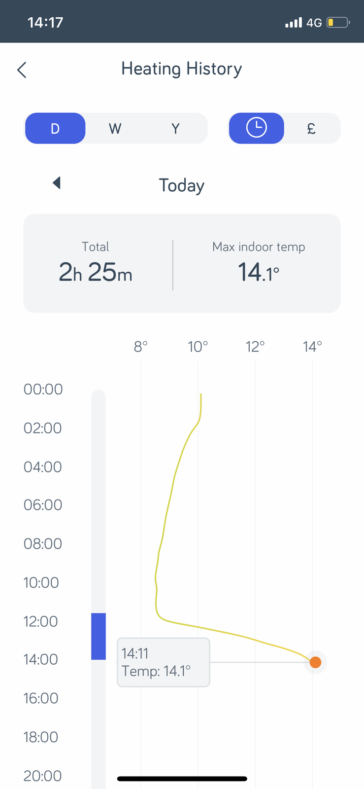

Yeah, I’m not overly surprised by that. To be honest it’s more the rate of which the temperature is dropping house wide is what first made me think there’s an issue. I’ve got the heating on now for a couple hrs, I’ll show it’s rate of rise and fall through the day later (I’m currently silicone sealing all the gaps in the skirts, hoping that will help the drop rate!)

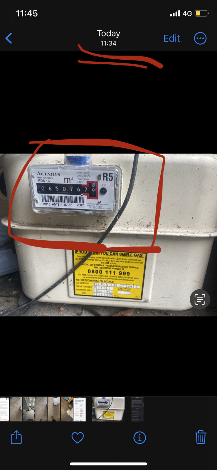

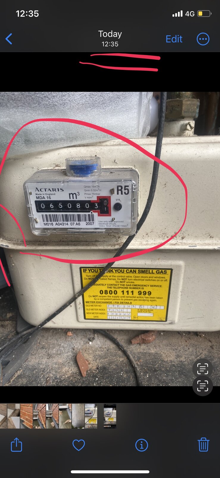

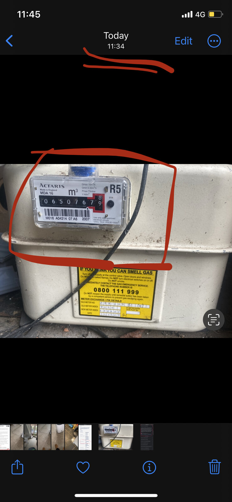

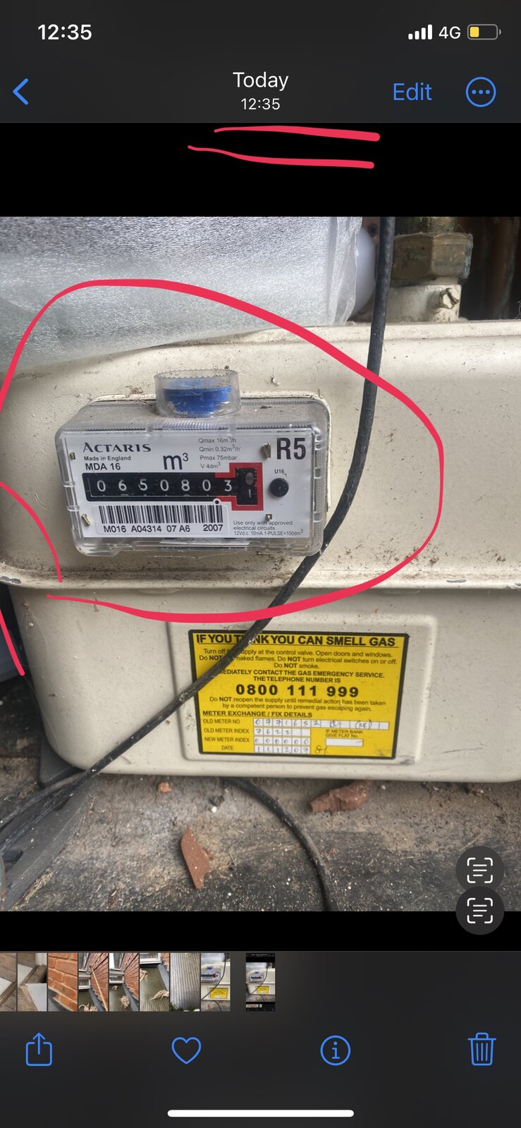

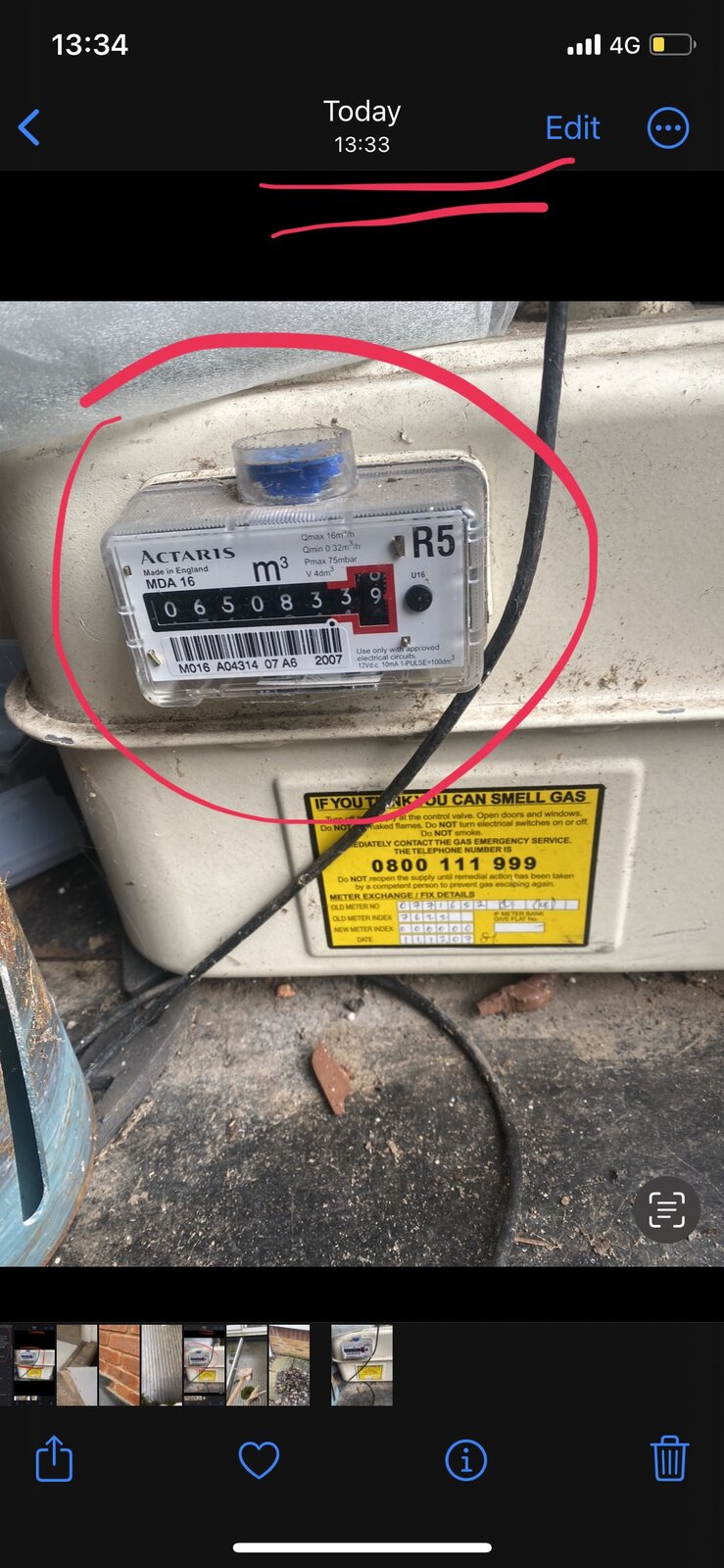

See attached, readings in m3
11:34AM - 65076.79
12:34PM - 65080.31
13:34 - 65083.39
25E50F5A-9204-45AD-B858-B7127854DB2D.jpeg6EC404FB-7462-4500-8C2C-B48FE74A82B9.jpeg96233915-5D66-4771-9EFB-6E8B96C3F6B8.jpeg
First hour we used 3.52 m3
Second hour we used 3.08 m3

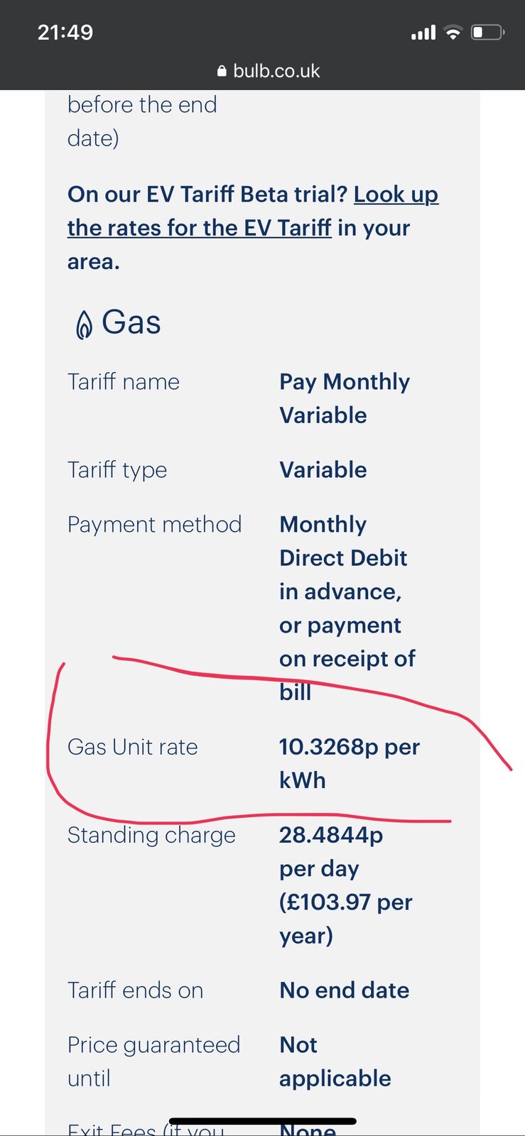

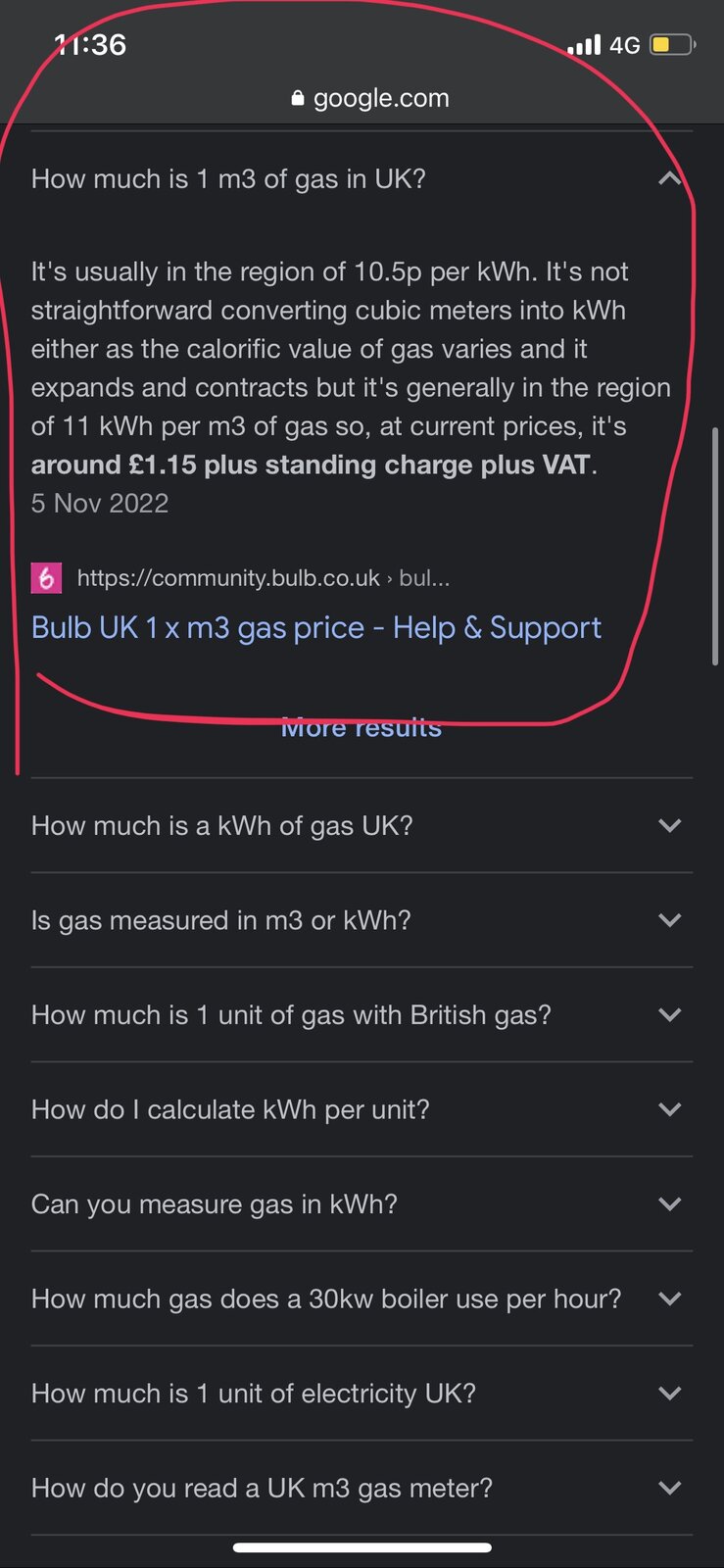

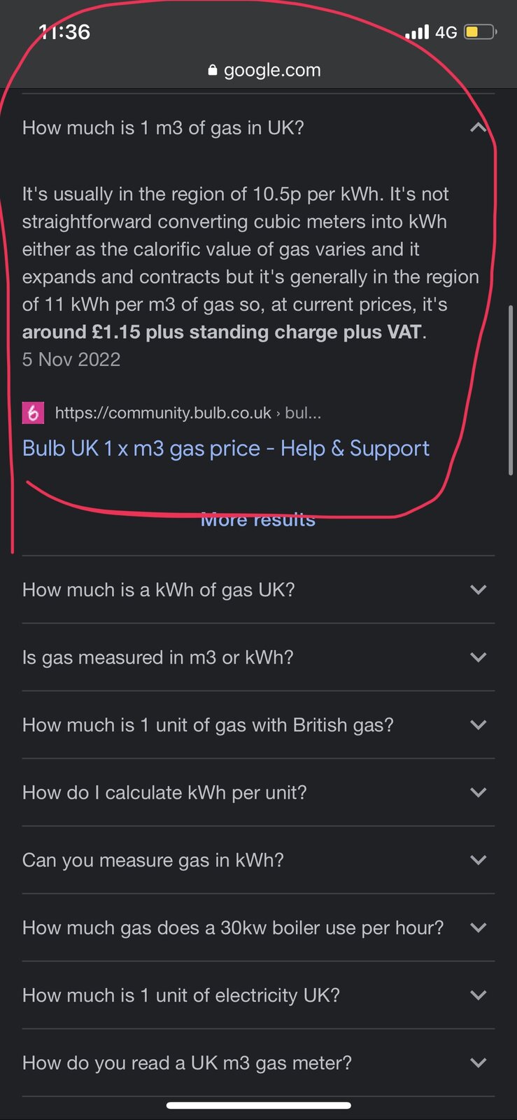

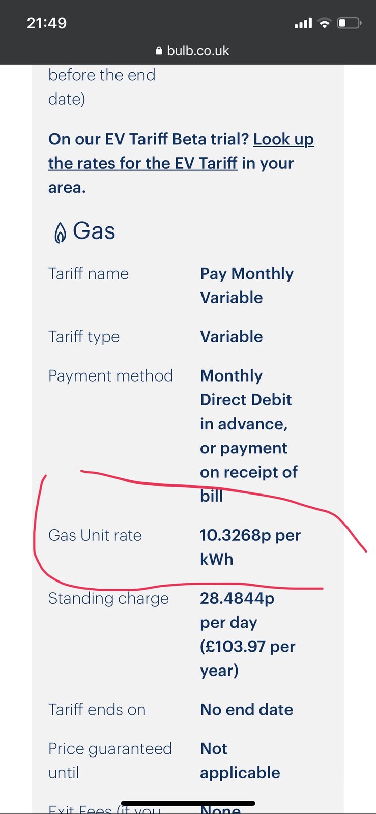

We’re with bulb, so using their conversion figures / cost
1m3 = 11kwh,
10.3p per Kw hr
First hour cost = (3.7 X 11) x 0.103 = £4.19
Second hour = (3.08 X 11) X 0.103 = £3.49

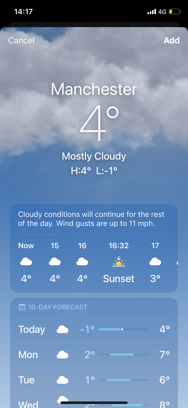

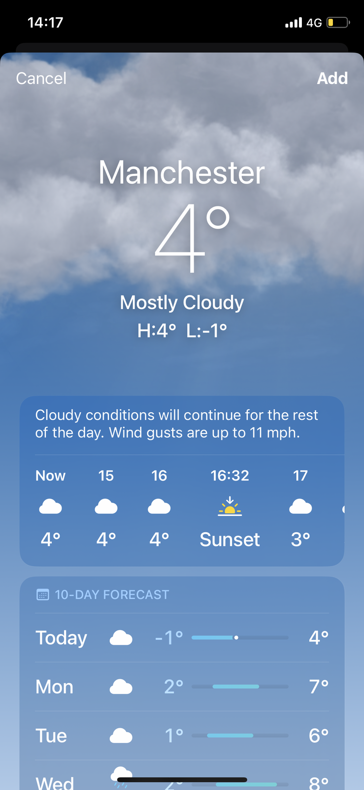

So you're using over 30kW, which is more than double my house, with a 20C difference, when maintaining temperature and the walls are warm.
What is the difference in temperature inside and out, where you are?
How sure are you that all the walls have CWI?
Currently 4/5 degrees outside. 14 inside (after having the heating on for 2.5hrs, was 9.1 inside this morning when I woke)
