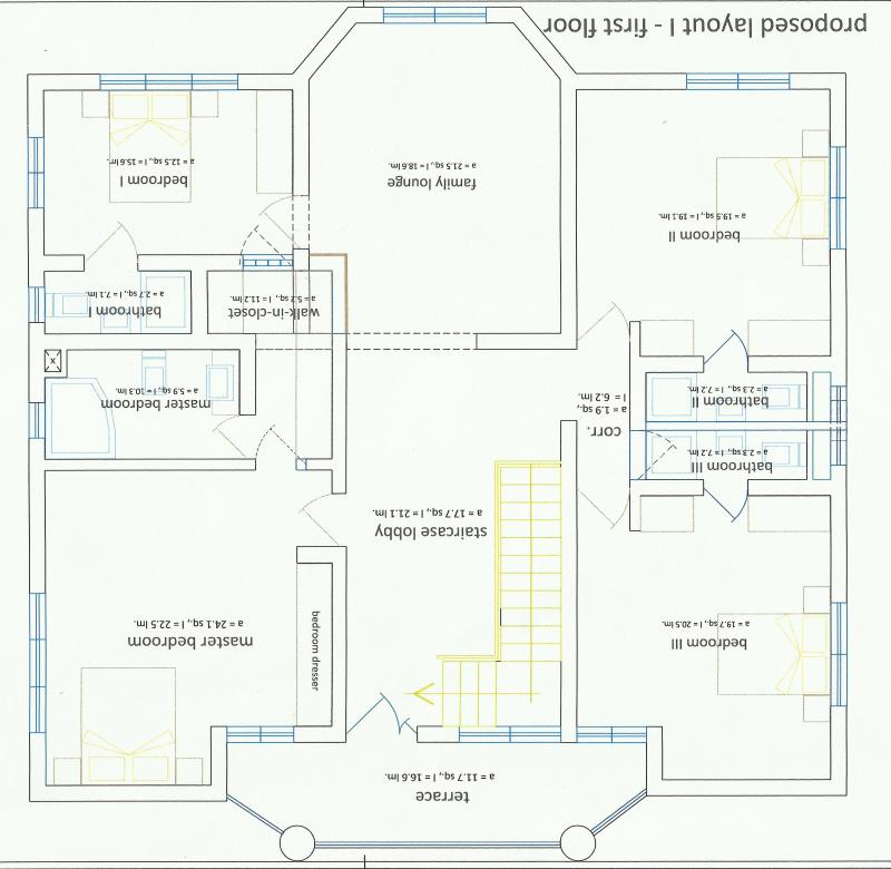

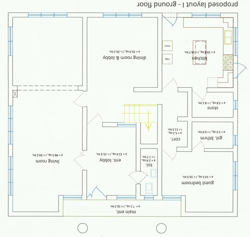

Hello,

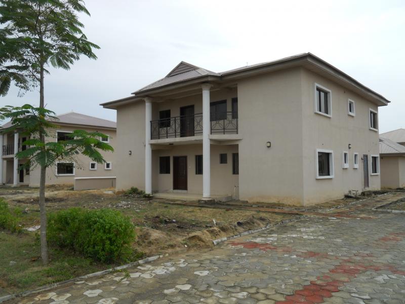

I am a structural engineer managing a house renovation project in Nigeria which involves gutting out most of the existing interior and replacing. This will include all electrics.
It is a simple 2 storey house, with concrete block construction.
I am intending to use local electricians for the installation work, but I would like the design to be to UK Standards and current IEE regs.
I have floor plans and interior design drawings, and would like some help from someone suitably knowledgable for:
1. Duct and Conduit Layouts
2. Cable sizing (incl. calcs if required)
3. Circuit Design and Layout, including Consumer Unit sizing
I am based in Waltham Cross, Hertfordshire, so if anyone is fairly local to look over the drawings and chat about the design, that would be perfect.
I will of course be happy to pay for your time. Please leave a message here in the first instance.
Thanks in advance

I appreciate that some regional effects will come into play, but I would like the basic infrastructure to be to UK standards, even if it is a slight overkill.
1. Yes, there will be air-conditioners, but should these ideally be on a ring circuit or individually wired from the Consumer unit?
2. What size cables to use for socket circuites, and which cables can run in the same conduits? how many conduits do we need to provide in the internal walls, etc
3. Should the lighting circuits be "loop in" or "loop at switch"?
4. Can the electrical circuits be split into 2 groups, one of which would have a generator / inverter back up supply?
These are the sorts of questions i would like some help with, so perhaps I was putting too much emphasis on the "UK Standards" aspect.........
cheers
