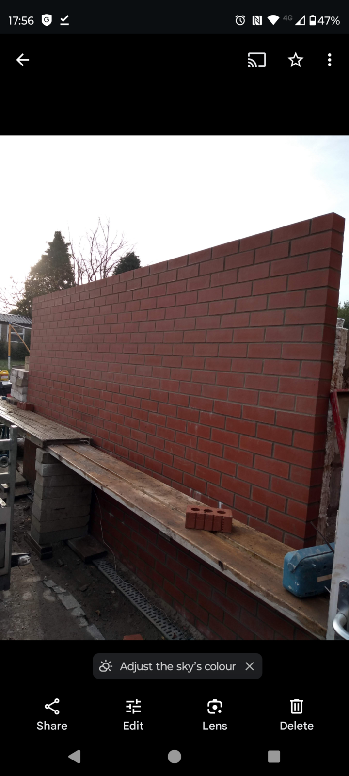

Here's pretty much my first attempt at "Brickie-ing":

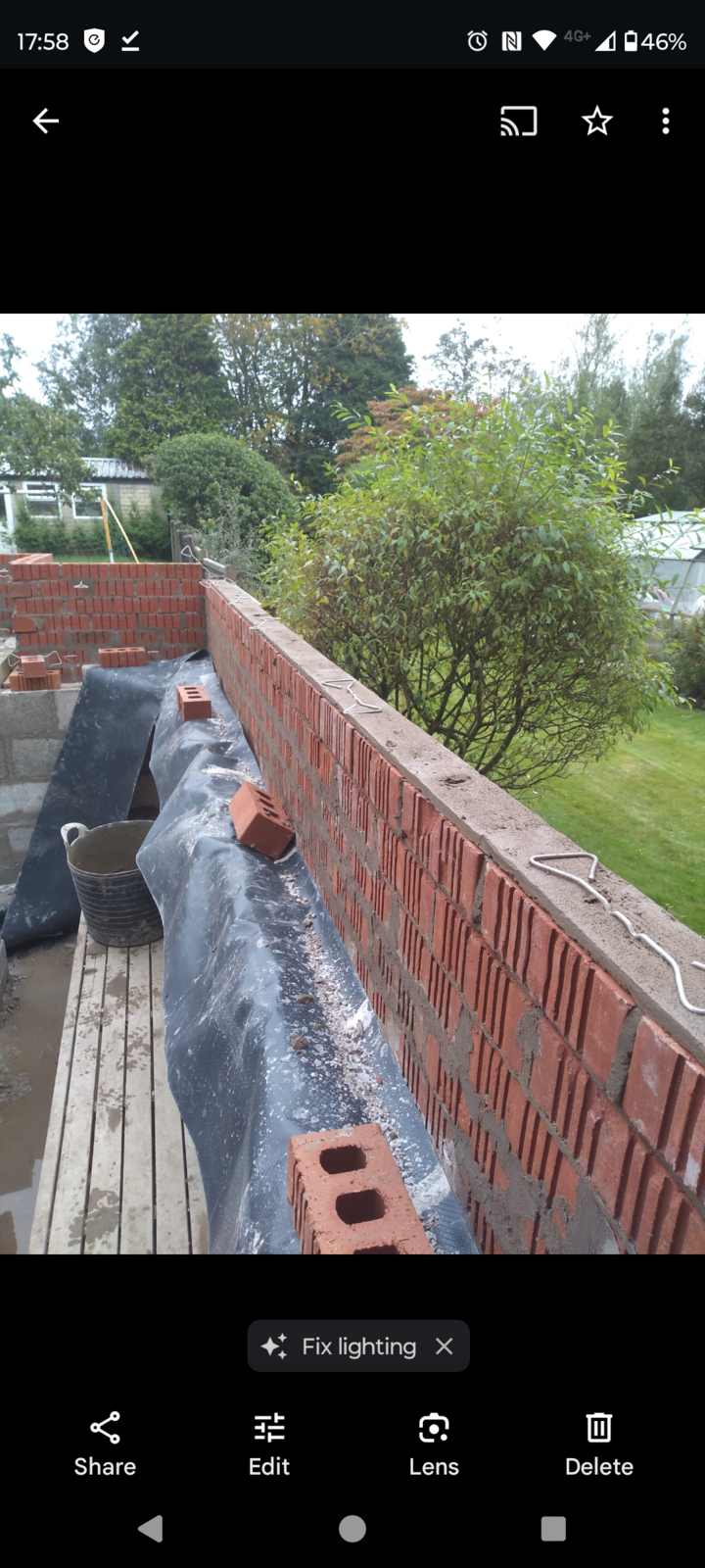

As said, as you don't really push (or bash like us amateurs) the bricks down it could potentially be weaker but I don't think it's significant as the frogs are filled to prevent any lateral movement.

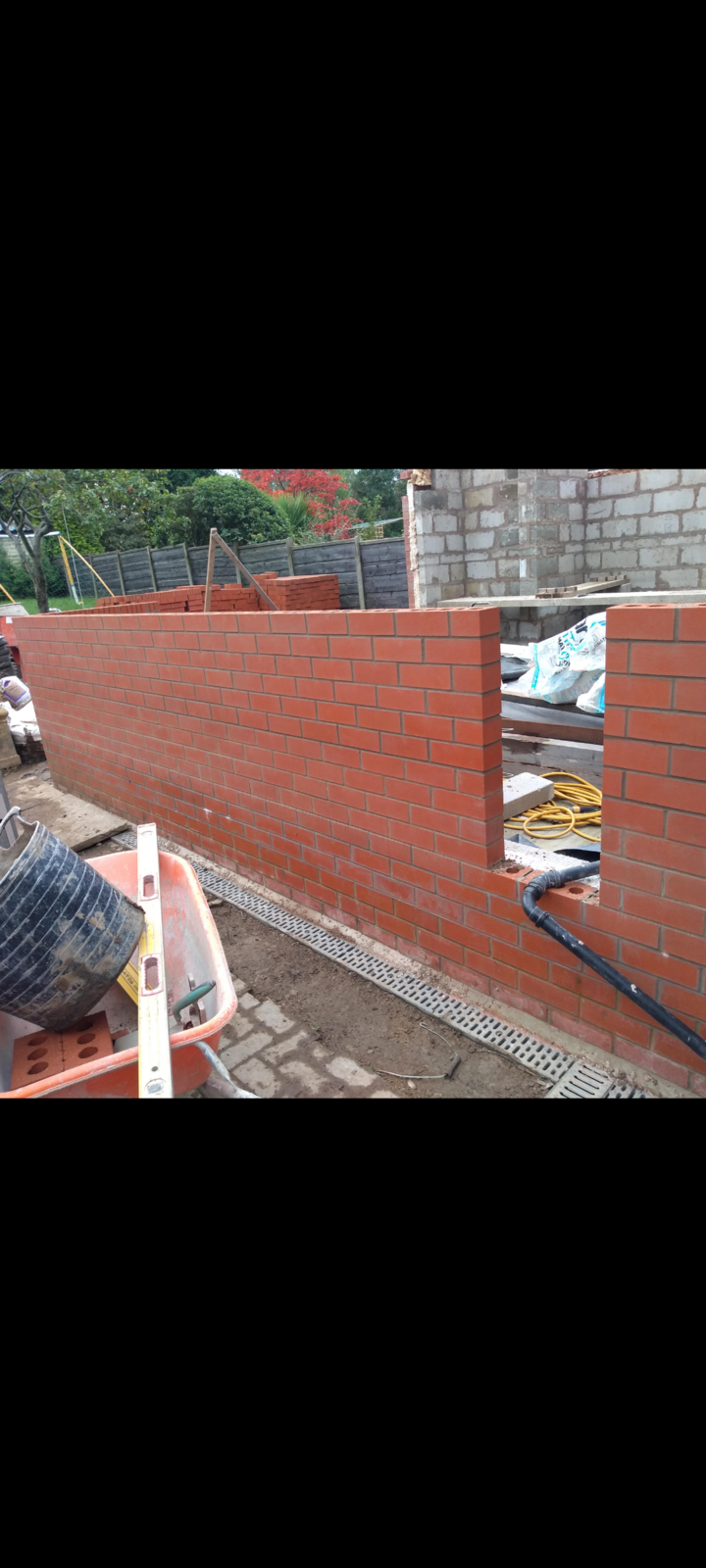

Not that it mattered but I was surprised how slow I was with it, even when, on a damp and cloudy day I could lay a 5m long mortar bed in a couple of minutes:
I doubt the Brickie saves any time, it looks like a right load of messing about to me. It will be weaker and those joints look fine on the photos but I'm sure will be as rough as a bear's arse up close and don't shed water as a tooled joint would.
The tooling makes it neater but also compresses the mortar, sealing the surface and strengthening it within.
The people who use one probably haven't tried freehand without so can't really know whether it's saving them time and effort or not. I'd suggest not.

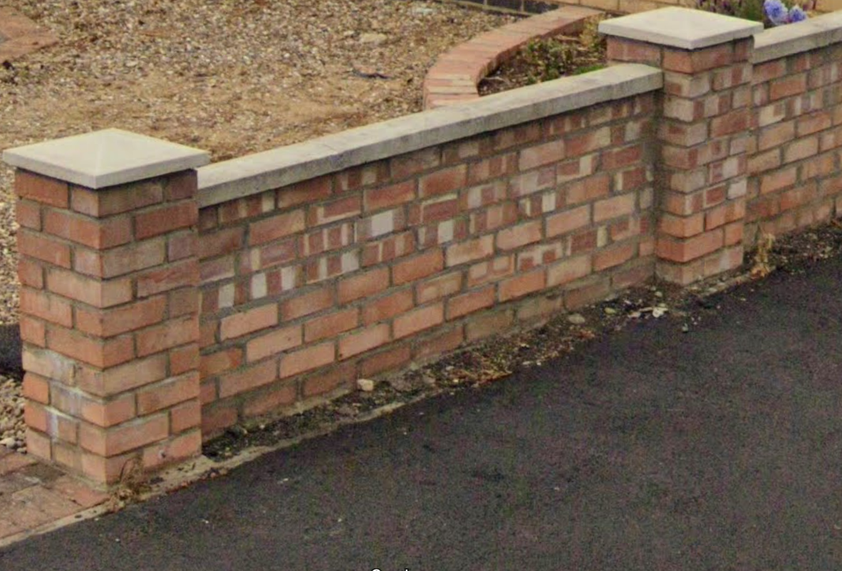

I had our front wall done by someone more talented, it needed weatherstruck as that was how it was done originally and it's a good way of covering up knackered bricks.
I did the side walls, bucket handle and it looked fine. But not as good as the front. But probably only because the bricks were a bit rubbish.
