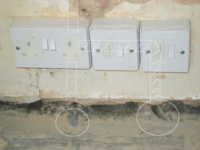

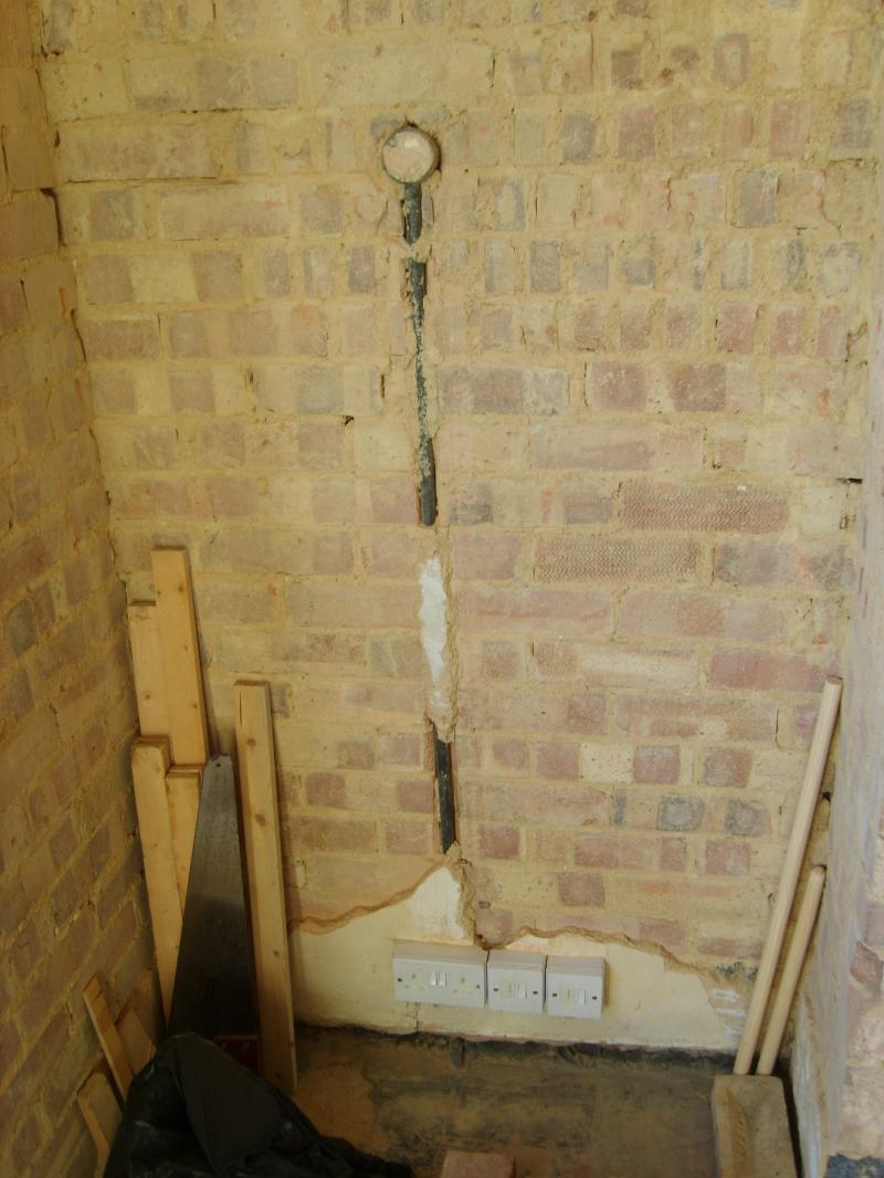

The 1st picture below shows both conduits were I have removed the skirting board. I took those pictures before commencing work as it would have been difficult to see what's in the metal box as the cables and choc box come out of it. I have drawned hatches on the one that has the cables in it which passes behind both FCUs. The conduit just below the socket ends at the bottom of the metal back box but starts again at the top of the box. The 2nd picture (which I sent on one of my thread before) shows the conduit starting again from the top of the metal back box, but now I know there are no cables inside that tall conduit (and the one below coming out of the screed). But I have no idea what was the purpose of it, I just discovered it when taking the plaster off the outside wall.
So the only cables there come from the RH bit of conduit which comes up from the floor?
How many cables?
How are the 2 FCUs and the socket wired?
What is connected to the load side of the 2 FCUs?

Mains cables from the RH conduit to the socket: 2 x 2.5mm L (red), 2 x 2.5mm N (black), 2 Earth
Probably not the best connection. The socket is then wired with an additional cable to feed the FCUs, in total 3 Red, 3 Black, 3 Neutral. The FCU in the middle was for a wall light which I took off, it never worked for some reason. That FCU had 2 L, 2 N & 2 E into the IN terminals to feed the RH FCU, then 1 L, 1 N, 1 E in the OUT terminals for the light. The RH FCU had 1 L, 1 N, 1 E in the IN terminals, then 1 L, 1 N, & 1 E in the OUT terminals to connect electricity to the outdoor garage. All cables 2,5mm thick, fuses in the FCUs were 13A.
As above, a wall light for the middle FCU, electricity to the outdoor garage for the RH FCU. All I will then have is a 2 gang socket and 1 FCU for the garage.

Is the conduit with the wiring in it metal?
It does seem unusual for metal conduit (if it is metal) to not join directly to a metal back box. The metal conduit is fixed to the metal box to maintain earth continuity.
The box you describe with threaded holes in each box sounds old, early 50s or older. The conduit looks old too. Presumably the wiring is much newer, perhaps the age of those surface sockets.
Send pictures of where the conduit with the wiring meets the back box, and we may be able to help you to decide how the conduit should join with a new back box.
As ban indicates, it may be just a conduit with a rubber end cap meeting up with the box, but this isn't typical.
The conduits are metal. The house was built in the late 40's and was rewired possibly in the 60's according to a neighbour but this isn't sure. I may have to leave surface mounted boxes, after having thought about it because to replace a 2 gang metal box from a 1 gang I would have to break some of the hard brickwork because the plaster is not deep enough. That's how all original back boxes and conduits are, into part of the brickwork to accomodate them before using plaster and that's probably why when the house was re-rired the electricians though it could have been too much work to drill and brake into the hard brickwork, I suppose. I will try and see if I can take a picture though the box is seems slighly smaller than normal and I've got all cables surrounded with temporary seath and insulating tape and the choc box coming out of it at the moment.
Stitch drill where you need the hole to be, reach for your bolster and club hammer.
Won't take long.
Yes - sadly there are too many people around who are too lazy to do things properly.
I wouldn't say it was lazy to fit surface fittings during a rewire though.
If out of date back boxes are present, and no one wants to redecorate, this is of course the norm.
So many post war council houses in metal conduit were re-wired in this way.
