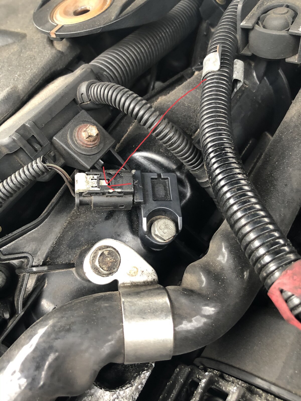

How do I pull off the sensor clip from MAP sensor on my BMW?
16 Jun 2013
58
West Midlands
I’m trying to replace the MAP sensor, taken a pic of it. It’s so easy to swap for a new one as it’s on the front of the inlet manifold and just needs one nut out and then pulled out. But the dayumm sensor clip is not coming off. I pulled that grey tab backwards and it clicked in to that position, but I still can’t pull it off, tried some gentle prying too but didn’t work. Is there something very obvious I’m not doing? I’ve taken a pic of it.

Does that part of the grey clip push down or lift up and then you give it a little wiggle/pull?
Thanks for the reply, it could be, because I’ve had a look at the new sensor and it does have a prong type of thing in that area. Just don’t want to break anything as these clips are notorious for tgat
Just tried that, still not budging, there is a tiny bit of back and forth movement between clip and sensor but that’s about it

It’s in that link I posted:
Pull out the gray clip on top, it moves about 1/4" and clicks. Then slide a thin flathead into the lower section of the slot on the rear upper (right side of picture). There is flap you have to gently press UP to release the catch. It took me a few tries, in the end I got it by pushing the connector in (back towards the firewall) and then pulled it off. Like the catch has a little hook.
