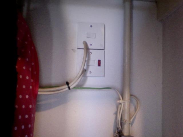

I recently discovered two switches (photos below) in a cupboard next to the boiler. I am unsure whether to keep these switched on or not - and whether they're keeping our bills up... I think they might be something to do with the immersion, but I was under the impression that the flat is electric heating then the immersion should be left on? I'm also unsure as to which switch is which.

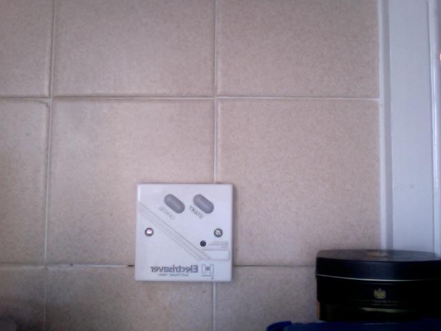

We have an Electrisaver timer in our kitchen (picture below) which I think must be something to do with it... I'm sure it's a booster, but if I leave the immersion on (by the switch in the cupboard - if that's what the switch is for), then surely i don't need a boost? And there should always be hot water?

There are usually two heating elements fitted to the hot water cylinder. The bottom one is only energised during the low rate tariff and heats the whole hot water cylinder.
If you run out of hot water during the day the boost button operates the top element at the normal rate tariff for one hour. This heats just the top of the cylinder to top up the hot water.
This is normally how it is wired, but I have seen the boost function operating the bottom element.
The isolation switches in the cupboard next to the cylinder are a requirement of the wiring regulations for local isolation.

In that case, would you say the isolation switches in the cupboard correspond with the bottom and top heating elements? So, if I maybe try just leaving the bottom one on, as opposed to them both?

you shouldnt need to isolate the top immersor as long as the booster switch is wired properly, however it wont do any harm, follow the wire fromm the top immersor and switch off the corresponding switch if the amount of hot water decreases then the wiring is wrong and the top immersor hasbeen on when not required, leading to 24/7 hot water and high bills, if the volume of hot water stays the same then you are no worse off
