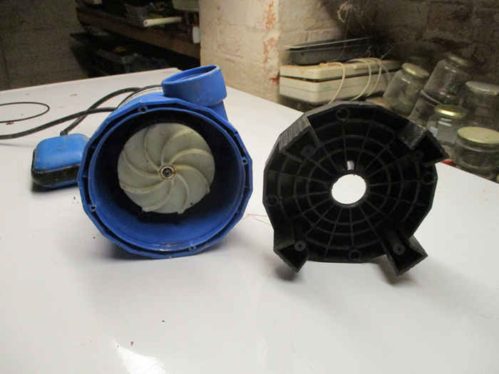

OK, I've semi-dismantled one of them (the one which was not in-service for long) and, although I think this one is probably a 'lost cause', I'm still intrigued as to 'how/why it works' (when it does!).
The bottom was in two parts, so two sets of 4 screws to remove. It was totally clean inside, and the impeller could be spun easily by hand. However, on application of power, it just buzzed by didn't spin. 'Flicking it around' did, sometimes (but not always) get the motor going, but it would never start again (without flicking) after it had stopped. It therefore seems that something is wrong with the motor and/or its control, quite possibly ...
Flick to start but wont start on its own is often the capacitor.
. However, I suspect that if I attempted to address that (if I could find a way into the motor housing), I would be unlikely to be able to get it adequately water-tight again?
I'll move on shortly to the other one! However, more generally, I still don't really understand how they ever work (pumping-wise). As I said, both inlet and outlet going into the same chamber (containing the impeller). As can be seen in the pic below, the inlet 'hole in the bottom' is not much smaller than the outlet pipe (both about 1" diameter), with no valve - so why does the water come out of the outlet, at relatively high pressure, without at least equally going back out of the 'inlet' hole?

When the pump starts, the centre of the impeller is at low pressure.....the swirl of the impeller causes water to be drawn in and forced around the vanes at high pressure to the outlet port.
The impeller needs to run in an enclosed space to be at its most efficient and prevent water escape.

The "Vanes" on the impeller (lets call them that for now) are angled to move water in a certain way and whilst I can`t quite see from the photo on yours often the housing is not central to the impeller but is set up to be nearer the housing and just past the outlet therefore by closing the gap the water is pushed out. I spent 5yrs in pump R&D before computers were doing this stuff and by moving housings around you get a BIG difference however the wear life on bearings and and other parts have to be considered, well that and the end user of course.

The 'swirl' shaped lips on the bottom of that impeller, once it begins spin, will fling the water out to the sides of the impeller through centrifugal force, then out via the discharge port. That will cause a low pressure in the middle of the impeller which draws in more water from the base.
The don't produce much water pressure, but shift a large volume.
