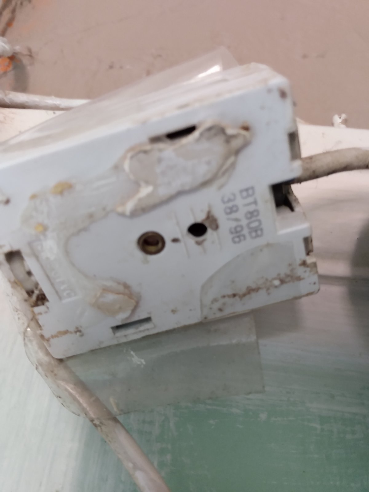

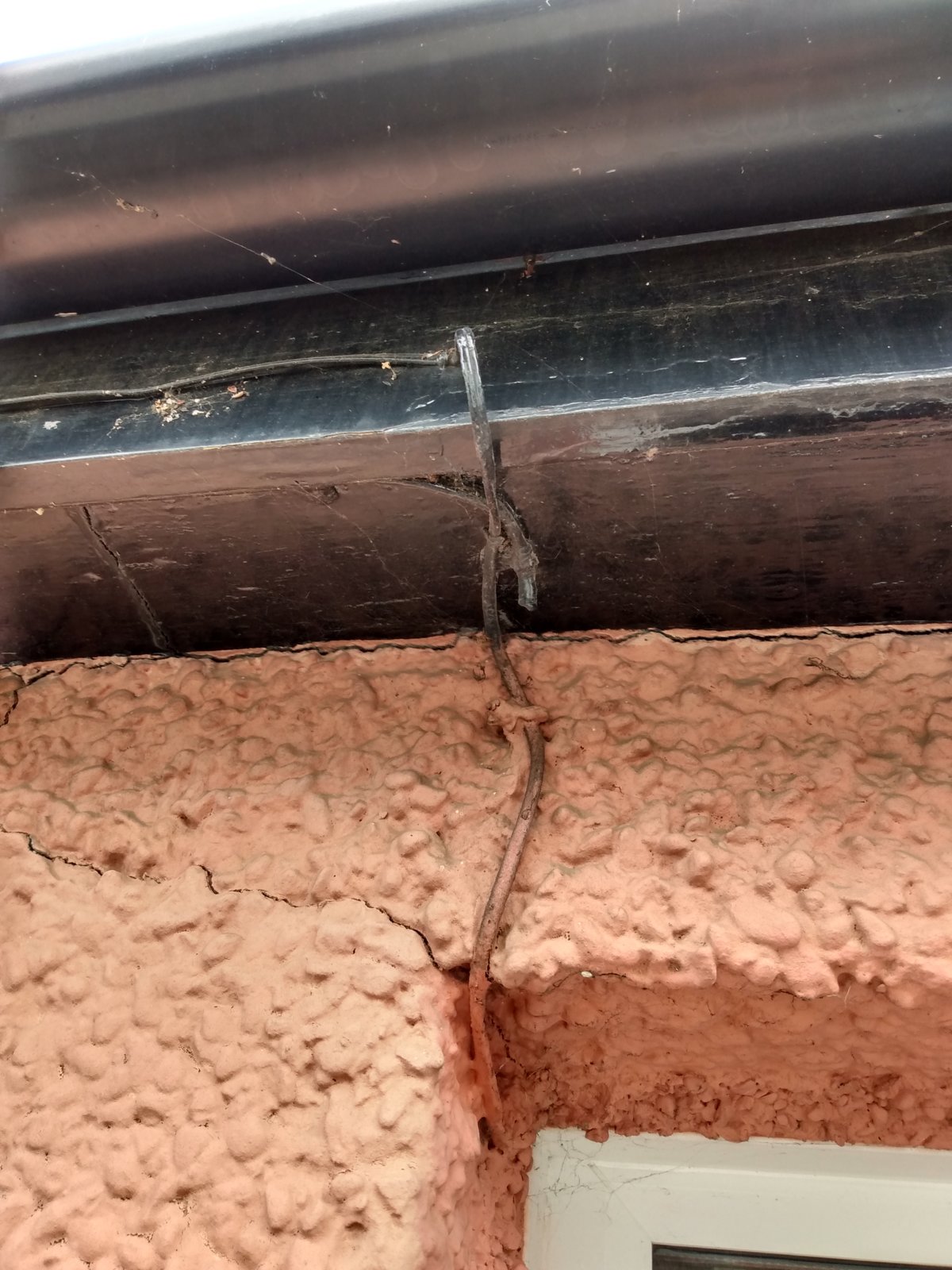

I've just noticed, the incoming cable in the first photo is a flat cable (shotgun/figure 8), which means it's a much older DropWire, either 1, 2, 6 or 8, which all have larger conductors. So, not suitable for 24AWG IDC termination. The junction box must be a 'screw terminal to IDC' box (probably BT80A), which you will need to re-use Jon.
Also, I take it it's just painted and not actually a white cable, outside is black of course?

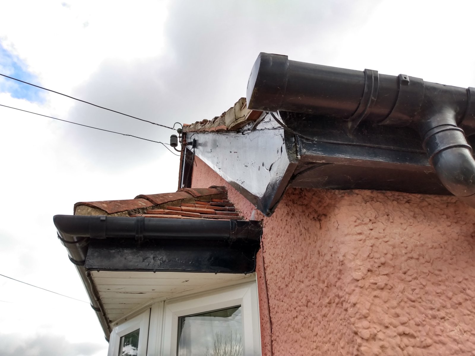

Oh, plenty of spare wire there on the outside. I would be looking to bring that dropwire in at the apex, just below the bracket if you possibly can.
To minimise disruption, see if you can find a route out of the loft, at the apex - try to poke a rigid piece of wire through like a straightened out wire coat hanger, from the inside to the outside. You might be able to see some daylight to aim for?
Then run your new cable up into the loft, from your intended socket position, fix your socket and connect it. Your final step, is to cut the dropwire and pull it through, taped firmly onto the end of your coat hanger, re-using the original BT80B joint box for the joint in the loft.

OK, so the wires into the box,. that's just 2 simple wires? Then after the box, it's the multi coloured ones? Just looks a lot more little wires in the box that in the picture?
Wondering is the easiest way would be to cut the wire that comes into the house, then try to remove from the fascia, push through eaves into loft at front, then reconnect to the box in loft above the telephone point, and run a new cable down to the telephone.
It looks much more complicated than it actually is, take the cover off that joint box and have a look inside. There are two wires in, but a 6 core/ 3 pairs coming out. The engineer used what they normally use for indoor wiring, 3 pair. Depending how the engineer did it, he might have ignored 4 of the coloured wires, or maybe used three to each terminal. The pairs are green/white +white green; blue/white + white/blue; orange/white + white/orange.

A joint inside, in the dry and out of the weather is a much better option than one outside. If you were to cut that wire you have, where it goes through the side of the window - you could unclip the rest from your facia, leaving you plenty of loose end to get almost anywhere inside your loft. Your priority is to start the operation by finding a way through from your gutter facia, into your loft space.
Thanks. Shouldn't be too hard ... probably will involve getting very dusty and dirty!
