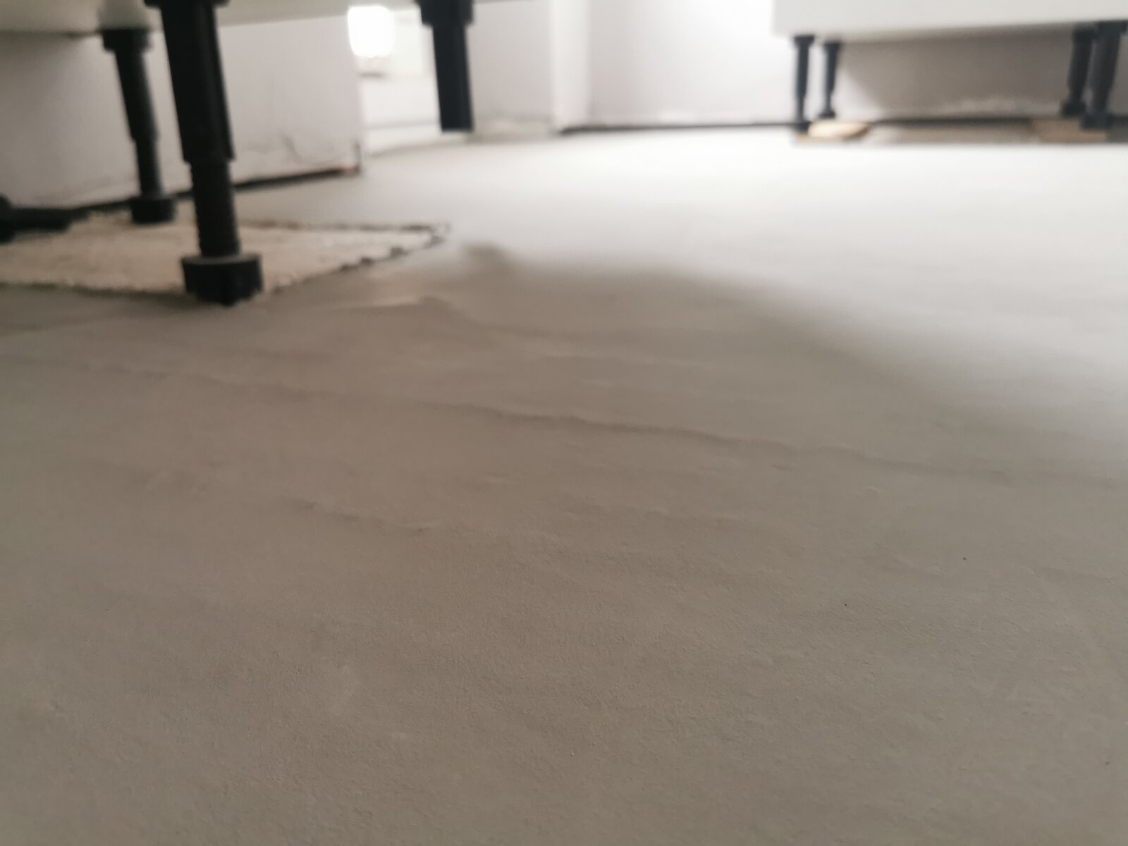

Self levelled our utility room before we went on holiday.
Now we're back I've noticed there are a few ridges still, there not huge but do leave a roughly 1 to 2mm gap below if a spirit level is placed on them, I've tried to picture them as best I can looking across them at floor level

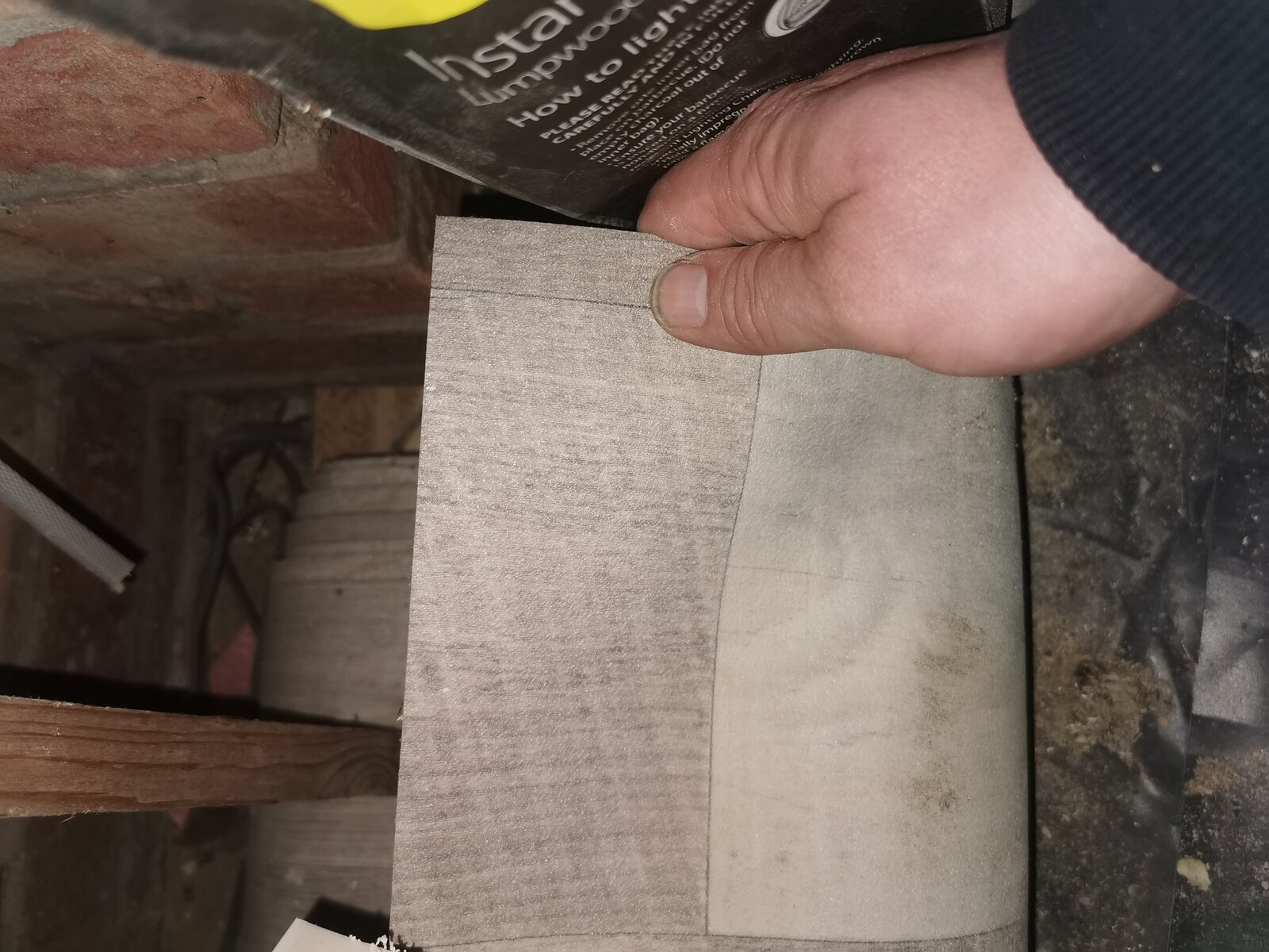

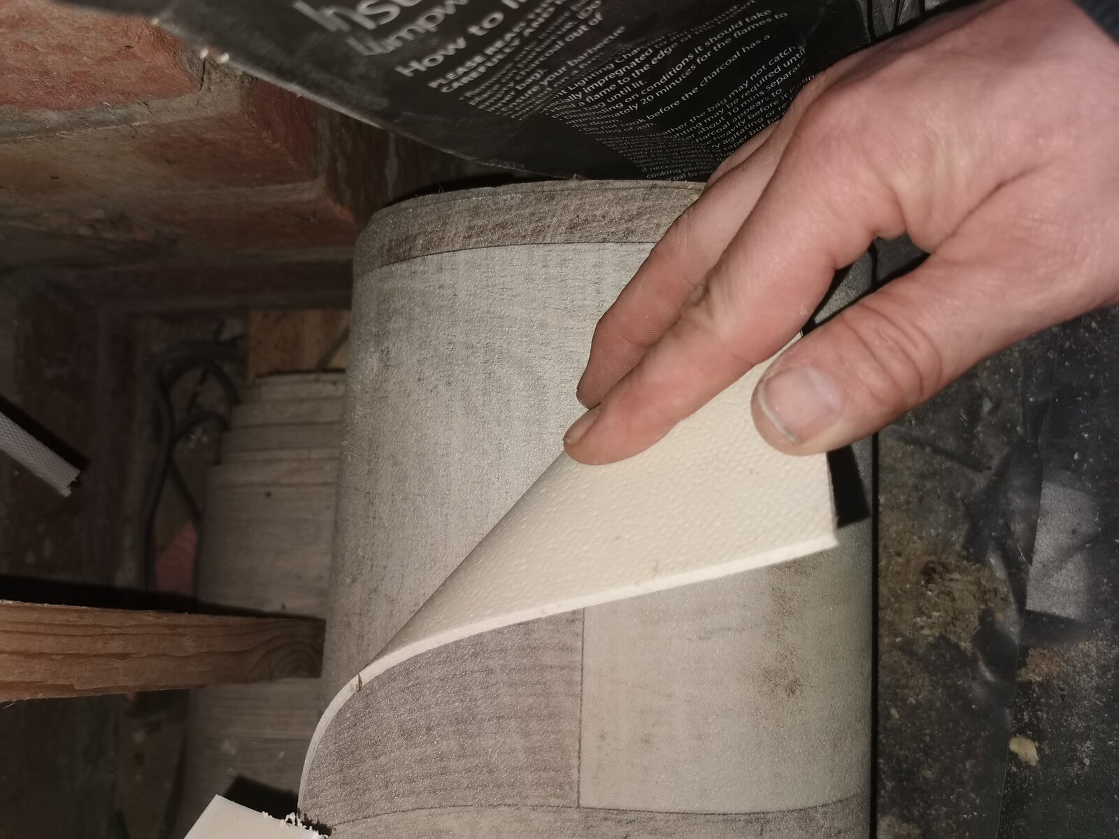

I've also took a couple of pictures of the vinyl were going to use, it's about 3.5mm thick.
Are these ridges going to show through the vinyl once it's walked on and I need to apply more self levelling between them/grind down the ridges or do you think it will be ok?

I would fill in the hollows first. Let it set and check the level. If there are any remaining bumps, then lightly sand them down.
No it's concrete thta wasn't finished the best so has a few ridges through it
