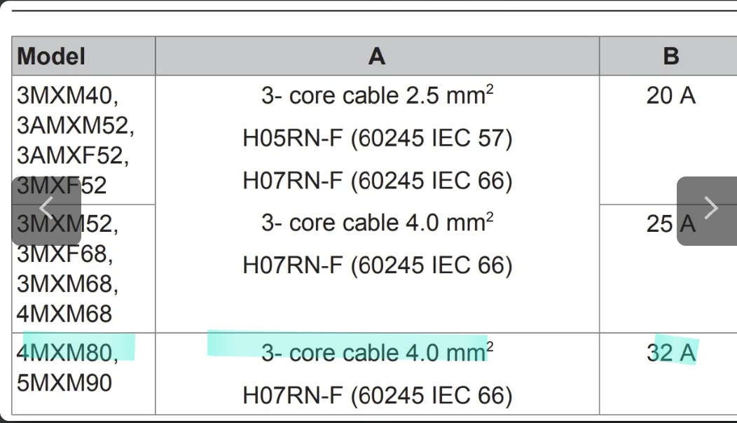

Hi,
Looking at going all electric for our heating. Live in a bungalow with good levels of insulation (400mm in loft, 60mm PIR in walls). 100a main fuse, single phase supply.
Looking at the Daikin Stylish range of heat pumps and indoor units, it's a large bungalow and we'd need 2 outdoor units running 8 indoor wall units between them, so 2 of these kits...
but I'm struggling to figure out how many amps these would draw when running at full power for heating (wouldn't use cooling much)?
Will be getting a heating engineer in but want to do my homework first to find out if this system is actually feasible before making any calls.

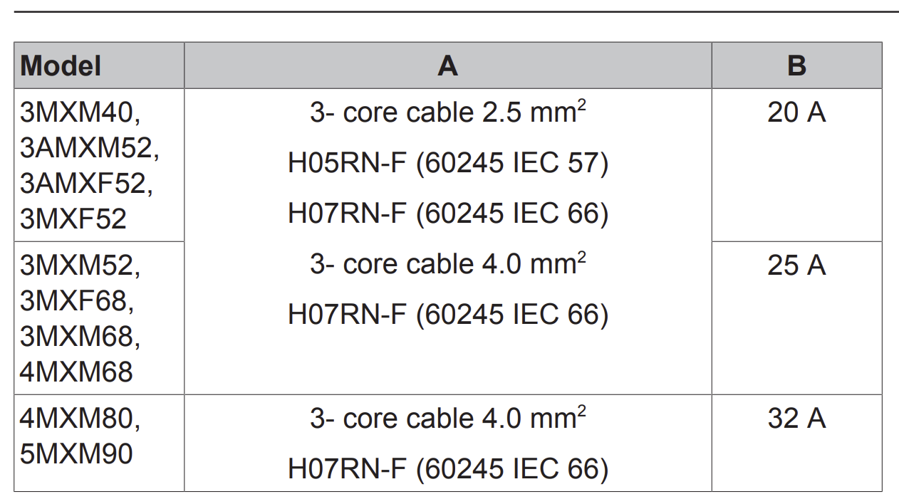

10 to 12amps, but will the heat output of that unit, be adequate for a bungalow?
I believe the 2.5KW mentioned is the heating power rather than the electrical power and they very carefully omit to show the electrical power in the spec sheet.
I have had dealings with many of these types of unit but I think only involved with electric power aspect once. It was a 3½ KW ASHP for a swimming pool which would trip the 16A RCBO which everyone assumed was on the RCD part (as it was outdoors), However I current tested and it was way over 16A.
What do you mean by "feasible"? Even two of those systems is unlikely to max out your 100A supply!
Have you tried estimating what your heating needs actually are?

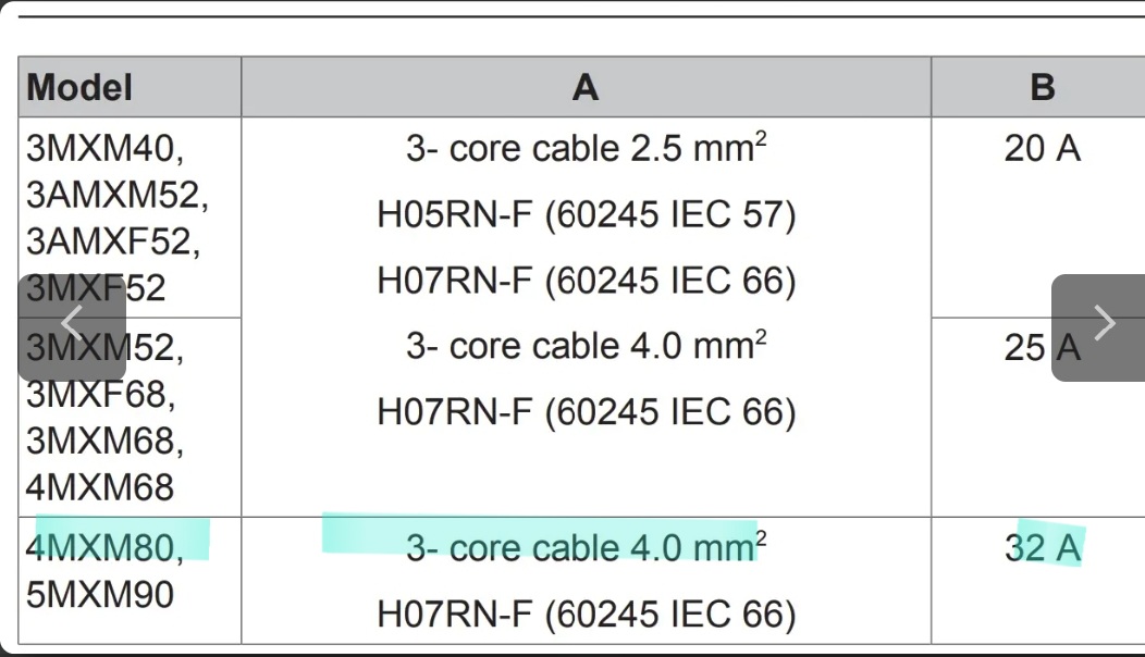

Feasible as in would 2 outdoor units and 8 indoor units draw too many amps for our electric supply to cope with.
Roughly, yes. We have an existing (older) Daikin unit running one of these wall units, it's a 2kw model in the dining room (one of the larger rooms in the property). Does a fairly good job at heating that room (28m²), the room currently has no wall insulation and only 100mm loft insulation (I'm in process of renovating and adding loft and wall insulation), so I reckon with extra insulation a slightly larger 2.5kw model will do a good job.

Your electrical supply (100A) is as large as any single-phase domestic installation, so if the demands on the supply were too large for your bungalow' supply, then these things would not be usable in the vast majority of domestic buildings.

I get that these are designed for domestic properties, but do all domestic properties require 2 outdoor and 8 indoor units, possibly not, so yes my concern is is this too much for the average property?
Much also depends on your other loads, EV charger, water heater, electric ovens etc..
