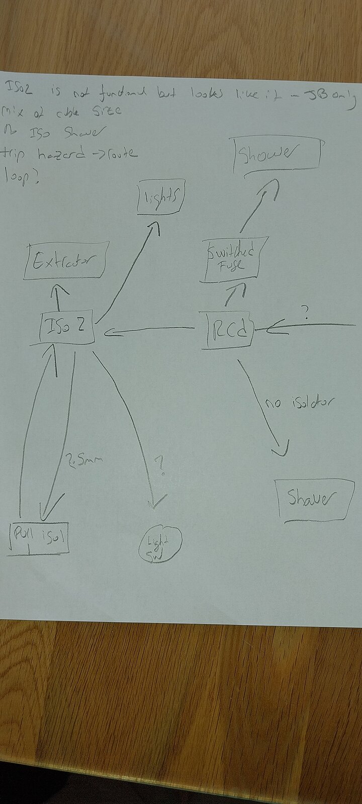

RCD(loft) Fed from light circuit (1 or 1.5mm not sure).
I can't remember if before this work there was a loop in/out or if this was the end of the circuit .
Shaver socket fed from RCD, no fused connector for the shaver socket
Digital shower fed via fsu from RCD
3 pole isolator 2 (loft) fed from RCD, currently in off position, nothing is off. Yes the isolator is inoperative and being used only as a junction box. Hopefully nobody working on the extractor assumes the isolator would, you know, isolate.
Extractor fed by isolator 2, but not since it doesn't isolate.
3 pole pull cord isolator in room (we asked the sparky who fitted the old extractor to put one in the room so we could switch off over night, it was previously in series with isolator 1 when isolator 1 actually isolated). Pull cord isolator is fed from isolator 1.

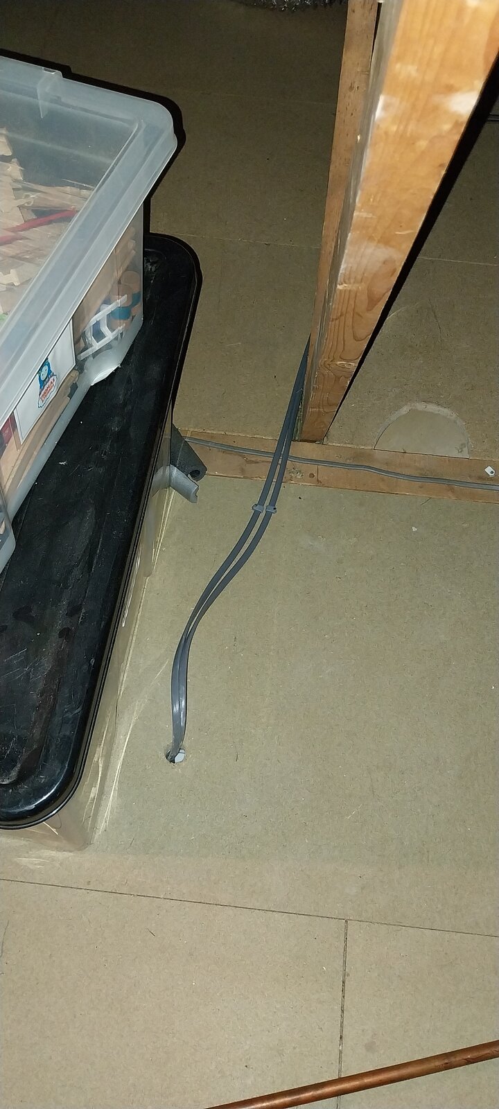

Cable for isolator 2 now comes up from middle of loft floor, trip/snag hazard.
Lights fed from isolator 2 , not isolated by pull isolator 1.
The question marks are where I made assumptions because I couldn't follow the cable
Anything I missed?

There are general regulations which refer to spiting the supply into circuits, and RCD requirements for circuits in a bathroom, but the diagram does not really show much, photos are better, the photo of the cable yes I would have expected it to come through the flooring at the joist, or at least some trunking over it, but I can't think of any regulation it brakes.
There are phrases like "they are adequately robust or have additional mechanical protection appropriate to the assessed conditions of external influence." but hard to see from what you have said where that requirement has not been met.

For the OP... That install reads like a total botched mess, but the way you have rushed writing the description, it is difficult to be precisely critical of the work done. Could you perhaps retype it, with better explanations perhaps? Maybe also add some photos of the work.
Are you saying there is only one RCD, and that RCD is installed in the loft? That the RCD also supplies an electric shower? That the same circuit, without any fuse/MCB also then feeds the bathroom lighting?

The light circuit is fed from an MCB on the non RCD protected side of the main CU.
The main issues are no FCU on the shaver socket (also has a built-in toothbrush charger) to allow for isolation in the event of a fault that trips the RCD or MCB on the main CU and the completely inoperative isolator that looks like it will isolate the extractor but doesn't. The cable route can be adjusted.
