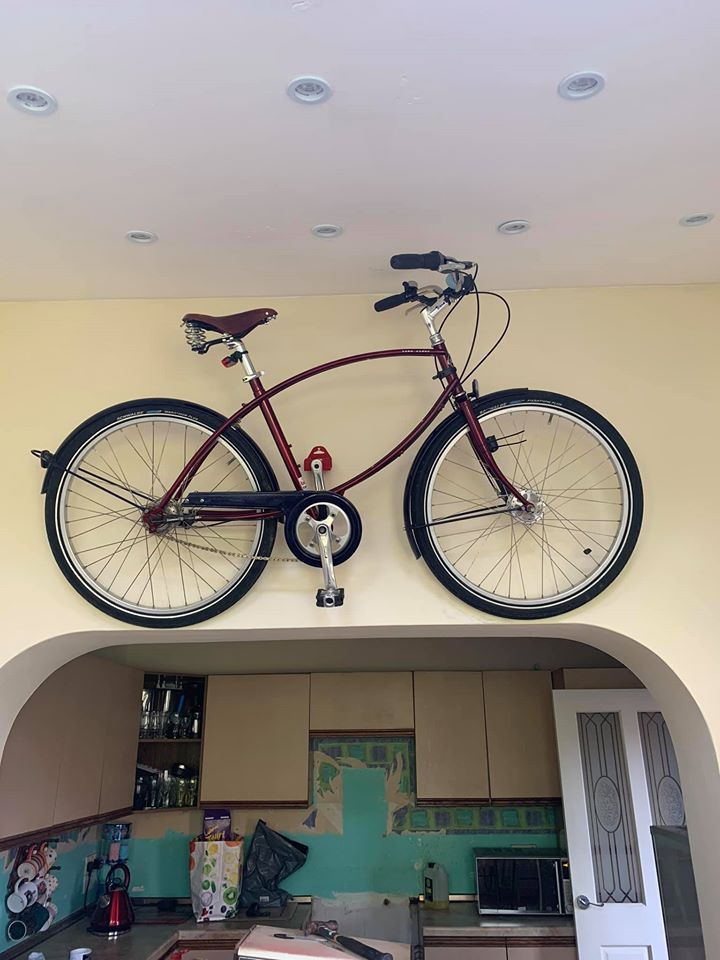

House was taken over and eventually sold to my son. He swapped the LED tube for I think 16 down lights, around 3.5 watt each, so from 2200 lumen to 255 x 16 = 4080 lumen so back to original output of fluorescent tube, but in real terms no better than the old LED tube light output wise, just looked better. And 56 watt, which compared with the fluorescent was not as many lumen per watt as the 58 watt fluorescent, and they did not seem as bright.

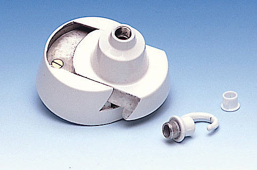

So in the main we have to work with what the home designer fitted however many years ago it was built or rewired, my living room has a single ceiling rose, Ceiling rose.jpg as does my dinning room, so can swap the two chandeliers with ease, but 8 x 6 watt SES candle bulbs do not really light the room well enough, so I have to supplement the lighting with display cabinet lights, and up lighters, and spot lights on standard lamp bases. But we don't turn all on every time we use the room, I note you are thinking of dimmer switches, but with a multi function room likely you will need to turn some lights off to watch TV but have others on to read at the bar, I noted when we moved to compact fluorescents that in places like Turkey they would split the lighting 1/3 and 2/3 so three levels of lighting without using dimmer switches.

My sons down lights do look better than the old fluorescent tube, 102 Kitchen Bike.jpg but clearly rather a high ceiling to be able to mount the bike there, and the actual light in the room is no better than with the 24 watt LED replacement tube, but counting lumen it should be far better, and watts wise same as fluorescent tube but less light.

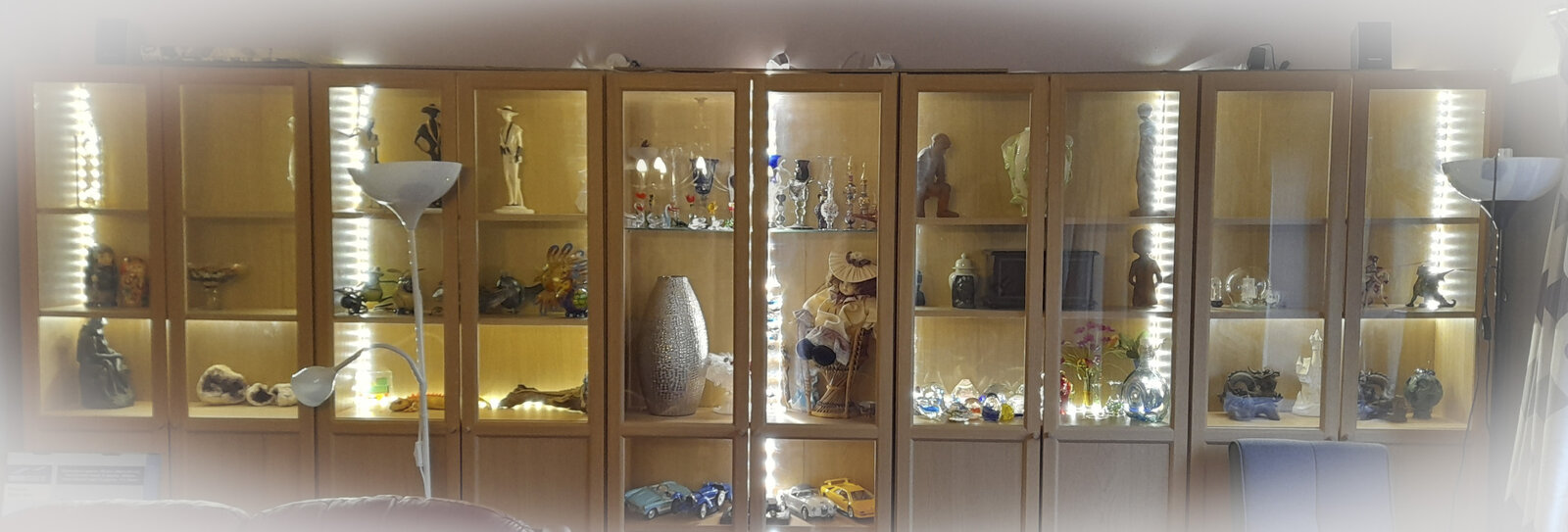

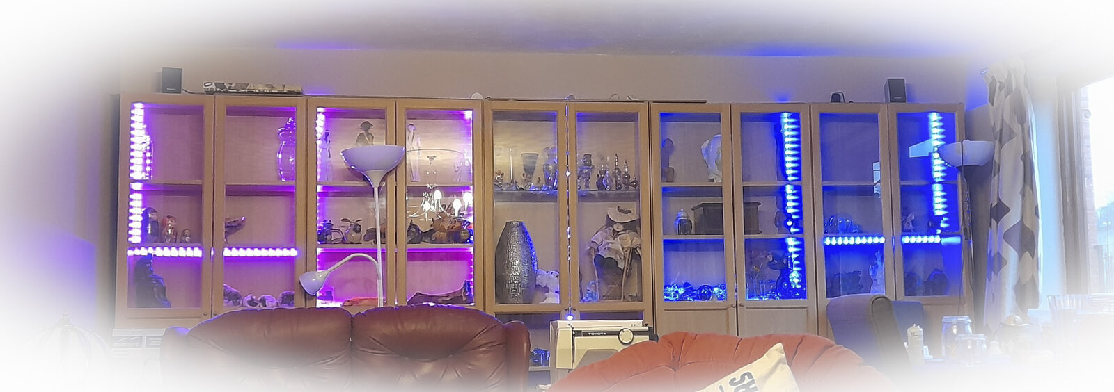

The display cabinet lights have worked well, 20230227_163006_2.jpg can also change colour, but they give the extra light when needed that end of the room, without looking like an after thought, which they are, the room lighting is inadequate for such a large room, but getting extra ceiling lights installed will be a big job. There is around 30 watt of LED lighting in those cabinets if turned up full, but in the main set for mood lighting, 20230227_170703_1.jpgone of the advantages of using smart lights, it can change what it does. I will however admit the first attempt with Ikea lamps was a failure.
