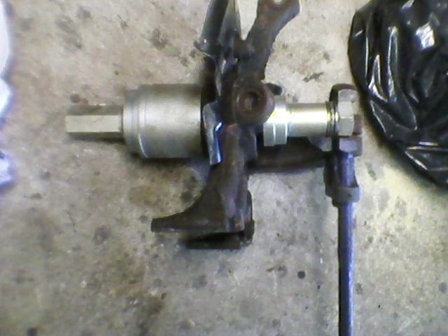

John :)
The puller set I got works well. Used my 750mm breaker bar and stillson wrench and the old bearing race pulled straight out.
Just get the right collar, make up the space and away it pulls. New bearing is installed ( in the freezer first) and the hub is pulled back in.
full
I must confess, I didn’t think this kit looked man enough when I first saw it!
Pleased it’s sorted.
John :)
The kit has certainly proved strong enough but credit has to go to the 750mm breaker bar for providing the strong arm.
I spray greased the all the parts so there was no dry metal to metal.

With the puller set I've invested in, I have no reservation doing a wheel bearing job. The damper for me is the weather and getting parts. The local factors don't always have the OE brand for the car.
