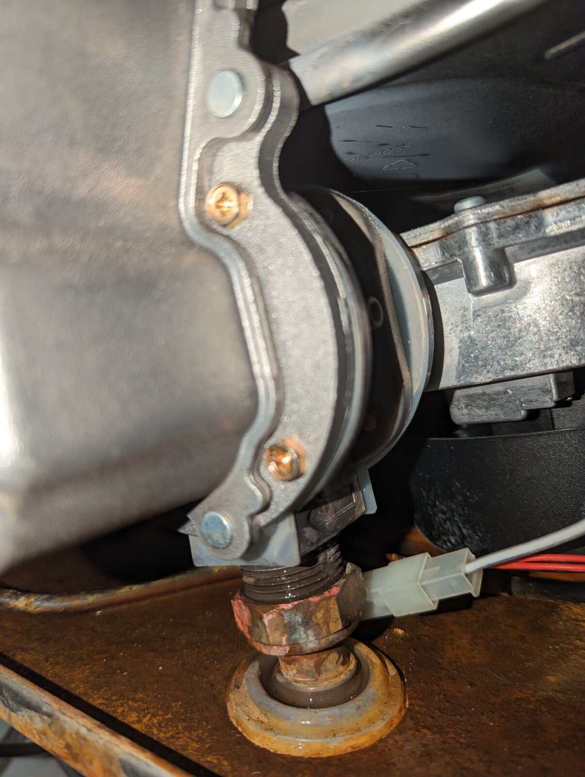

So we thought this was a bit better as no leaks and far fewer problems so I've been lax at getting someone out, but it's clearly still wet and now starting to get messy.
I am 90+% sure the water is coming from this threaded section below the main combustion unit, you can see the thread is visibly wet...I dried it and this is damp again soon after. So surely that's where it's coming from.
I've suspected this was the ingress point before but when I've asked I was told "there's no way water could be inside there". Could there be an actual leak inside the sealed unit, if not what ARE the possibilities? Surely can't be too many.

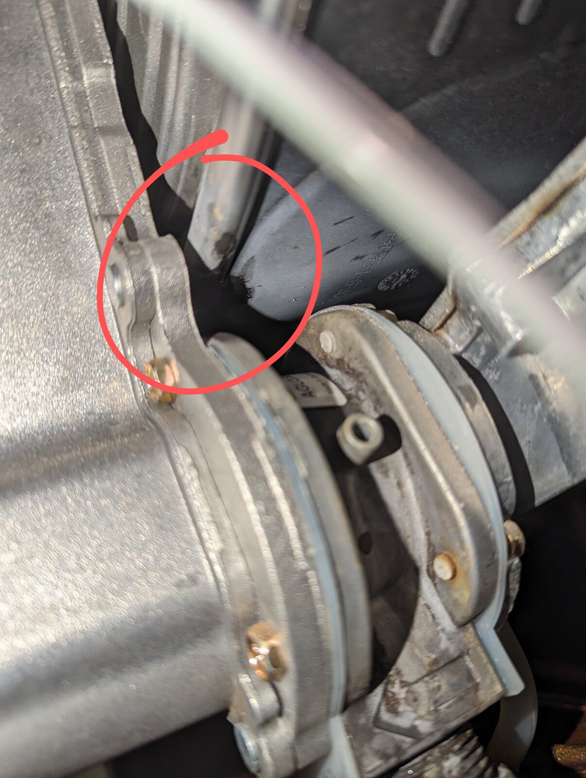

I don't know what's relevant but we've already raised the condensate pipe and there has been zero reason for over a week. The water coming out seems very clear, not like the CH water which is a bit mucky.
In fact it's actually damp above the thread. Hard to get a good photo but it seems it's not maybe the thread leaking but something higher up?
Can yo get a photo from underneath the boiler of the pipe exiting the casing bottom.
If that's where I think it is - at the base of the venturi - then that's the gas pipe. You shouldn't really be in there and would advise you leave it alone (as was suggested earlier) and get a new engineer in to strip it down and find where the problem lies.
