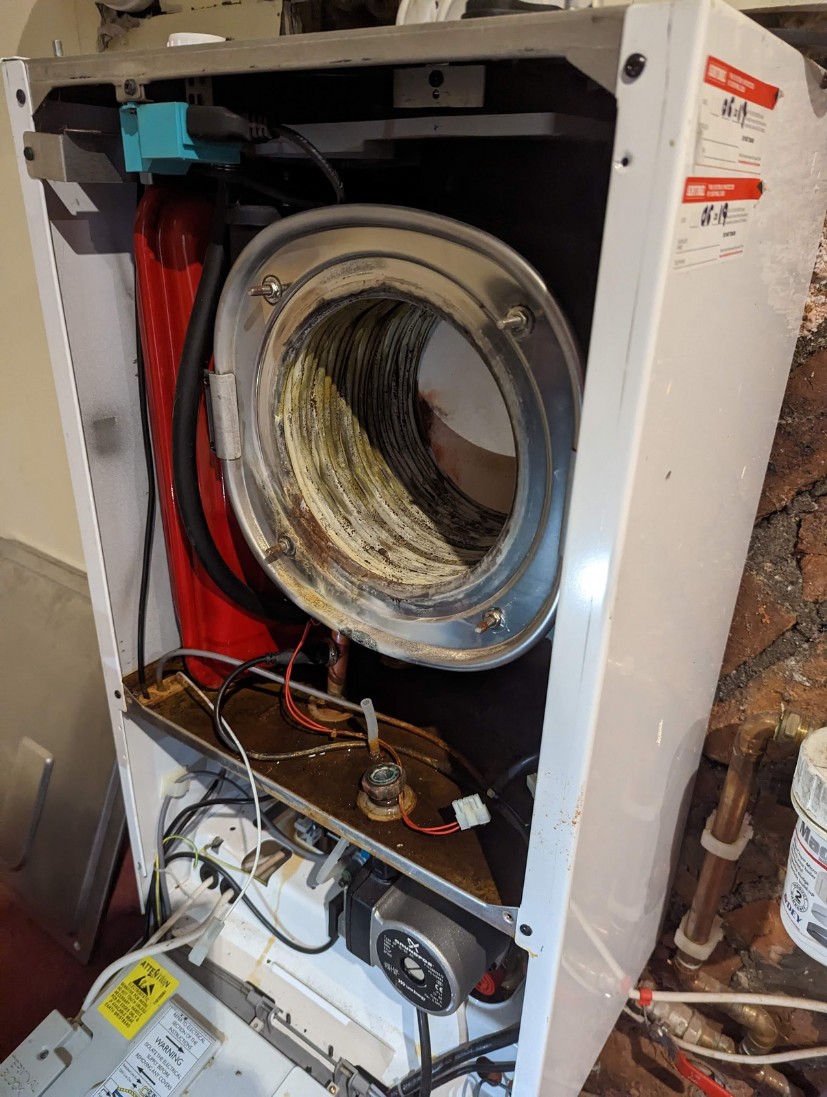

Don't worry I'm not touching anything. I'm only going as far as removing the external cover to try and see where the leak is (with it turned off at the mains), and to keep it dry until the plumber can get here. I have no intention of trying to fix it or do anything else myself but it was 1/2 deep in there today so I was mopping up. Trying to get anyone out is a nightmare and the whole thing is going to hell with all that standing water if I don't get in with a sponge!!

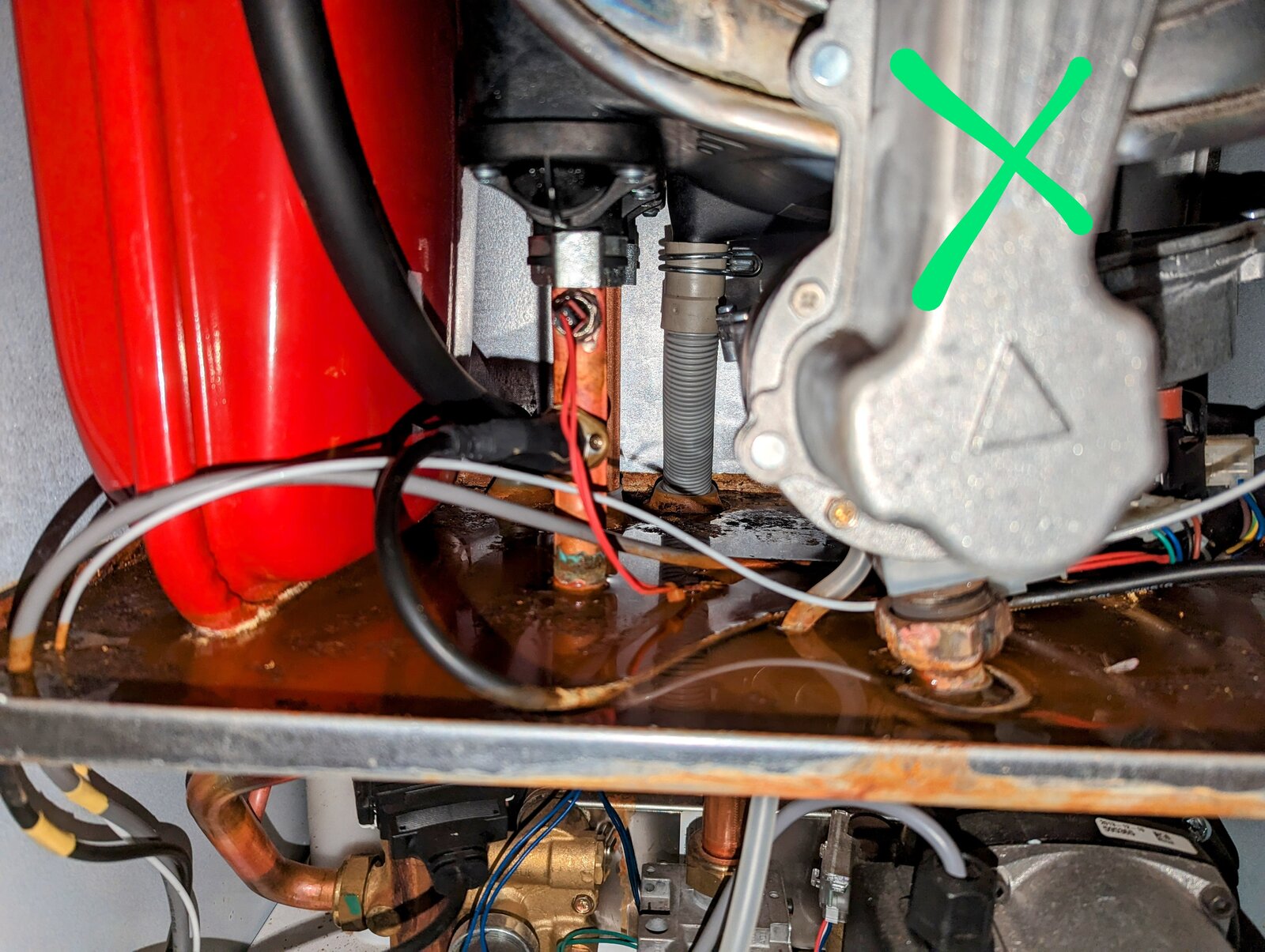

It's almost impossible to get a good photo but in terms of position, it's directly behind this big metal lump under the combustion chamber, kind of on the rim if that makes sense.
Why/how on earth could water get in there, it just seems a weird issue?
To repeat myself, that's not where the water is coming from (and the condensate pipe was already inspected since that's where he originally thought/hoped the problem was)

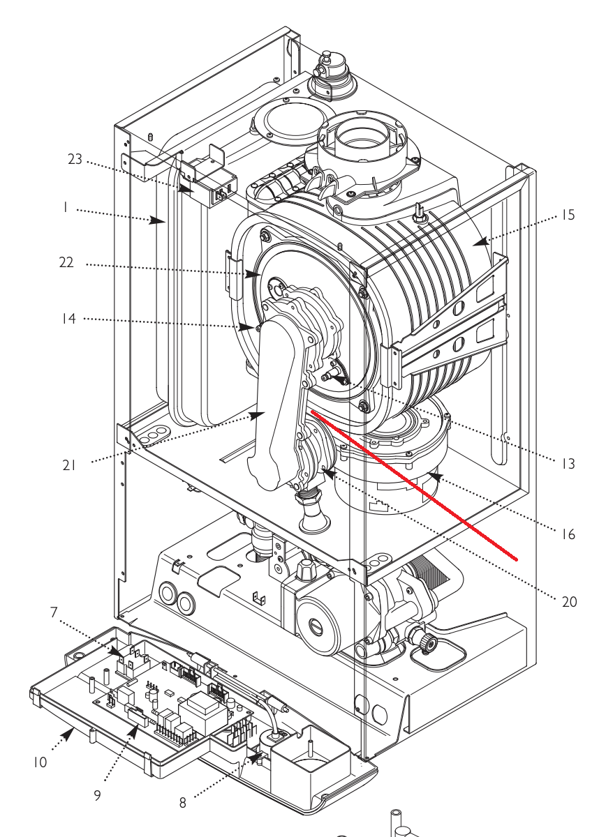

I found a manual diagram and marked it since photos are tricky - it's not so far as I can tell from the venturi but the bottom of the combustion box itself, like it's dripping through from inside.
I would love it to be something as simple as a bit of pipe but that wouldn't explain water inside the combustion box, right? I don't know if it was this thread, but previously someone suggested a leak on the primary heat exchanger - the plumber had mentioned this a while ago when we had the fan fail but it is such an expensive thing to replace (best part of £700 looks like) he sounded like he really didn't want to given we plan to do major works on the CH this year and probably replace the boiler. We have persistent CH water quality issues causing failures even after a power-flush and plan to replace older radiators and service all the rest... we just need to get past winter!

The grey pipe at the back will be were your leak is it will be split between the corrugations . that boiler is not far off being totally feked with corrosion

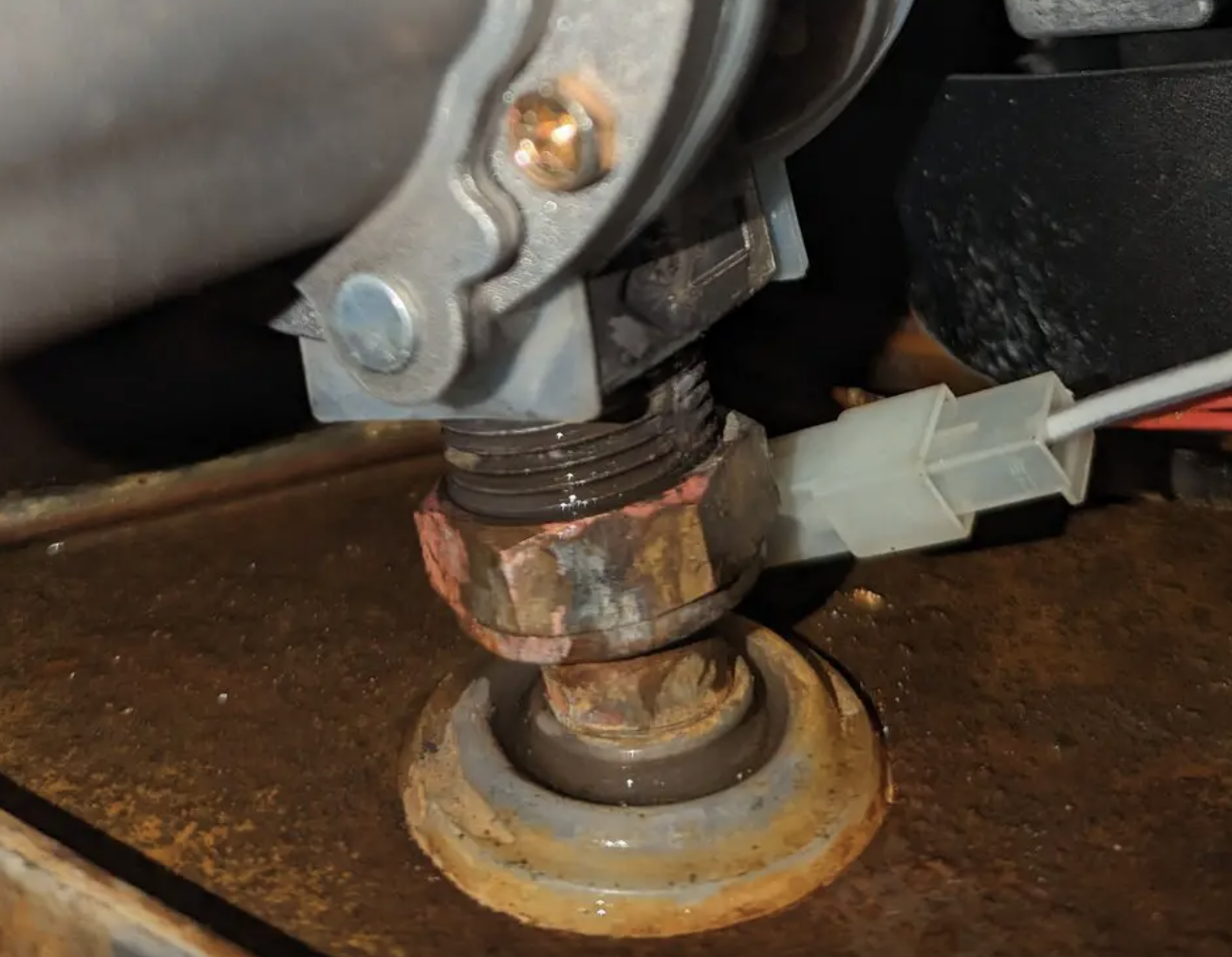

No, it isn't. I've shown a photo of the water running down that threaded metal section at the front. I sat and watched it yesterday for a bit and after drying that bit I could see water start to seep into the thread from above - this IS how the water is arriving into the tray, the plastic pipe is totally dry.
I WISH it was a bit of cheap pipe but that has been checked already and isn't the source. It's probably a blessing we are planning to replace the boiler, because like you say this water is ruining everything. The tray seems designed to collect any water and stop it escaping so it sits rusting. If there was a drain on it we'd have seen it dripping sooner and probably have less corrosion.

So we got a plumber out yesterday and the short version is: it's the primary H/E (a pinhole leak he thinks).
Longer version:
He could see the water seeping down from behind the venturi from the spot I showed above, but removing the cover and burner it wasn't actually wet. He checked the seal (replaced previously) and it was good and the condensate corrugated pipe (fine as expected).
He talked about how the condensate pipe is designed to take any water out but if blocked could lead to water backing up, however there was no sign of dampness at the time and the leak didn't continue start while the system was off. But the moment we turned it back on it started seeping again - within moments so far too soon for any condensate issue.
The water seeping out was quite dirty and we have historically had issues with CH water (originally there was a solid fuel boiler we think) - we've had the plate exchanger and the diverter fail previously to getting the system power-flushed but it's still not great. He said it's unusual for the main exchanger to fail but the prolonged exposure to the dirt has presumably caused a pinhole leak somewhere inside the HE. We can't see the leak but there doesn't seem an obvious other option(?)
