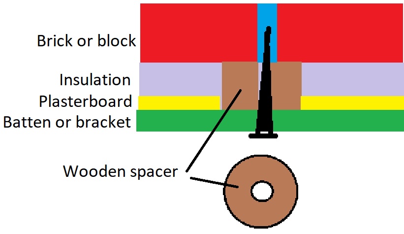

This might be over kill for your project but it does provide a secure fixing for a batten or a bracket. It prevents cracking of the plaster board if the insulation squeezes under the pressure of the batten onto the plasterboard.
Drill a hole the diameter of the spacer as far as the brick.
Drill a hole for the wall plug ( blue )
Push the spacer into the hole
Put the batten or bracket in place and screw into the wall plug
The spacer can be any shape provided it will be hidden behind the batten.
You can use a 6mm hole thru all and 6mm plug, long screw does not mean thicker , they are available thin enough to fit a 6mm plug.
If you are fixing batten to wall you can leave out spacers .
@bernardgreen how would I get the spacer the size you mention in between the plasterboard and the wall!?
So confused. I like the concept.
Drill a hole in a bit of round dowel and cut it off to the length needed for the spacer. A piece of wooden brush handle would do instead.
Or find a bit of timber the correct thickness and use a hole saw to cut a disk out of it.

@Harry Bloomfield I'm still confused how one would put the spaces in and have them stay there!

@bernardgreen Just seen your next reply. That's a massive hole!
I'll need to make 10 such holes. Seems a lot? Given the choice, I would avoid.
Among other things, it would mean drilling massive holes into tiles.
