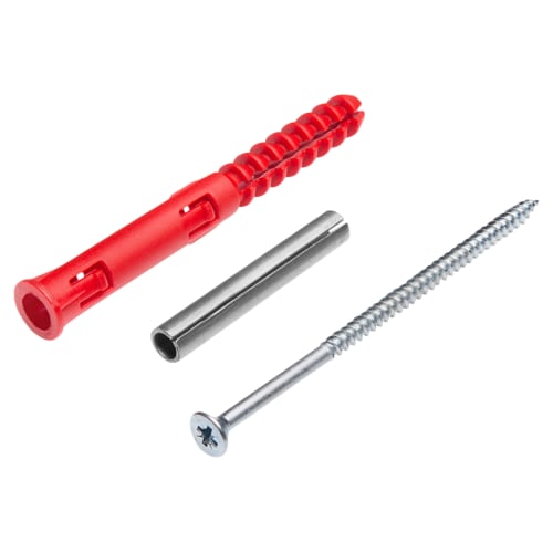

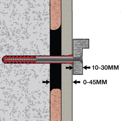

I admit I have not read the whole thread, so someone might have suggested this: there are now fittings designed exactly for this. They consist of a long "rawl plug" which goes from the surface of the plaster board all the way into the brick or block behind. Then they have a metal tube which you hammer in and which supports the fitting where the screw goes past the air gap between the plasterboard and the wall. Then you can tighten the fitting which will support the load and not crush the plasterboard.
I cannot remember what they are called, or which manufacturer, but I am sure you will be able to find them when you find the right search word.

Thank you Koolpc, those are the exact ones I was thinking of !
As far as OM2;
Too much work involved ? Just one drill bit through the plasterboard and into the wall to the appropriate depth. Then simply tap the plastic part in, tap the metal sleeve in, and screw in the screw. No more work than any other plasterboard fitting, and much more secure for loads such as shelving etc.. (This assumes you have a decent hammer drill of course).
Some plasterboard fittings are too deep for the gap, so one needs to drill through into the wall anyway to clear them.

I am hitting the brick after a massive 80mm, 8 flipping cm! it's obscene. Totally the wrong kind of boards for this task IMO. So naturally I need a screw which is going to go at least 40mm into the brick to provide any kind of security. 80mm of plaster board, foam and air + 40mm. That's a 120mm long screw with plug that I need. M10s are very common for this but M6 are not available on either TS or SF. Nothing on Amazon either, but finally found someone selling the M6s I need (These particular shelve mounts can't take anything bigger than an M6 unfortunately).

Should have gotten corefix fittings...
They look good, just too big (thick) for my precise shelf mounts. I can't find anything less than M10. No doubt will have other things to fix to the walls in the future. Will keep them in mind.
