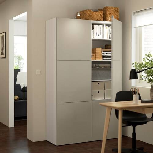

I will be placing some tall cupboards (2m30ish in total) against a wall. (library image below)
They need to have attachment points at the top, into our plasterboard to stop them toppling. They are 'not' weight bearing.
Did a quick test drill; the wall is 40mm plaster (I presume acoustic plaster as it's a new(ish) build), with only 5mm cavity before the brick.
Whats your best way for attaching to the plaster?

Thanks for the input everyone. But I gotta say, no potatoes will be hanging off these things, let alone kids. But some great advice nevertheless.
One thing to note, the attachment is inside of the bookcase, in the corners, so no real option there for an angled drill hole. But I will see if there's some other option, just in case
