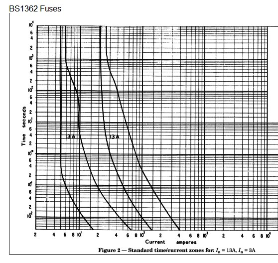

As we have observed before, it seems that one needs a current of at least 21A-22A to ever blow a 13A BS1362 fuse (even if that current persists 'for ever').
Kind Regards, John
Having been using 13A plugs for high power applications for years I can confirm that 13A fused do in fact fail quite regularly when run at full current.
I was one of those lucky people to get the license to buy and use unfused 13A plugs and they were reliable.
I can't argue with (and don't doubt) your experiences, but if they ever blow with under 20A, I presume they must be out-of-spec ...
Kind Regards, John
Kind Regards, John
Oh yes I am very aware of the specs and graphs, and we tried a whole range of different makes and truly didn't find a significant difference.
The application was event lighting and running at 13A continuously for hours on end the fuses do get ****king hot, my theory was the regular heating and cooling created fatigue within the fuse. We got to the stage of constantly changing fuses before they failed.

Yes, but you seem to be using "fault" in the everyday sense, whereas in terms of circuit/cable protection, it has a very specific meaning, relating to to a 'fault' of negligible impedance (i.e. a 'short circuit'), such that the resulting 'fault current' would be the PFC of the circuit.
The OPD of any circuit (e.g. a 32A MCB or 30A fuse protecting a ring final circuit) is required to provide adequate 'fault protection' for the entire circuit. Adequate 'fault protection' therefore usually already exists, regardless of the rating of a fuse in a plug (or, indeed, even if that fuse is replaced with a nail!).
If the nature of the load is such that a 'fault' (everyday sense) of non-negligible impedance (i.e. an 'overload') is 'likely' to arise, then the cable supplying that load has to be adequately protected against that overload current - and, if the CCC of the cable downstream of the plug is less than the CCC of the fixed wiring (which should be afforded adequate overload protection by the circuit's OPD), then there may be a need for a fuse in the plug to provide 'overload' protection for that downstream cable.
