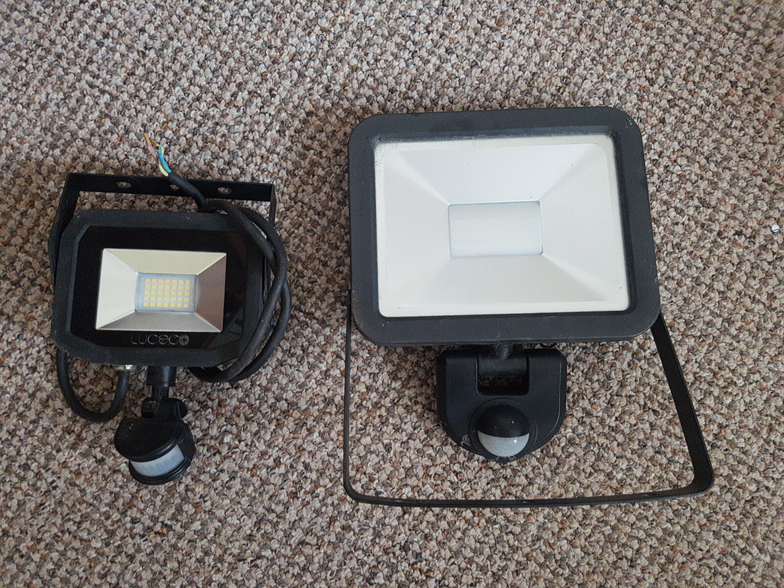

These two destined for an early grave otherwise:

I agree - if that were the case, but these failed after only 18 months, for my sins the large lamp was a LAP product - but still, it shouldn't fail after such a short time. What brand do you install, and that has a replacable LED element ? Have I simply been unlucky ?

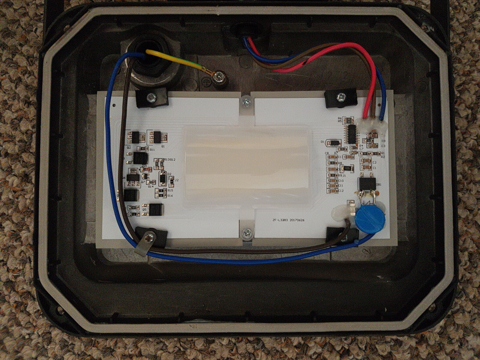

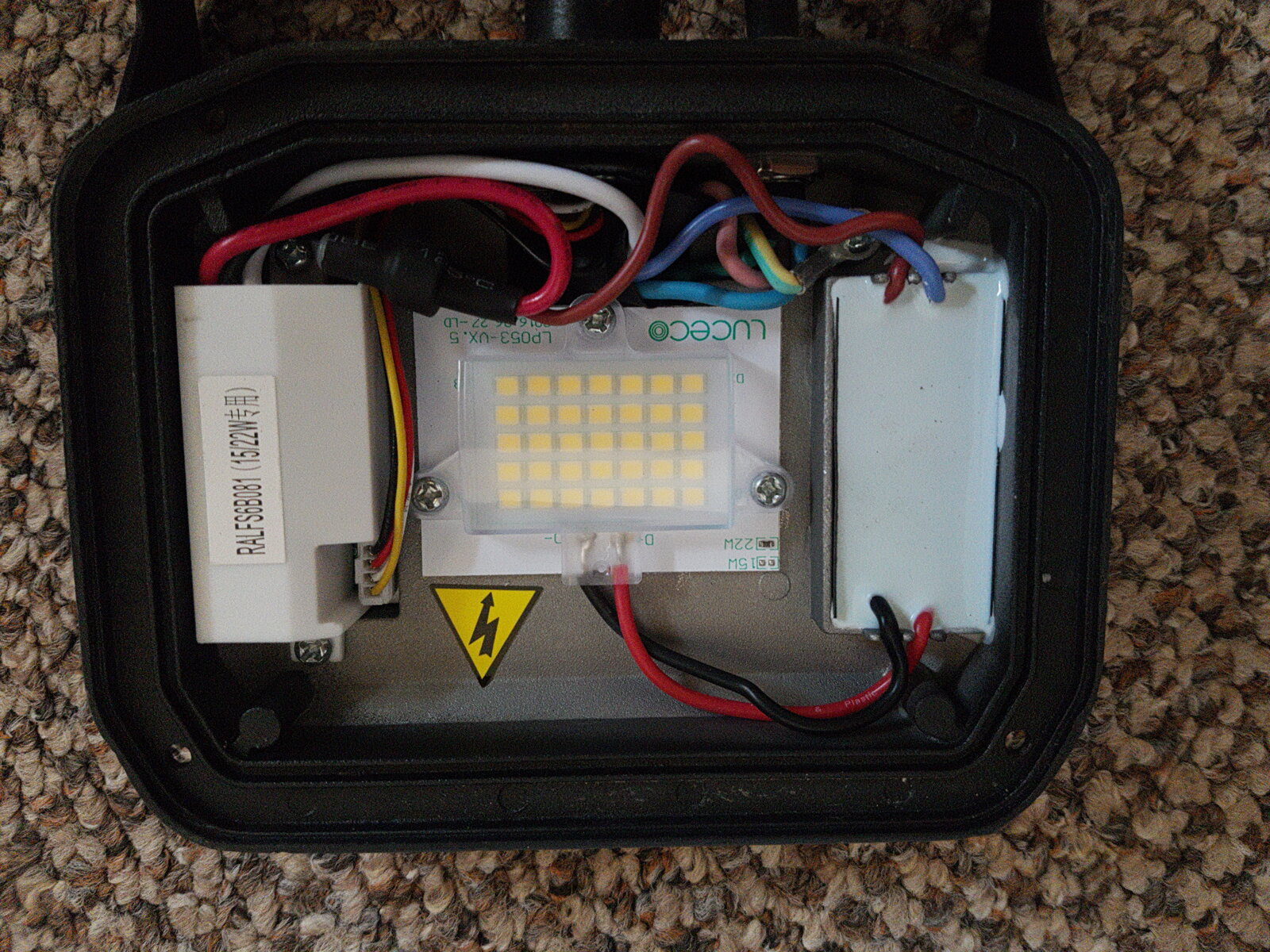

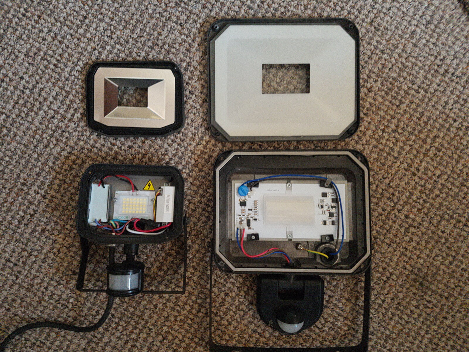

You may find it's the infrared detector bit that has gone fubar (I had a cheap LAP from Screwfix & that's what happened to that one). You can get standalone pir units but they're about the same cost as the whole unit- advantage with the standalone is you can put it where it'll detect reliably & have the lamp where it'll light properly.

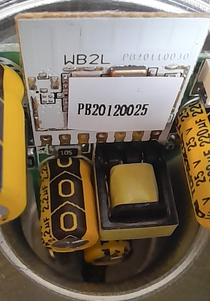

He does not have a SPD fitted, I do. But how far does one go? This lamp 20220603_113820_1.jpg which failed on me has I find on opening plug in modules, can't really believe a GU10 is so complex inside, OK not a cheap one, cost around £7 and it could before it failed dim and change colour.
But this
lamp from screwfix is £8.50 so around same price as the GU10 bulb, I would not dream of repairing the bulb, although I did repair a G9 bulb when I found a dry joint, but if willing to dump the bulb, why not dump whole lamp?
The R7s bulb
for the old quartz lamp costs £10, the larger output versions £16 so seems clear why we can't repair, bits cost more than the lamp.

I have replaced drivers and chips on LED floodlights before. Multimeter, soldering iron, youtube and ebay is what you need.
Some of the floodlights are like triggers broom, the only original part is the casing :D

Maybe just the sensors have failed, you could try bypassing the sensor and use them as floodlights, with a lead and a plug on they may come in handy
