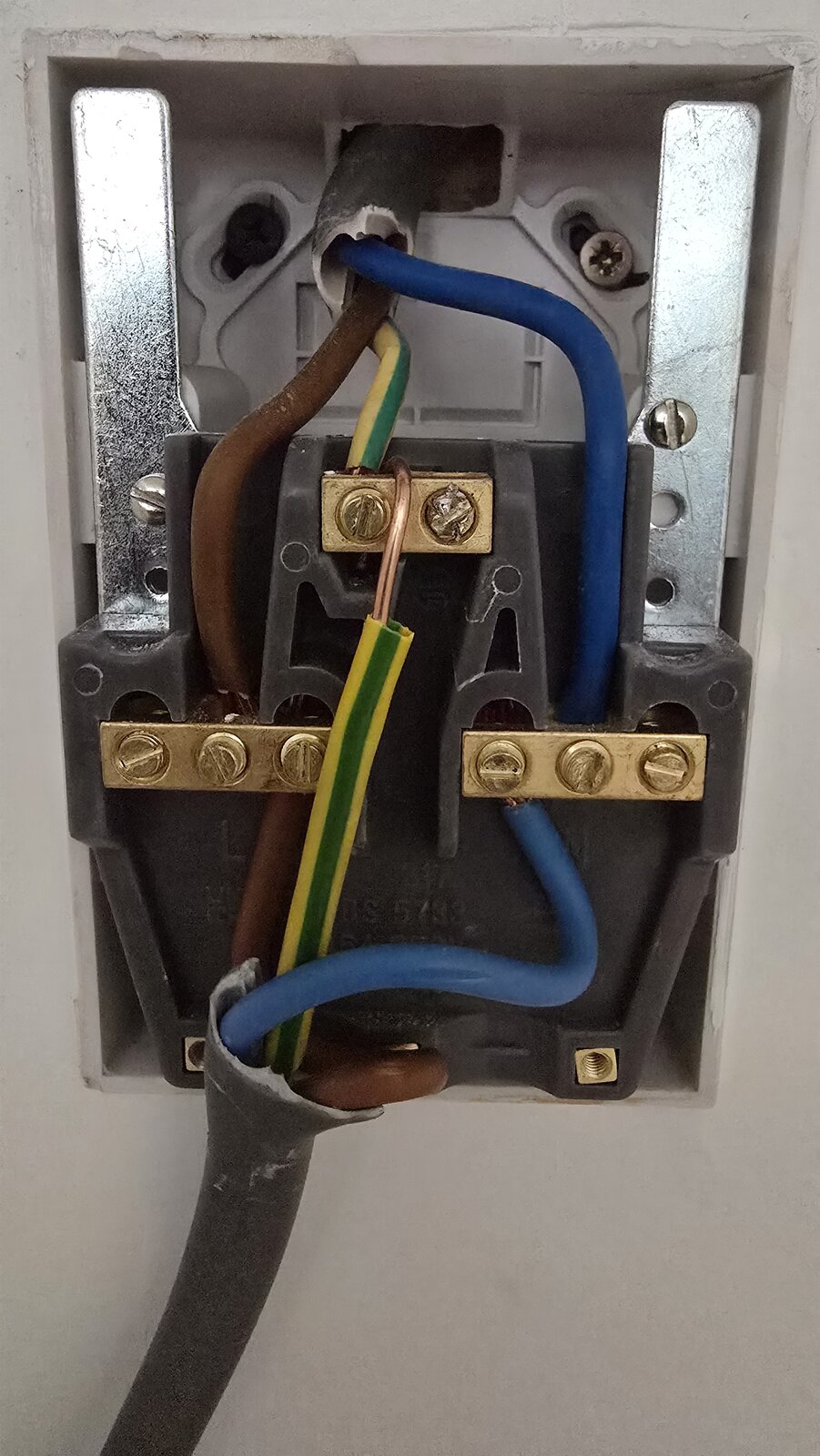

The cable on the right is the is the mains supply running into the connector....
The wiring on the left is the load into the oven.
The loose wiring is the disconnected hob..
I Was trying a process of elimination as i thought would try the oven and that tripped the rcd as soon as i lifted the lever on the 32amp mcb..
I then changwd the wiring in the connection by removing the oven wiring and replaced it with the hob you could see loose originally
That did not trip the rcd...
So we have a working hob....

These are the photos from behind the oven.
Top one is the 45amp connector it seems that the middle connection for the earth are wired into the same screw and the screw to right will not turn as i have tried it....
The feed runs from the other 45amp connection from the other 45amp connector the rop of rhe one behind the oven.

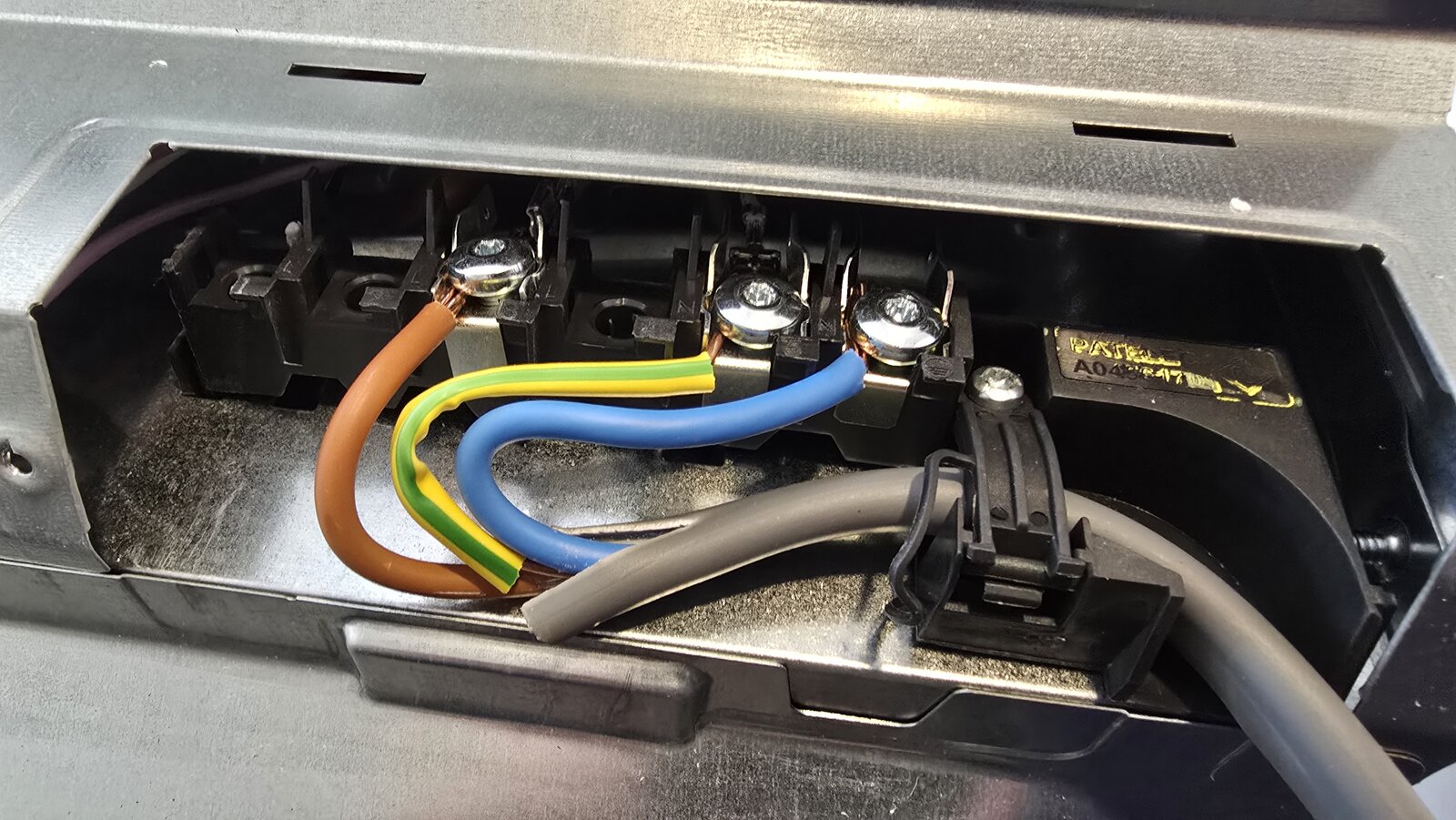

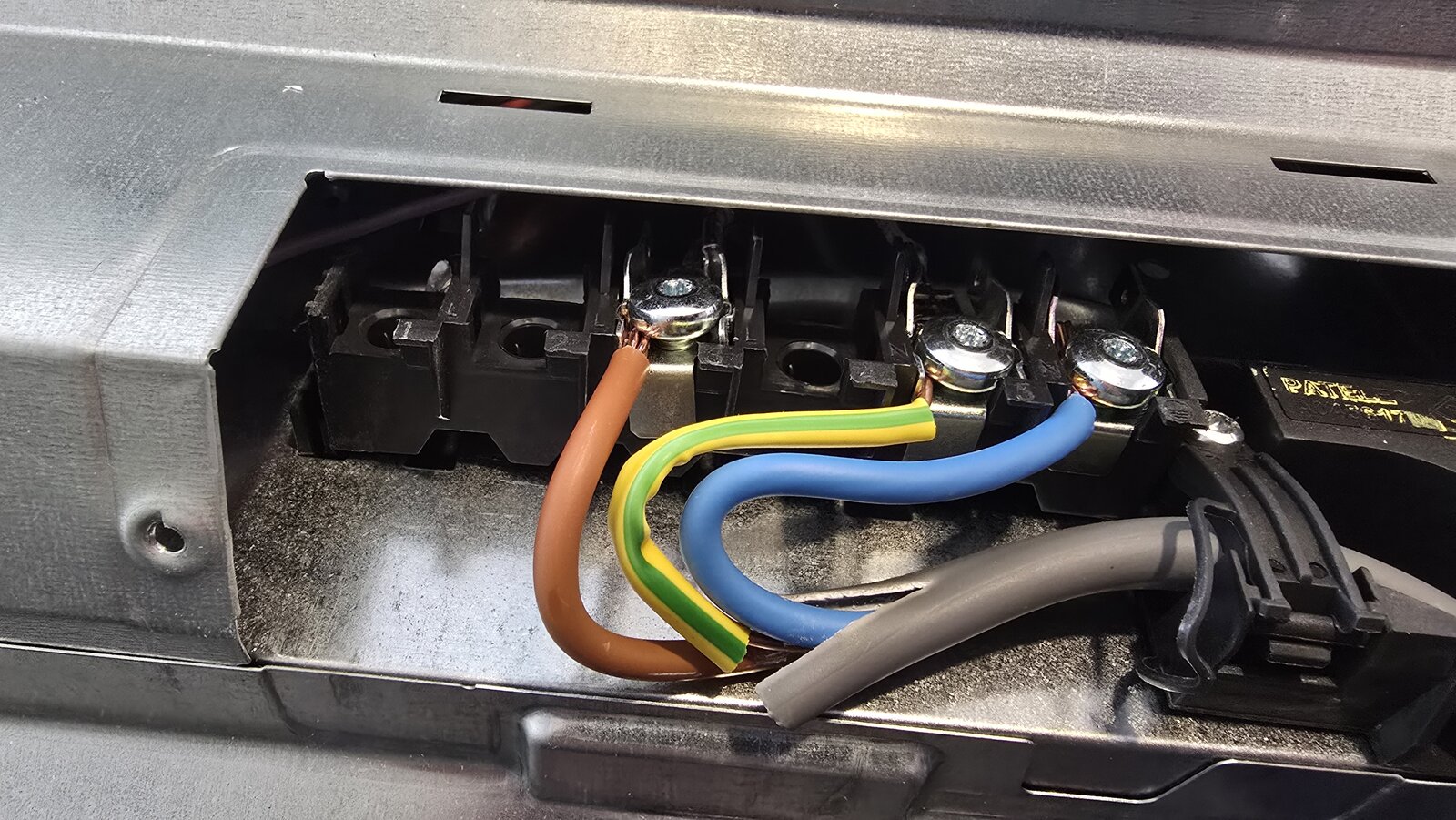

As we have said throughout this post, we are interested in the way the cable is connected into the oven - your image shows the the Green/Yellow earth wire connected to an N terminal and the Blue neutral wire connected to the earth terminal.
Thank you for spotting that...
Very gratefull indeed.
Also thanks to everybodies input aswell and all the advice..
